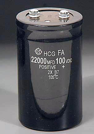

This is what I might use for the GFA555, $15 from apexjr.com
http://www.apexjr.com/images/CAP22KMFD.JPG
'Peak' or 'Surge' ratings on caps are only for choke input filters and either 8.3mS/10mS (60hz/50hz) half cycle.
I have a pile of real GFA555 caps, they are 15,000µF at 100V, 2-1/2" dia.
80V caps may work for a while, it's better to have a bit more margin.

Yeah, every 10% a capacitor is derated for any given supply
voltage will double its life .😎 Commercial (Fisher,JVC,etc.)
will use 63v cap for 58VDC, Ive seen them "bleed" after 4-5
years... 🙁
I use 100v for ALL my DIY amps 60-70VDC and all my repairs.
