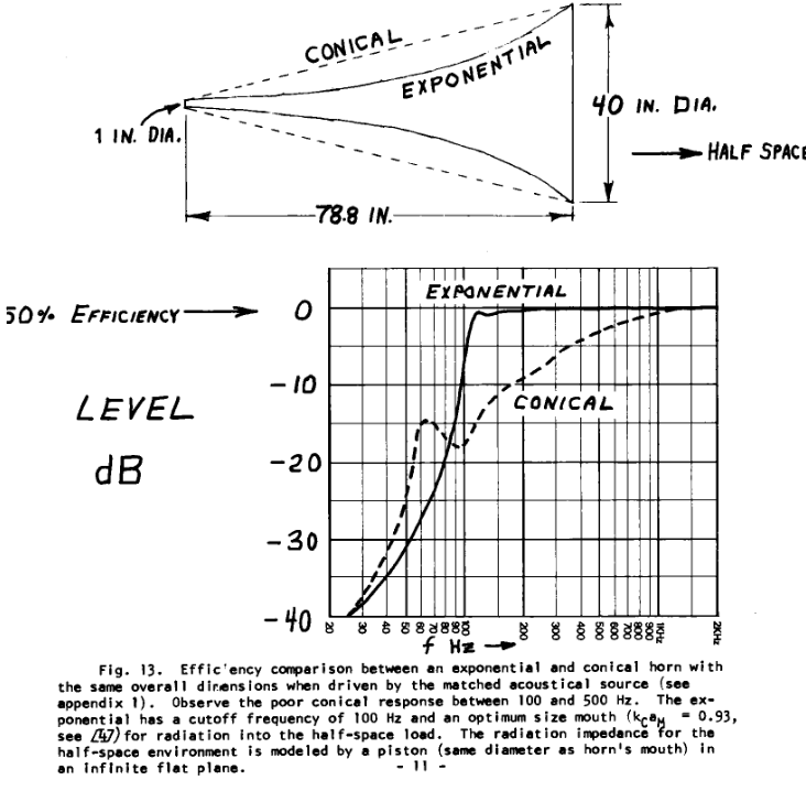

1) The horn driver is a high impedance source, coupled through the horn to a low impedance air "load". The driver/horn output will drop rapidly below Fc, the frequency the horn starts to "unload".
2) Crossover should generally be above Fc, the horn's -3dB cutoff frequency. The steeper the crossover, the closer to Fc the HF driver can be used without the diaphragm excursion being enough to contact the phase plug, which sounds terrible, and may quickly ruin the diaphragm even with relatively little power used.
3) Directivity is independent of loading, a simple pipe provides good LF loading, but lousy polar response.
4)Unfortunately, without measuring the specific combination, hard to make well informed decisions.
Plane wave tube response of drivers will give an idea of the low frequency response possibilities, the Axi2050 could probably be used down to 120 Hz on an exponential horn like in Don Keele's picture below.
Note the difference in Fc between the conical and exponential expansions.
