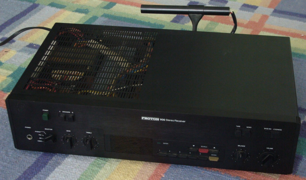

I have a Proton 930 whose amp works (the RCA jacks labeled "MAIN" bypass the preamp and work fine) but whose preamp/control stage (switching between inputs, AM/FM, tone and volume controls etc) won't pass or create any sound but for an occasional buzz or crackle as I fiddle with buttons and rheostats. I can tune and save FM and AM stations, so the preamp stage does at least have power.
Is anyone willing to share the schematics/repair manual with me?
I found the schematics to the Proton D940 in another thread here and will try to use those if I need to.
Also, can anyone familiar with Proton or NAD amps tell me where I might begin in troubleshooting this?

obviously your fault lays in the pre .. since i have no sch. i can only guess that fault lays in the secondary psu that works for the aux circuits of your amp
check this and also take a look at this http://www.diyaudio.com/forums/solid-state/136261-vintage-amplifier-repair-upgrade-manual.html.... its made for amps ... but procedure is more or less the same for pre amps

i would begin to clean all contacts (switches,fuses,potentiometer......),perhaps with a contact cleaner (spray).

I disassembled the amp and saw that the regulators are fine, and used a scope to trace the audio signal all the way through the end of the pre-amp stage and past the FM muting circuit. I was stumped! Are both of the traces on the board that take the pre-amp signal into the amp severed? Oh, there ARE no such traces on the board! An older friend of mine told me that I need to use external jumpers to connect the pre-amp out and main in. Hah!! BLAH!!!
At least now that I've got it apart I can replace filter capacitors in its tuner that I assume are responsible for a pretty bad hum.
