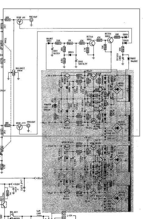

After some restyling (silver mica capacitors instead of ceramic, bipolar decoupling capacitor in the signal path, better resistors etc.) I'd like to change the mute circuit: it uses a fet in series with the signal used as an electronic switch... probably the worst solution.
I haven't enough electronic skill to realize it, but the idea should be to mantain all the original circuitation, and use the fet to drive a two-way relay. Probably the fet can't drive the relay directly, so I'd need someone's help to realize a simple interface to drive an adeguate transistor (e.g. the bd 13* series).
I tested that the fet is normally off, with a -15,6 v (referred to the gruond) applied to the gate; after 5-6-seconds the fet turns on, and the voltage at the gate goes to zero.
in attachement you'll find the schematics of the mute circuit, a big thank to all that will give me an help, and a great salute to all.

Ok... maybe was a too dull question, so I goes by myself, found a circuit at http://www.rason.org/Projects/transwit/transwit.htm and applied the circuit in figure 3 changing the 2N3906 with a BD136 and using the existing circuitation with the jfet used as electronic switch between R1 and ground.
I have taken the +V from the power line (the one that drive the output stage, not from the line supply) and putted an 820 ohm resistor between the +V and the +12V in figure 3.
Obviously I used a higher voltage relay (a 24v DC one), in this condition I measured about 20V between the coil terminals. This give me a total current consumption of about 40-45 mA, that I believe is low enough, considering that it came from the end stage power supply, the strongest one. I think that with a correct realy the resistor can be omitted and the consumption can be lowered as well, but this is what I had in my hands, so...

hi. after many years, i've decided a restyling for my 520. i have a question. how much ceramic cap i should to replace? in the schematic there a lot of this .
Ceramic caps can generally be left alone unless someone was foolish enough to use one directly in the audio path (coupling cap / feedback, >680 pF or so).
