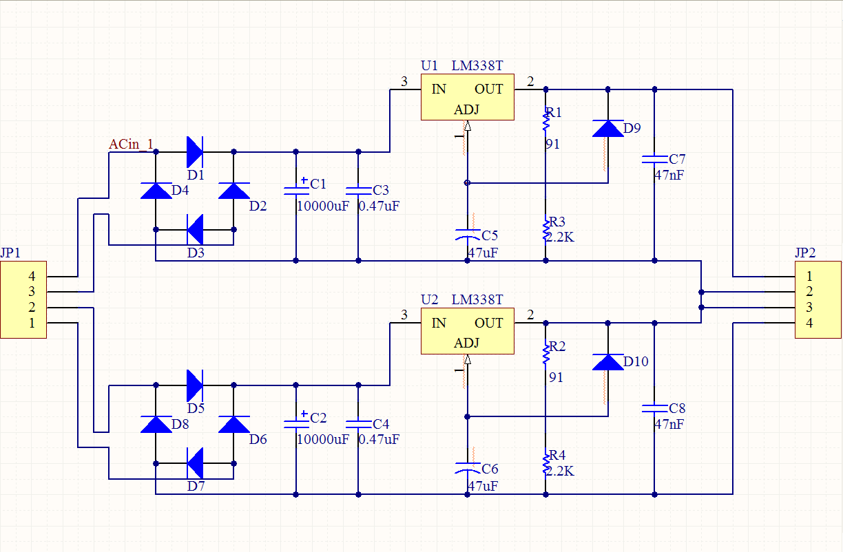

I am making a regulated PSU (carlosfm's PSU) PCB in protel, however when I place the LM338T it always complains that the ADJ pin has no driving source.
What does that mean? And how do I fix it?
Here is the schematic.

When you port the schemtic into the PCB does the connection to R1,R3 exist?
If not, delete all the connections and draw them again.
There may also be an issue with the pin type defined in the library - its probably defined as an input, therefore the ERC checker expects to see a source of current connected to this pin.
BTW, thats a particularly nasty way to show four wires joined together - you should do it like this to avoid this sort of ambiguity.
