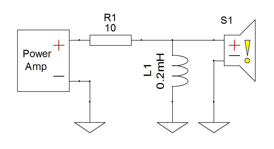

adason, perhaps you're not familiar with the shunt crossover. Or the approach to taking control of current rather than Voltage?
I am here to learn. Would you trust that tweeter is protected if classAB amp would fail and 59 volts would be dumped on what you posted?
Yes, most of the current would go through the coil in parallel, but still, it is fully protected?
If the coil is 0.3 ohm, and tweeter is 4 ohm, hmmm, you get almost one tenth of the current still going through the tweeter.

I would not trust your suggestion, but its ok, as long as you trust it. I always run tweeters with caps.

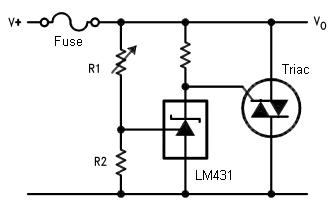

Crowbar protection has been around longer than I have. MalleMike observed it correctly because he included a fuse. I'm not taking sides here, but this is a very basic electronics techique.I would not trust your suggestion, but its ok, as long as you trust it. I always run tweeters with caps.

Crowbar protection is not failsafe on one side, it can be triggered erroneously under certain circumstances and it is very destructive if that happens.mMechanical relays are far too slow, triacs can be triggered by fast rising voltage etc. etc. Time constants have to be short to effectively protect a tweeter and long to avoid false triggering . I do not like these compromises at all.

The triacs would not be the triggering device in the case of a speaker.MalleMike said:Crowbar protection
