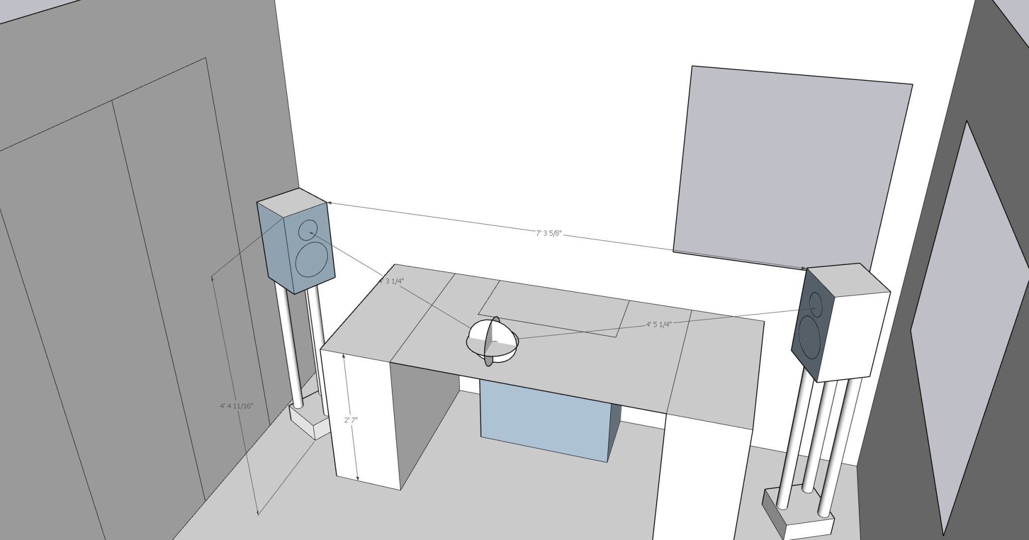

I guess I’m a bit lost now…….you’re building a set of 2 ways for desktop use?……or are you building a set of two ways adaptable to multiple environments hoping to support them with stands where necessary?
Ah yes, explaining further is probably helpful. Picture is worth a thousand words:I guess I’m a bit lost now…….you’re building a set of 2 ways for desktop use?……or are you building a set of two ways adaptable to multiple environments hoping to support them with stands where necessary?
This was my current plan with the box volume I'd calculated.
What happens below the enclosure doesn’t matter if the dimensions are nearly the same, so a bookshelf speaker on an open stand would be no different than if the stand were a closed box.
If those dimensions end up being too much box, are you suggesting closing off the area I don't need and stuffing it? That makes sense given the fact I don't require a down firing port
Here is what my reply was saying, assuming I'd keep the same VAB of these, but just close off the 'stand' into looking like a floor standing:
They'd be stationary in this position.
Oh boy…….you’ve got some challenges here with corner loading anything like that and then cross firing them?……you‘re listening experience is going to be akin to a giant pair of headphones. I’ve done this May years ago……and i would strongly suggest you abandon the mission. Stereo masters are NOT engineered to work well in that use case at all…..the cross phase cancellations at the LP (inside your head) become extremely fatiguing after 20 minutes as your brain is working overtime to make sense of it all.
DIY is your friend here and the ultimate solution when designing to fit a specific environment/use case. In your environment, a forward firing system is all I would ever consider. Bass will take care of itself quite easily on the cheap here…..tuck a small sealed subwoofer in each corner to the left and right of the desk and you’re done. Now all you need to handle is 100hz and up…..you don’t need much space to do that effectively in the nearfield.
I can tell you as a recording engineer, to date I have found no system better for a small nearfield monitoring solution

Common wisdom tells us that for a perception of the stereo image the base of the listening triangle (distance between speakers) should be more or less equal to that between speaker and listener.
Yeah it is a pretty terrible environment, but I'm hoping to work with what I've got and why I'm leaning into the DIY of it.
Here's a mock up of the entire space:

Alternatively, would suspending from the ceiling and decreasing the distance between each speaker offer any alternatives? I imagine there's a whole host of other considerations at that point which are introduced.
To give you some inspiration this design offers the response published mounted on-wall. So no need to pull them out and have the inevitable comb filter cancellations from the reflected wave from the front wall. These happen in the low midrange region. Which is quite crucial when recording and mixing. Just a thought…
