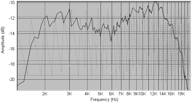

Thanks for the reply. Is there any advantage to using a ribbon tweeter?
I have a pair of Maggie 1.6's. They roll off at around 20K and run the full length of the panel---I think.
I wonder it such a short ribbon will keep up with the rest of the speaker in a HT setting.
The AC ribbons sound amazing. The small ones will reach 111dB at 30W/1m, no problems keeping up with HT dynamics. But you have to like the kind of forward, sizzly sound that a ribbon produces.
Ribbons are usually touted for their extremely fast decay times, low moving mass, and resolving power. They have wide horizontal dispersion and very tight vertical dispersion, which can be assets or liabilities depending on the requirements.

You can describe it however you like, but ribbons definitely have "something" (air, sizzle, call it what you will) that typical dynamic tweeters usually lack. Some people consider this harsh, others revealing, everyone will make their mind up for themselves.
It's like the characteristic "raspy" sound that the Proac 2.5s have...some people hate it and spend countless hours "fixing" it. Personally, I think it is part of the charm of this loudspeaker. (Note: I agree that the bump in FR needs to be eliminated, that is a separate issue)
My experience with the AC 2si is that they don't have the typical treble "shimmer" sound that I associate with planars. Instead they are very smooth and natural sounding , but with detail.
It might depend on the crossover. They are wonderful tweeters- I think we can all agree on that? Highly recommended
tiroth said:You can describe it however you like, but ribbons definitely have "something" (air, sizzle, call it what you will) that typical dynamic tweeters usually lack. Some people consider this harsh, others revealing, everyone will make their mind up for themselves.
Well, we now have to inquire as to your personal listening experiences, since your description of the characteristic of *ribbons* does not correlate to mine.
Having said that, ribbons such as the Apogee line imho did have a specific characteristic to their sound, but this has little to do with being a characteristic of *all* ribbons. It is/was due to some very specific design "issues."
If anything the sound from high quality ribbons is not raspy, it's incredibly sweet and "light." Perhaps too polite.
So, it is my thought that what you've heard is the ribbon accurately reproducing various sorts of "hash" and distortions present in the gear that is feeding the ribbon.
As far as the Proac line, the last time I heard them they did not have ribbon tweeters in their boxes, so I can't hazard a guess as to what the issue may be with that particular manufacturers speakers...
Lets please discriminate between "pure ribbons" and "planar" or "leaf ribbons". While they can share the best qualities of a "ribbon" they each have some unique design tradeoffs and resulting issues depending upon the specifics of the implementation.
Let me add that the absolutely cleanest ribbon I have ever heard, and for that matter the cleanest tweeter I have ever heard - bar none - was a particular high output "leaf ribbon." This particular unit, modified slightly from stock had vanishingly low levels of distortion when played at normal listening levels, on par with some power amplifiers! What this meant is that almost a full order of magnitude *less* distortion than usual was not part of the reproduction. Which made it amazingly easy to discern facets of the signal that were formerly less than clear, without that effect being due to a frequency response variation or peak (as is frequently the case when you suddenly "hear things that were never there before."
This ribbon added nothing, and made practically no sound of its own - certainly compared to *any* dome tweeter, and probably any other tweeter regardless of price or type.
So, I'd suggest that you re-investigate the *causal* factors that brought you to your conclusions about ribbon tweeters in general. Specific ribbon designs can be flawed for certain. But not all, and it's not inherent to the technology itself.
BTW, there are issues relating to the application and effectiveness of a ribbon when *integrated* into a system, but that's another topic - I point it out only to indicate that ribbons are not perfect and are not a panacea, and will not even be a good match in some situations...
