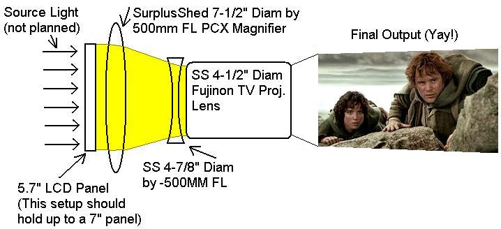

Shibby,
I'm considering making a setup as is in the following image (apologies that I've attached this image a dozen times in different threads, but it illustrates many things I'm dealing with currently).
Instead of using a -500mm concave lens, could I get a -300mm concave lens and have that give me an extra magnification for my short-dorm room problem?
Thanks for your optics help! I'm fine with the soldering, but the optics makes me think back to freshman physics and that gives me a headache. 🙂
Keep the imagination wheels turning!
--Clint

I think you might be a little optimistic on the optics (pun not intended 😉 )
I think the odd's might be stacked in a pile against you as there are a TON of variables in this picture...soo many elements, all needing to be in "spot on alignment".
I put my 12 inch laptop panel on the OHP with no projection head mounted...LCD screen to ceiling distance about 7 ft then held the one really nice lens from a Delta tac3 CRT lens pack at about 20 inchs from the LCD. VIOLA an absolutely gorgeous image on my ceiling about 5 feet diagonal. I could stretch it to MUCH bigger if I tipped the OHP on it's side and got more throw.
Right now I'm using the junk OHP as is with it's shody optics and at 13 feet from the screen the image has to be shrunk to keep it small enough to fit the 14X9 feet I have available...and it still looks awesome. I keep it down to a 10ft diagonal so ya dont gotta crank yer neck around to see the whole scene 😉
zardoz

Gyah. I'm getting so frustrated with optics and lenses and panels and fresnels and CRAP!
What you said only confirms what I've experimented with with my projection lens, laptop, and fresnel. I don't know jack diddly as much as I thought I did.
I've put a month of good research time into trying to figure out how to make my own compact projector. I think I'm going to relist my 5.6" LCD on e-bay and go the OHP route. I'm ready to forget the whole engineering DIY method and take the cop-out iwanttowatchbigmoviesinmydormroomcheaplyandquickly method.
A very frustrated engineering student,
--Clint

Don't get discouraged..
I think the basis of your plan looks really good, but I dont know too much on the optics end either.
I just know that the more elements in the equation, the more chances for error. The fuji lens is a really attractive piece of gear and if you can make it work I'm betting it would do an awesome job. I just think holding the intermediate elements might be a nightmare, and a lot of work (not that the effort isn't worth it, just might take longer to achieve primo resluts than you want to wait) Why not use the LCD you have? It should work on an OHP shouldn't it? I'm half tempted to use my junk OHP (as the light source) on it's side with the precise lens from the CRT pack (only one decent lens in the whole assembly). All in a custom box to hold the nice len's and the PC to run it all.
zardoz

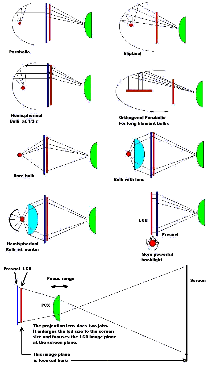

Hey guys I see a few of you are getting concerned about your projection optics.
Its a piece of cake.
In most cases the light leaving your fresnel/LCD combination should be converging to a point X distance away. At that point maybe an inch or two before it is the right location for your projection lens and the lens does not have to be anything fancy.
One of the reasons guys use projection lenses is because it says "projection lens" on it. But that does not automatically mean it will be any good for your application. Some of these are really good lenses with zoom and excellent glass inside but if you don't know how to use one, it is a waste of time. A single lens will do just as well and is a lot less hassle.
As you know, if you have a flat piece of glass the light comes out one side at the same angle it went in at. There is no magnification with regular flat glass. You could take the glass away and the scene looks the same.
Lenses are flat glass that has been bent to a particular curvature and one side is often flat or curved more than the other side.
Lenses like that have gain or magnification.
You send a beam of light in at 10 degrees and it may come out the other side at 20 degrees, or 40 degrees. Or more.
This makes lenses very useful.
In most DIY projector applications the light coming from the fresnel/LCD combination is converging slowly to a point. It hits the projection lens and there is where you can controll what happens next.
If you use a lens with low magnification, the outgoing beam is not spread out very much so you use that type of lens if your projector is right at the back of your lounge and you need a long throw lens.
On the other hand, your projector might be in the middle of your room so you need a lens with more magnification to make the outgoing beam spread wider in a shorter distance.
A projection lens is the least of your worries. The real hard core DIY work is done in getting as much of the light as possible to go through your fresnel/LCD combo without cooking your LCD.
Check out Gunnawan. (Could be Gunawan) He posted a lot of very useful info about different types of lens and throw distances. He has a spreadsheet where you can dial in distances and the spreadsheet tells you what projection lens you need.
There is one important thing about projection lenses. The bigger the better. Big ones gather more light than small ones. The one in my 3M 1705 OHP is 3.5 inches in diameter and works really well
Surplus shed has lots of lenses. Surplus+shed on google will find it.
Or look in the links in the Wiki. There are lots of optics links.
