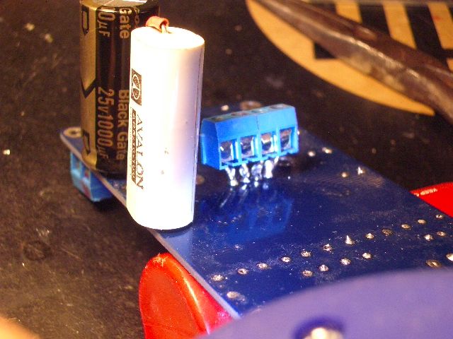

Since I have done Tripath based stuff before, I will go straight to the good stuff, here are the planned mods:
-- Replace input caps with good quality film caps. Judging from the auction photo, the stock caps are electrolytic's.
-- replace bias-cap (the 0.1uf that goes to the ground, yes I know there must be one, it is on the TK2050 spec sheet) with good quality film cap.
-- Replace output inductors with toroidal air coils.
-- Replace output filter caps with good quality polyprop caps.
-- Do a linearly regulated 22V power supply to power the board. ( 20V so it is safe to drive both 4 ohm and 8 ohm speakers. ). I will use 4x 7812, float the reference/ground pin to 8V using a 4-LED string, that should provide the 20V/4A I need.
-- Maybe add a volume control, if so it will be a shunt type with an Alps pot and AudioNote resistors.

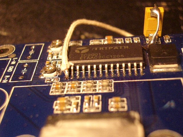

update:
hooked up the board and it works, sound is clean without distortion.
The control chip has Tripath logo; The output stage chip is marked DDX.
The overall board gain is 30X. Gain resistors are easy to identify, at a convenient location (if I end up wanting to chang them).
Bias cap easily identifiable as well.

the tip of screw driver is pointing to the gain resistor groups for the analog stage(two groups, each has one 20K (203) and one 47K (47k)) . This will give 47k/20k=2.3x gain for the analog stage.
The digital stage gain is the default 15x, I am not gonna change that.
To reduce gain, change the 47K to 20K (or parallel another resistor on top of the 47K).

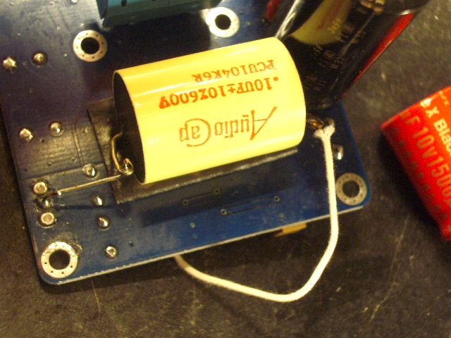

As for the bias-cap upgrade.... I took off the stock ceramic cap and soldered a wire to pin #1 of TC2000, and connected to a 0.1uf PCU. The other side the PCU is connected to the ground.
The main reason behind getting this board is that it is easy to work on, and fairly inexpensive. It will serve as test bed to test out different parts combinations. If it dies due to a wiring mistake or whatever, it is easy to replace the whole board. (verses if I use my Amp4 for testing and something happens, I'd have to replace IC's and it is not very fun to pull the surface mount chips.) .
Why did you change this? what is the function of bias cap?? (perhaps basic questions... sorry a am newbie)
I can almost smell the extra inductance. Does it sound better, also to others (you know, placebo effect)?

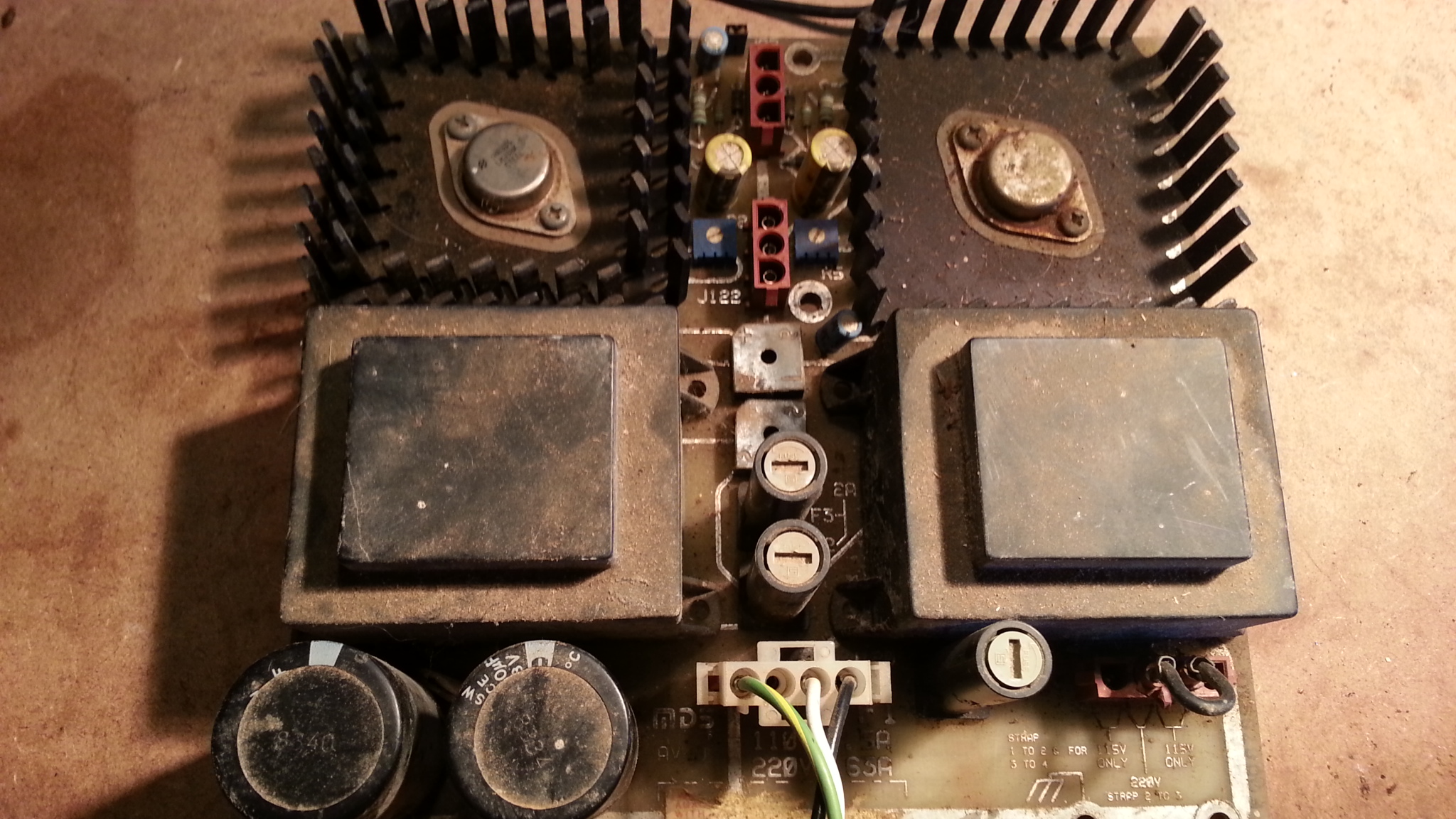

TK2050 PSU
I hope I can use this thread for a question.
I ordered the same TK2050 on ebay.
Attached is a image of an old classic early (80's?) MDS computer regulated PSU that is set on twin 24v dc 2A output. I used the Power supply to test a JLH 10w project. Absolutely clear results but running near the 2A limits of the low, I think 120VA, transformers, getting hot.
When the TK2050 arrived (in its thin packed envelope!) I tested it with the PSU
the TK2050 amp blowed most of its smaller caps and one of the LM338K regulators. I was sure of polarity.
Should it work with this type of supply?
