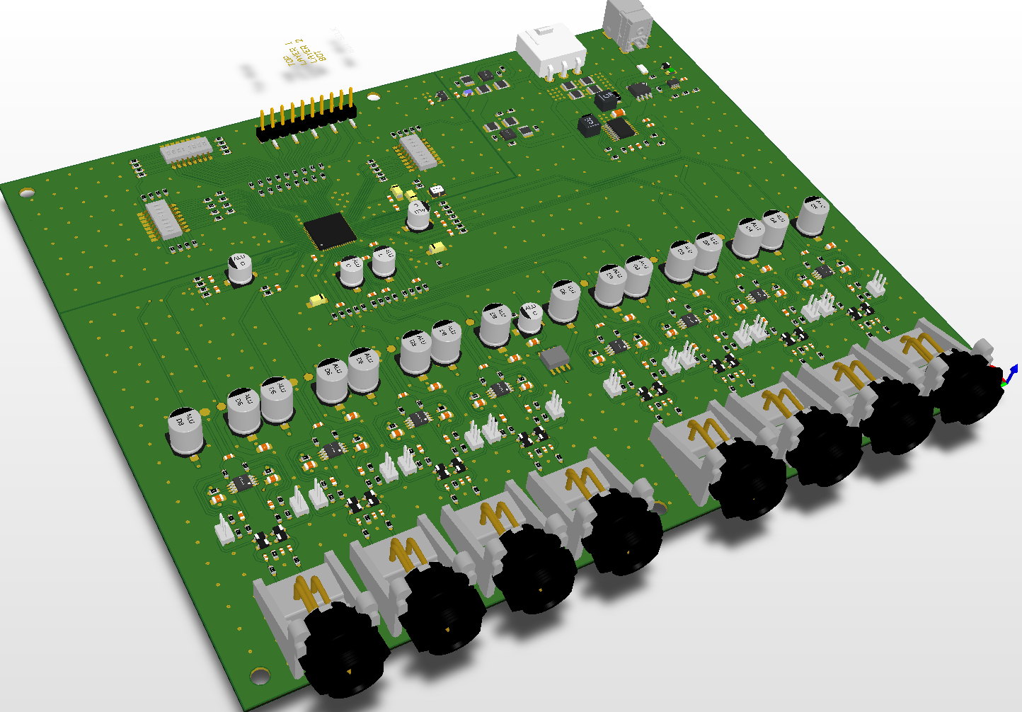

Hi all,
I've been working on a little 8ch ADC project ( 4 layer 170mm x 140 mm)
I've thrown together the following
AK5578 8ch ADC
8 x AG3MCCH Mini XLR connectors
8 x OPA1632D ( with gain jumpers )
8 x ESD& EMI filters
1 x buffer for OPA Vocm
ADP5070 DC-DC
LTC4365 power input protection
LTC3042 regulators
GXO-3306 24.576Mhz clock
Expose AKM settings on dip switches
+/12V output header

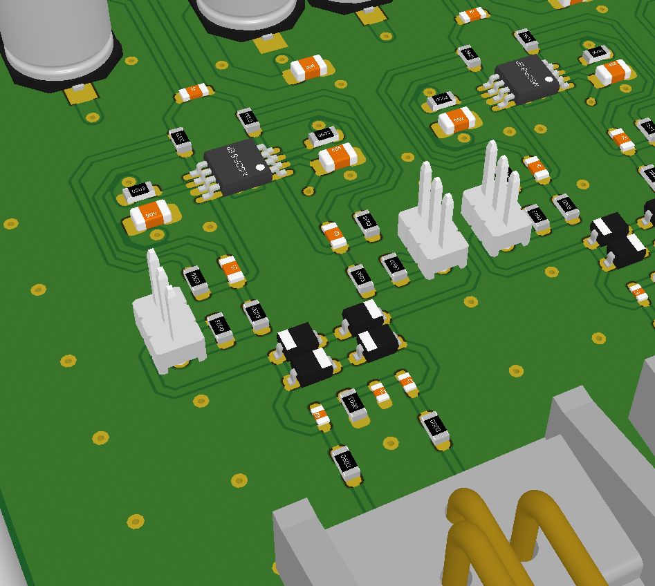

The layout shown is just to get the parts in place. I recently added the the gain jumpers per opamp side. Made a bit of a mess!
