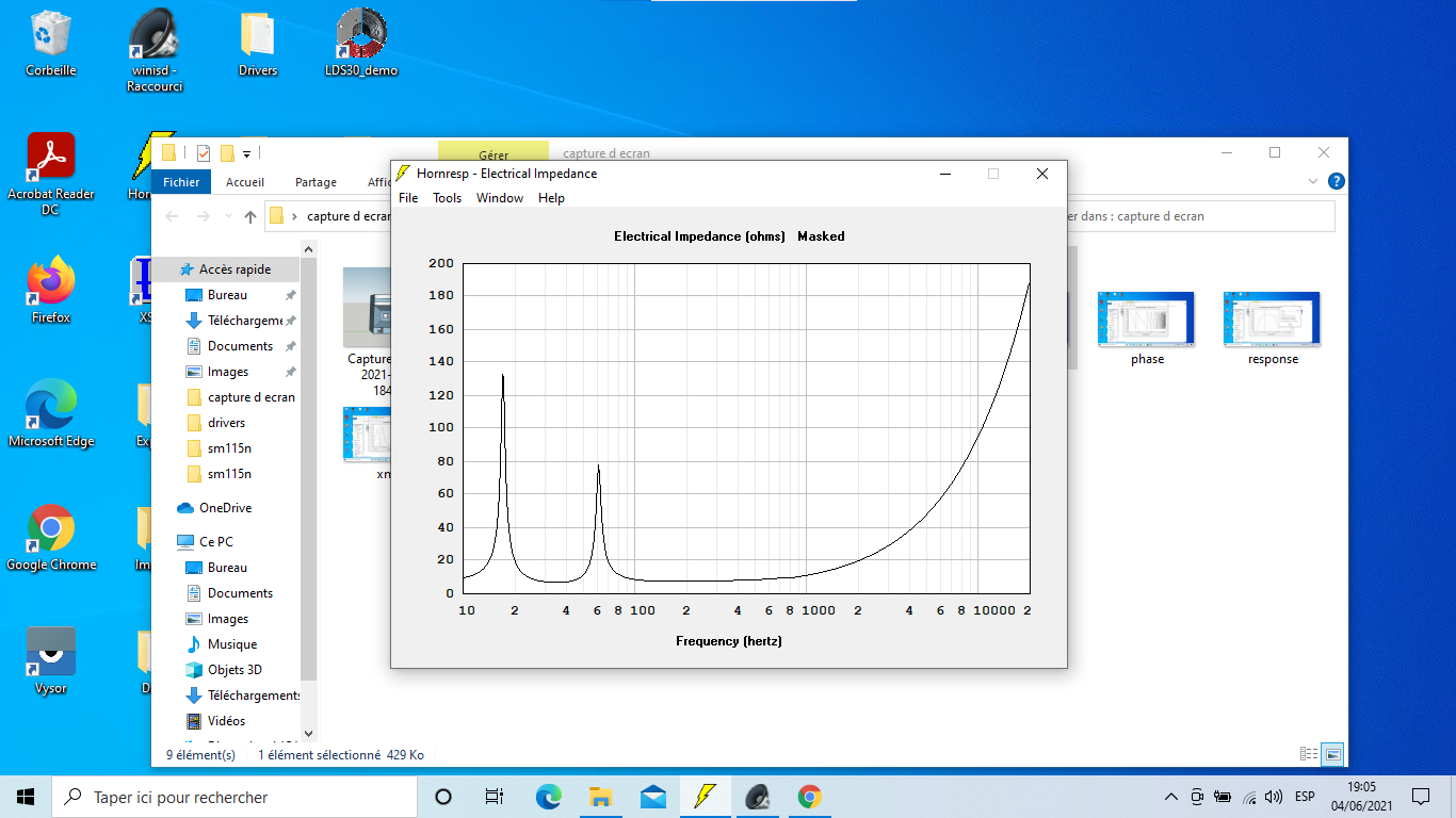

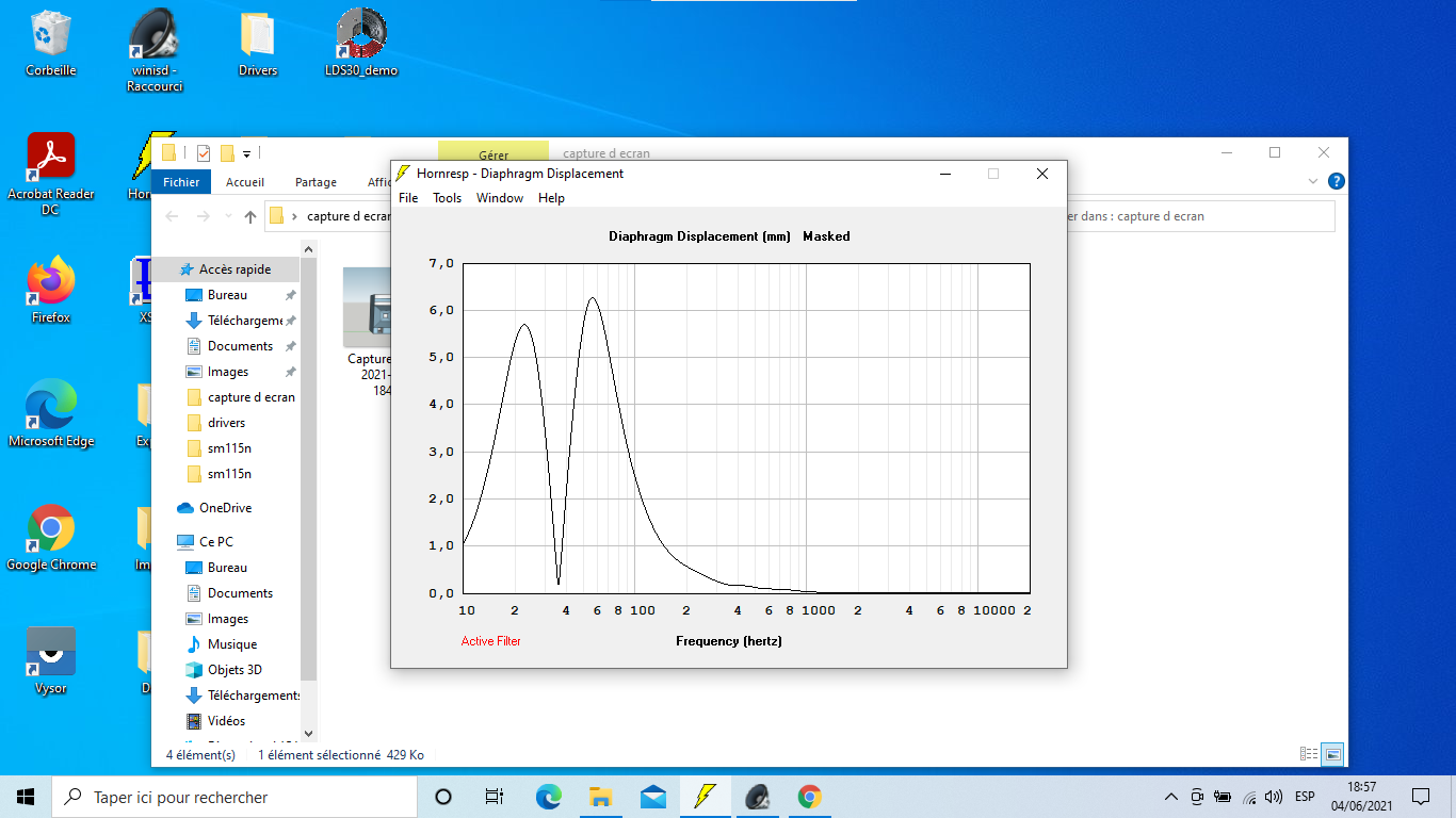

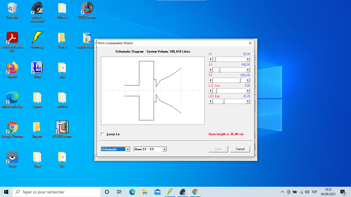

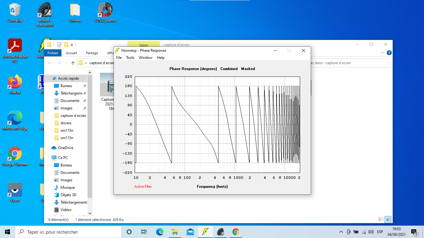

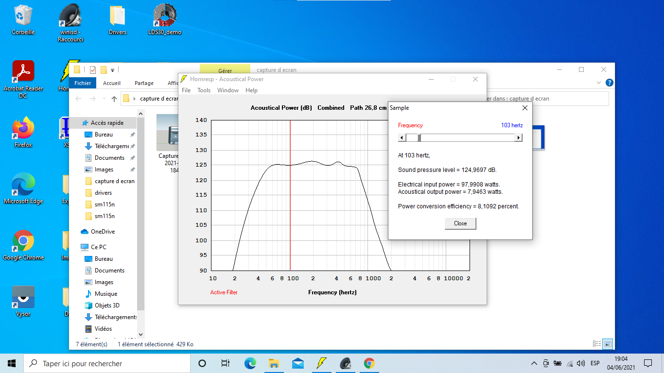

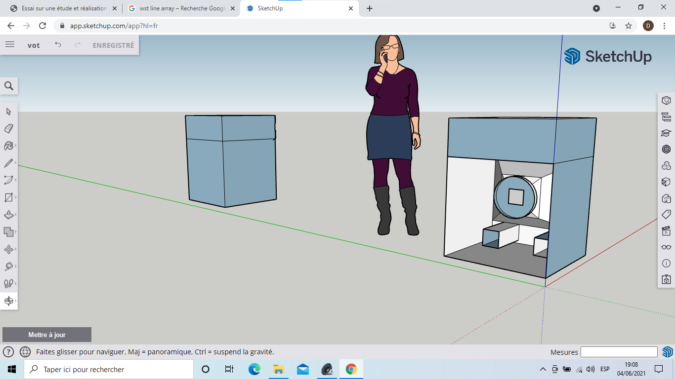

Hi everyone
This is my first post on this forum

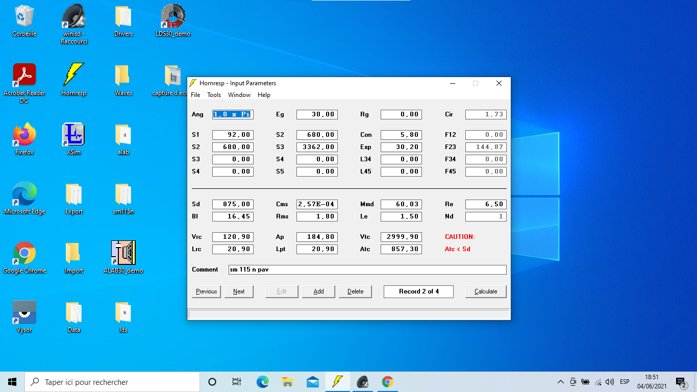

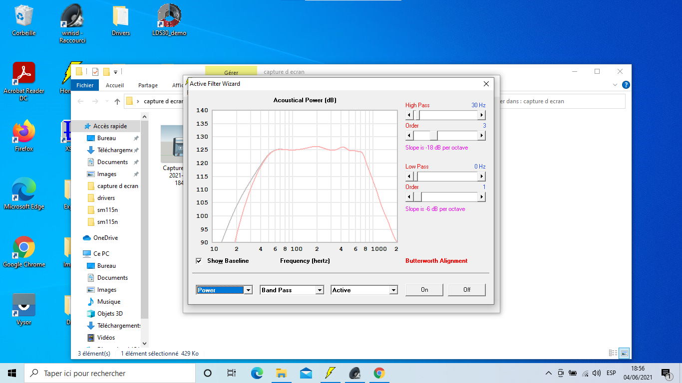

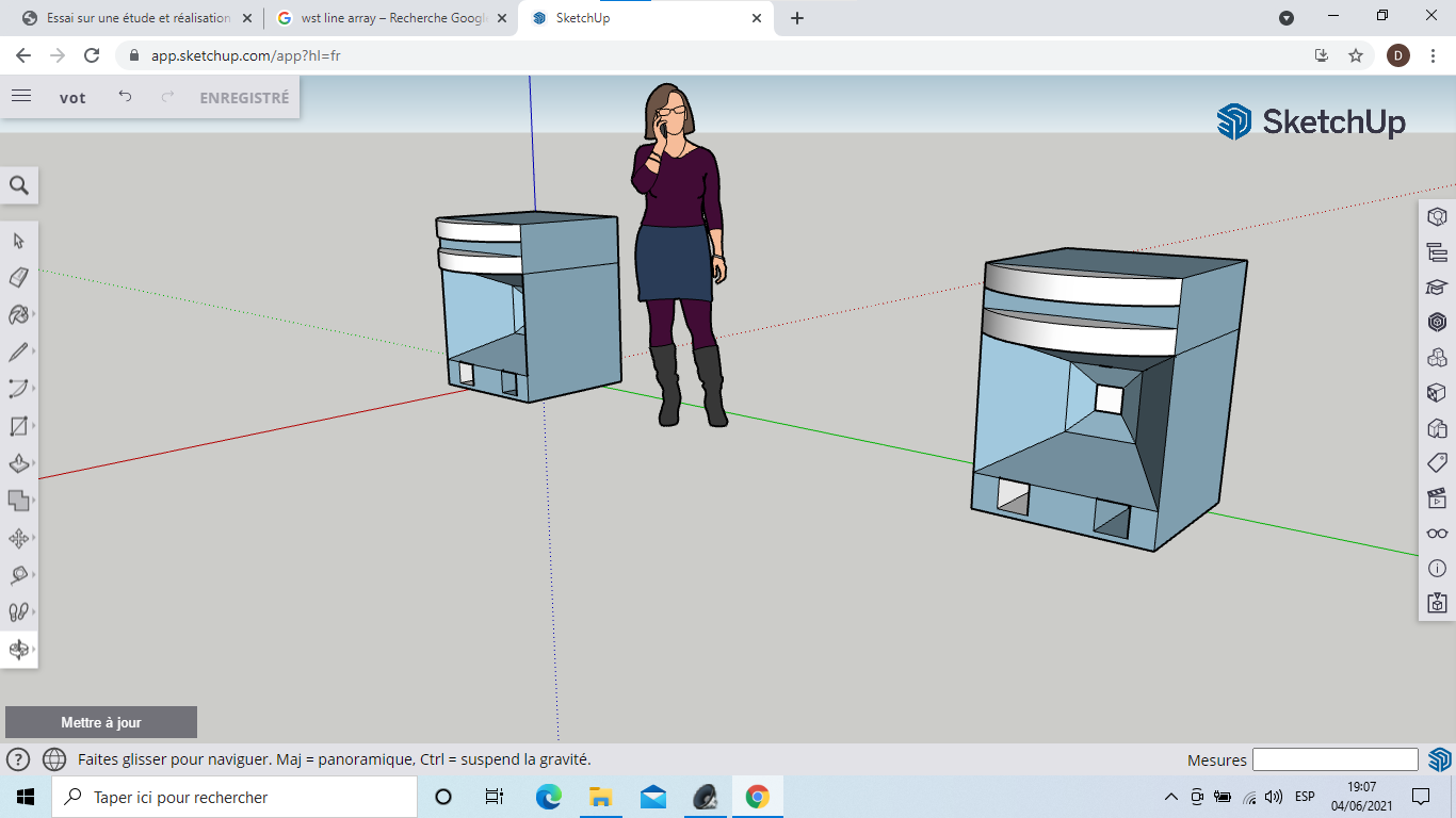

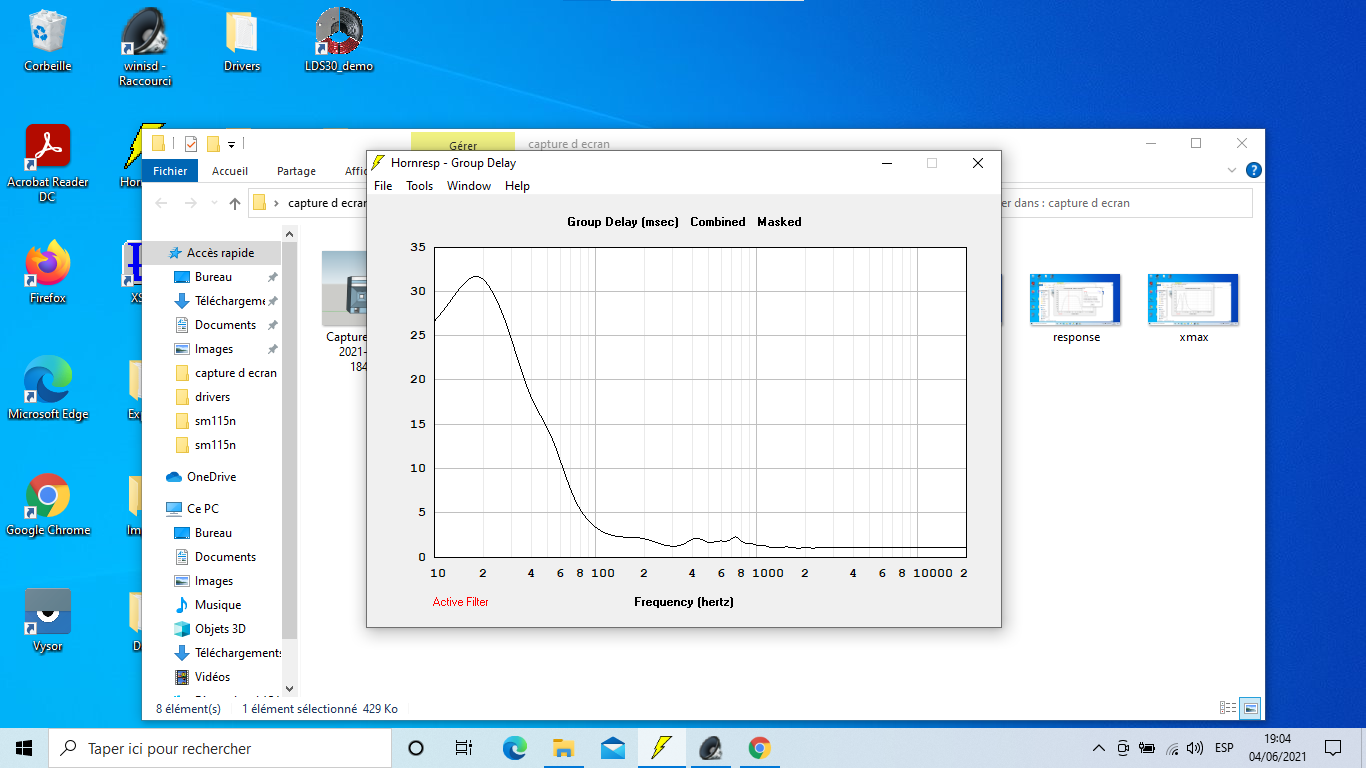

I have the speakers: beyma sm115/n and jbl 2445.
So i m looking to do something with that.
I will make my self a arai 290.
I choose the sm115/n for his price, go low and high, just need big volume in bass reflex: around 200 liter.
But and this is why i write my first post here, i m look how to simulate something like VOT, and it look good on hornresp.
So in image
Do you see something wrong ?
S1 92 is not to small ? from the simulation no but hornresp doesnt calcul air velocity first from port, second from the throat wich is smaller than the port...
What do you think about ?
SM115n
The distortion go up under 55 hz that why i m thinking about something like VOT

Greets!
Images don't open.
Which VOT? Altec used/abused this moniker to include everything from a basic reflex to various types of small, large horn loaded systems, though don't recall one that used dissimilar point source drivers in a cab other than some of the Japanese spec VOTs.
