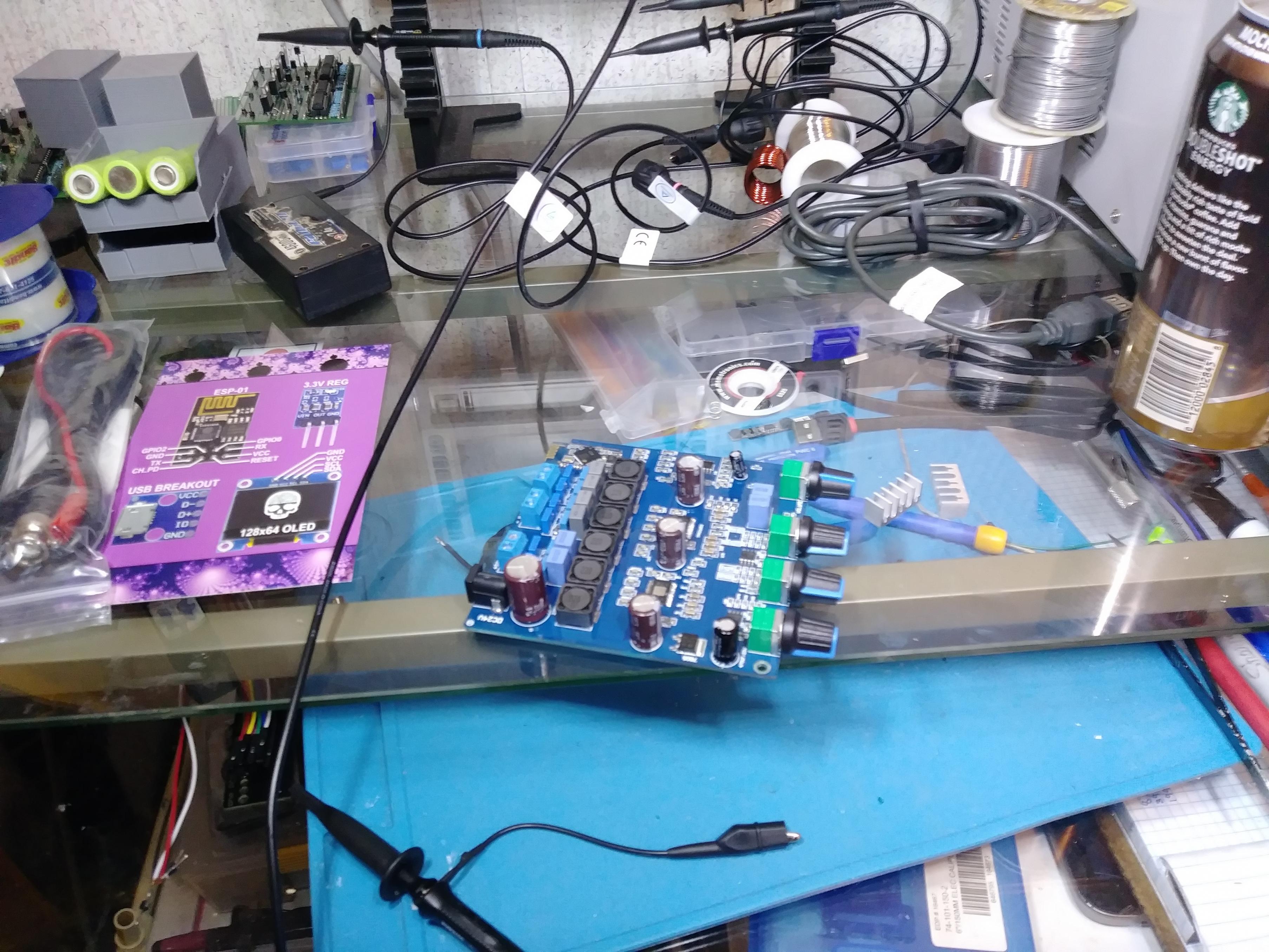

Here's the board I bought. I will also provide a Amazon link to what I bought. I am waiting for the slip in the mail to send it back. I am thinking of getting something different. Maybe without a bluetooth board attached . IDK. It has left a bad first impression.

I just tested the same board. Suffers from the ground loop hissing endemic to these all-in-one bluetooth/amplifier boards. To its credit - if you pause your bluetooth playback, it shuts off the amp a split second later to cut the hiss. The heatsinks are just glued on, so one of mine had fallen off. Otherwise the components are pretty good and the amp is very nice sounding - although there is no auxiliary input.
I was able to get it quite loud at 18v. It sounds silly - but check the volume of your bluetooth source. I was disappointed in the output until I noticed that the volume on my iPhone was at two bars. Once I turned the iPhone up, I had no problem making a lot of noise.
The controls provide good flexibility to tune to your speakers. If you don't mind the hiss, this is probably one of the best all-in-ones. There is only a mild beep with "on" and bluetooth connect - there is no loud voice about status, nor is there a super loud beep. I also didn't find any loud on/off popping, although I didn't try every combination.
I am going to ditch the all-in-one concept and go to a separate bluetooth module and amp. That way you can use an isolated power supply for the bluetooth and/or use isolating transformers for the bluetooth audio signal line to the amp and eliminate the ground loop hiss.

Ok. I did some measuring with my fluke while I am at work. In from the bluetooth module is .950 volts. Then i took a mesurment at the output with the speakers hooked up. Turned the volume to max. 2.975 is the max A/C voltage mesured. The speakers mesure 3.2 ohms from the neg to pos. I am running it on a better 19.8 volt 3 amp power supply. The speakers do not distort at all at full volume. And it isnt really that loud. So i am not sure what couks be wrong.
I presume you used a sine wave to measure RMS voltage with the fluke. If so, your only getting about 3:1 gain between the BT output and the amp chip output.
I wonder if some resistors in the op amp circuits are mis-populated reducing the BT signal level because the minimum gain the chip supports is 19 dB (9x gain) and most all TPA311X implementations are set to 26 dB gain (~20x gain). You could measure the voltage at the TPA3116 inputs to verify.
I did not use a sine wave. I didn't know that that was a standard practice . I am new at this . Is there a phone app I can get to input it to bluetooth? I will get a data sheet on the chip so I can check the voltage level at the chips. Also sending a sine wave through the bt will be somewhat annoying . What kind of resistor would be suitable to put in the speaker's place for testing.
