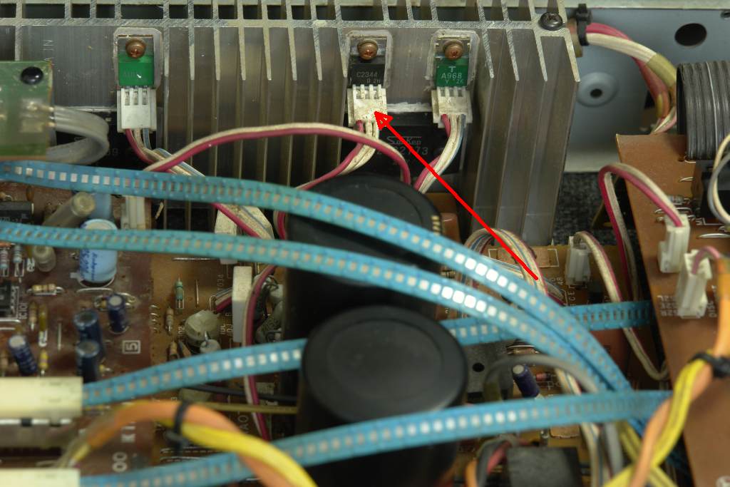

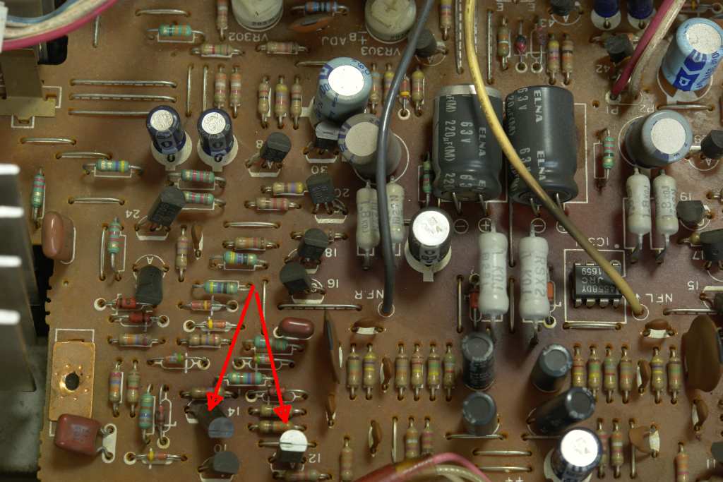

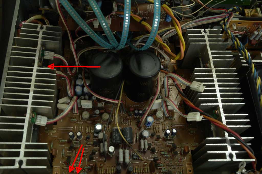

Hi!
Came, saw, fixed...😉
The main reason of the failure was sold solder through the tran showed on the picture. His neighbor was slightly collapsed too.
I guess that during production process the soldering wave was too lean, it soldered the part with too low tin alloy. During normal operation those trans became very hot, and poor soldering was overheated which resulted with crunchy solder junction. During shakes, vibrations, etc. the junction started to lose the tin what resulted in breaking the connection.
The second reason of failure was bad connection in the driver connected to a socket with the wires. After I touched this, the rely clicked and the amp started working.
I was lucky to repair it, I was thinking to make it ~1 month…😀
I hope this will help future repairers🙄
