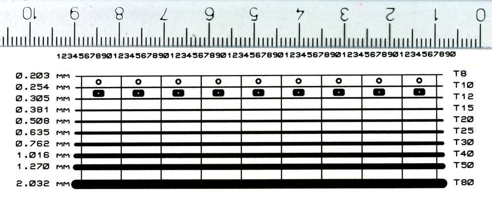

Hi safetyman,
we all make errors and correct them. In order to get better boards, find in the pic a sample containing tracks, numbers and pads. The number above are 1mm height. At the left and at the right of the tracks you see their width (left : mm, right : thou). I have put a ruler in order to let you appreciate the dimensions of the board (in cm).
This pic is difficult to get on the board. The zero may come pqartially or fully filled, the 9 and 0 may not be separate, the tracks may come not evenly etched (variable width), the tiny hole in pads may not appear ... You have so a way to get errors to correct without throwing away precious $ in etching full boards...
I use always this pic and calibeate my process in order to correct the exposition time when I get new boards. When it is calibrated ok, it is ok for all the otyher boards I have got.
Don't overlook the 3 last sentences of acenovelty's reply : they are truth and the way to go. My first boards were awfull too. Yours is much better.

Thank you, thank you for the guidance.
rephil, thanks though I do not understand what I am supposed to do with the pic? 😀 Am I supposed to do a board with that and get the method right till everything shows up and that means that would be the way to go?
Anyway, I did another board exposing it to the same source for 95 secs this time round instead of the 120 secs. After etching, the result us much better, except that some of the "pads" (I think that's what they are called) on the finer tracks were etched off but generally, no holes this time. Another problem that showed up though, is that some of the tracks seem to be scratched. Is this normal? Is there anything that I can do to fix this?

Hi safetyman,
the pic has been drawn using a CAD program (Proteus from Labcenter in UK). The pic has been printed on a transparency suitable to my HP deskjet 5652 (here I use Tartan 707 transparencies). It is printed twice on the same transparency in order to get black 'more black than black'
You should draw such a pic in order to adjust your process.😉
I cut a board and get a few 10cmX3.5cm small boards from it. Then I do a sandwich with one of the small boards and proceed with the exposure to UV.
Then I proceed as you do with chemicals. I use ammonium (or sodium or potassium) persulfate instead of ferric chloride because it is not colored. This allows me to get simple visual control of the etching process.
