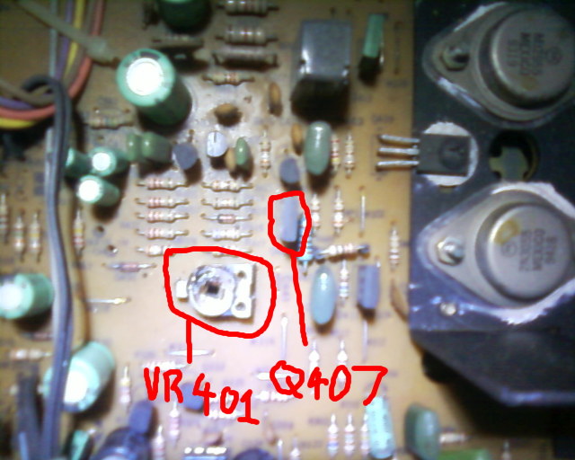

A needle fell through the top of the NAD 3130's case and bridged VR401 with Q407's E contact.
After this, I think the variable resistor caught fire, because I could smell smoke. So now it doesn't work at all, well, it turns on, but all I get is static and audible hiss.
Im clueless as to what to do for lack of knowledge of what parts to buy.
I can solder the new parts to the board etc and do necessary repairs...
I was just hoping someone could push me in the right direction.
Attached is a picture showing what I see, (And some obvious blackening from the short circuiting of VR401 and Q407's E contact), just for reference purposes.
Again, I cannot stress how stupid I already feel, Im just looking for a solution.
Thanks in advance for any help.

It is almost certainly easily fixable but you will need to post a circuit. Otherwise you need to check semiconductors OUT OF CIRCUIT , replace any obviously damaged parts, and have the confidence in your measurements and interpretation of those readings.

VR401 is probably the bias adjust pot. If you have shorted that then it is highly likely that the output transistors are also dead. This could turn into an expensive repair.
Q407 looks like the Vas, the emitter would connect to the rail.
I would check every semiconductor in that channel, and probably replace them all. Parts are cheap.
It is extremely rare to just replace visably faulty components and have things work perfectly as before, please bear this in mind, ill try to give you some advise but you would normally need a few essential items of equipment before attempting a fix.
firstly see if your output transistors are dead, do this by connecting a multimeter to your speaker outputs on the faulty channel if your measuring around 30volts, which is around the rail voltage then the transistors are toast! if you are reading millivolts idealy under 30mv then the problem lies with the damaged components (doh!) and very probably the drivers (the squarer looking transistors. please post your findings so further help my come.

Agree with most of the comments so far. You can use a 60 watt in series with the mains to limit any further damage.
A lot depends on your experience, if you were handed a bag of unmarked transistors some faulty (leaky junctions, O/C junctions S/C junctions etc) and some perfect could YOU reliably and confidently say which were good or bad and even identify their polarity .
Sorry to sound a bit harsh but it's not as simple as saying that such and such a part will be faulty -- replace it and all will be well.
If you replace the bias pot do you know how to adjust it, whether to have it on min or max resistance to begin with etc.
If you can come up with a circuit of the output stage I am sure you can fix it.
You have to remember how the fault occured, you may have zapped even the input stage as well-- you need a game plan to fix it.

Personally I would remove the output transistors and link the output back into the LTP. Only once had I got the driver working and set the bias to minimum would I even consider refitting output transistors (after checking they are not faulty !)

Jaycee: How would I identify all the transistors in VR401's path?
First off, I've made some progress, I bought a replacement 50KOhm variable resistor to bridge the points left by the faulty one. Im sure that the input stage is fine because Im still getting audio output, the only problem is that it is very unstable, and when switching on "Low Level" or "Bass EQ", my speakers pop out, and I wouldn't like to keep testing these Sonab B52's until they REALLY blow out.
Next up, I've been doing some research, and in some cases, people have mentioned "high voltages almost certainly cook your boards electrolytic capacitors".
If so, would this mean I would have to replace all the capacitors, because I would be more than happy to if it would refurbish the board to a certain extent.
Finally, the resistors etc, would any of these be blown? Diode's?
Also my Amp makes use of Motorola MJ2955 transistors, 4 of them to be exact (Assuming two for each channel?)
Would these be the transistors that you all suspect to have been blown in the process of this short circuit?

Alex,
You need to come up with a circuit !! If you do that you stand a much better chance of fixing it. The questions you are asking show you need guiding through it. Post a new thread to see if anyone has one 🙂 The output transistors usually fail short circuit collector to emmiter-- have you measured them. Is the other channel 100% ok. Forget caps for now. Get a circuit.
Mooly said:Alex,
Im very unsure as to what your asking me...
Do you want a circuit diagram?
Alex
Hi Alex,
I don't want a circuit 😉 you do. If you can post a circuit here I am sure you can be "talked" through what to do to fix it.
If the unit were on my bench it's easy, at the end of a keyboard I need to see exactly whats what. Have a search on the Web -- there must be one out there.

More questions,
1. Do you have a meter (D.V.M.)
2. Can you solder neatly.
3. Can you unsolder neatly ( using braid )- thats just as important.
4. Have you any experience with electronics at all, for example, would you be able to identify an N.P.N. transistor from a P.N.P. just by measuring it or are we starting right at the beginning. Which is fine 🙂
Any chance if poss of a picture of the insides of the amp, not vital though.
Mooly said:Hi Alex --- This sounds like a real challenge !
More questions,
I'm working on the D.V.M as I already know its essential, should get one soon, I can solder, thats about all I can say for myself, unsoldering, what do you mean by braid?
My experience in board electronics is limited to a very advanced field, processors, nano-technology, ASIC chips (when I mention all these, Im referring to their inner workings, my experience in application is limited)
As for identifying parts, I'd be pretty basic, but give me a 333MHz MIPS processor and I could probably use it to hack into a Russian Air Force Base, which isn't exactly useful for repairing an amp so forget that part.
I guess, yeah, I would be starting from the very beginning but don't underestimate me much, I have the capacity for knowledge, and a great capacity at that.
Hold out on the picture, Im currently with a very useless cellphone camera, I will borrow something highres and get some detailed photos.
