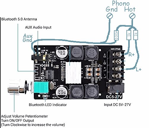

I'm using this module - https://www.amazon.co.uk/ZHITING-Bluetooth-Amplifier-Digital-Channel/dp/B088NFHMND/ref=sr_1_1?crid=3GA2N0JU85EEL&keywords=B088NFHMND&qid=1641051237&sprefix=b088nfhmnd,aps,87&sr=8-1
I need the amp because it's going into a valve radio phono input, so effectively it's acting as a pre-amp.
It works fine with just one channel. Volume levels are great and easily matched to the FM radio volume.
But I'm really struggling with summing the two stereo channels to mono. I seemed to have it working the other day but after spending some time working on something else on the radio, now it's not.
I'm doing it passively with resistors only (one each for each stereo signal, and one connecting the summed signal to the combined ground levels) but wondering if the are wrong or I'm just doing something stupid.
If I connect both speaker grounds together it causes the module to reboot.
Can anyone please help with exactly how I should be doing this please so the two stereo signals are summed to mono and equal in volume.

You bought a one-hundred Watt amplifier to drive micro-Watts into the Phono input of a radio?? Might be over-kill?
Further: those speaker outputs are not grounded. All the "obvious" connections will lose half the signal or short-out the amplifier. (Which would kill it, but the makers got tired of users doing that and apparently added a reboot function.)
And I don't see any need for low-Ohms high-Watts to make a mono line out.
This trick connection to only the "+" terminals of the L and R, plus a Gnd stolen from the AUX jack, might work fine. If too loud, lower the 100Ω resistor to 47 or 33Ω (conversely raise to 220Ω for "more", but that seems unlikely.)
The most obvious place to tap "Gnd" is the "shell" terminal of the AUX jack. Traditionally this was the contact closer to the panel; however iPhone and others have other schemes. The Gnd will likely land on a trace which runs all over the PCB. Carefully tack-solder a fine wire. I have assumed a "valve radio phono input" is screw terminal (also Google was being stupid about phono-jack images), but do whatever connection suits the situation.

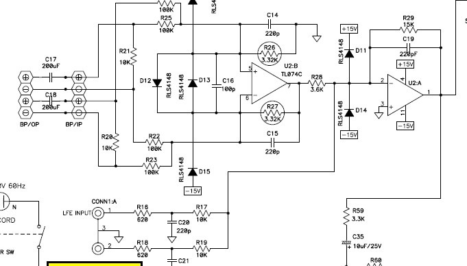

I presume Your amp is in BTL configuration and so it doesn't have a ground at speaker outputs. I would look at home theatre high level
sub input schematics.
