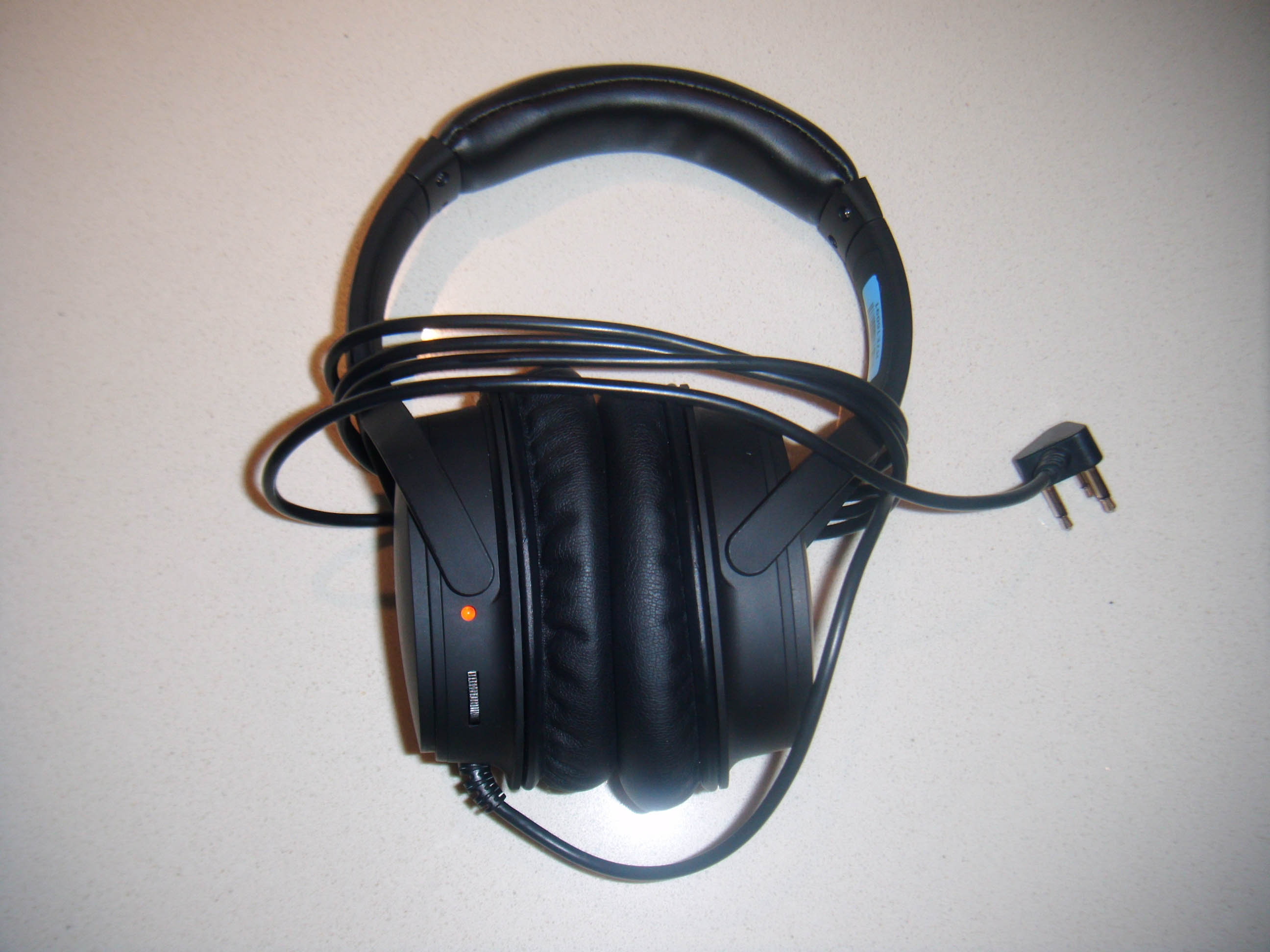

I acquired two sets of headphones with a special plug (shown in the attached image). Of course I cant plug this special plug into my iPhone so i decided to replace the jack with a regular 3.5mm one. the soldering was successful and the music plays however it is very quiet. I have a feeling this is because one of the five wires coming from the headphones is the power for an amplifier inside the headphones. I have to say, I am no electrician so I don't know if this is the case. By the way the colours of the five wires are: Red, White, Blue, Green and Pale Brown.
Why is the music quiet? and what should i do with the three left over wires coming from the headset?
Thanks, appreciate any help

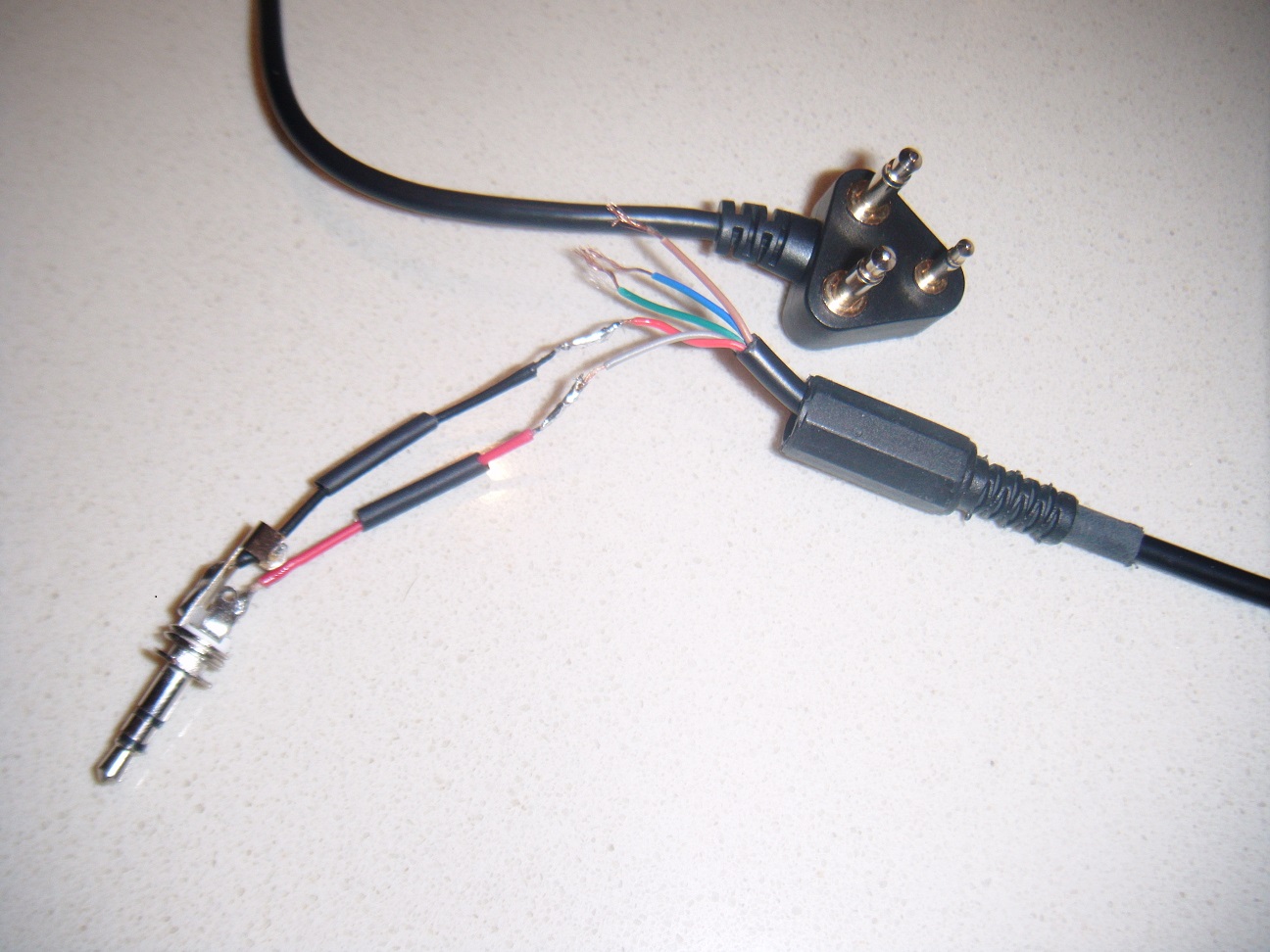

1) that weird triangular plug actually has 2 x 3.5mm mono plugs and one x 2.5mm mono one.
Weird is an understatement and hints at a non Audio/HiFi use but something completely different: communications radio? / motorcycle intercom? / custom Airplane passenger headset so customers don´t steal it from the plane? I wouldn´t be surprised at the last possibility.
2) you have connected only 2 wires out of 5, so in any case it will NEVER work as a stereo headphone.
3) post the full headphone, brand, model, and a link to some page referred to it.

more images and answering questions
No logos or numbers on the set of headphones sorry. but do have a look at the new photos maybe you could figure it out.

For stereo you need a minimum of 3 wires : left, right and ground.
Quite often it is 4 wires, left, right and ground to each speaker.
Maybe you currently have the two channels in series (left and right) so only get half the output volume ?

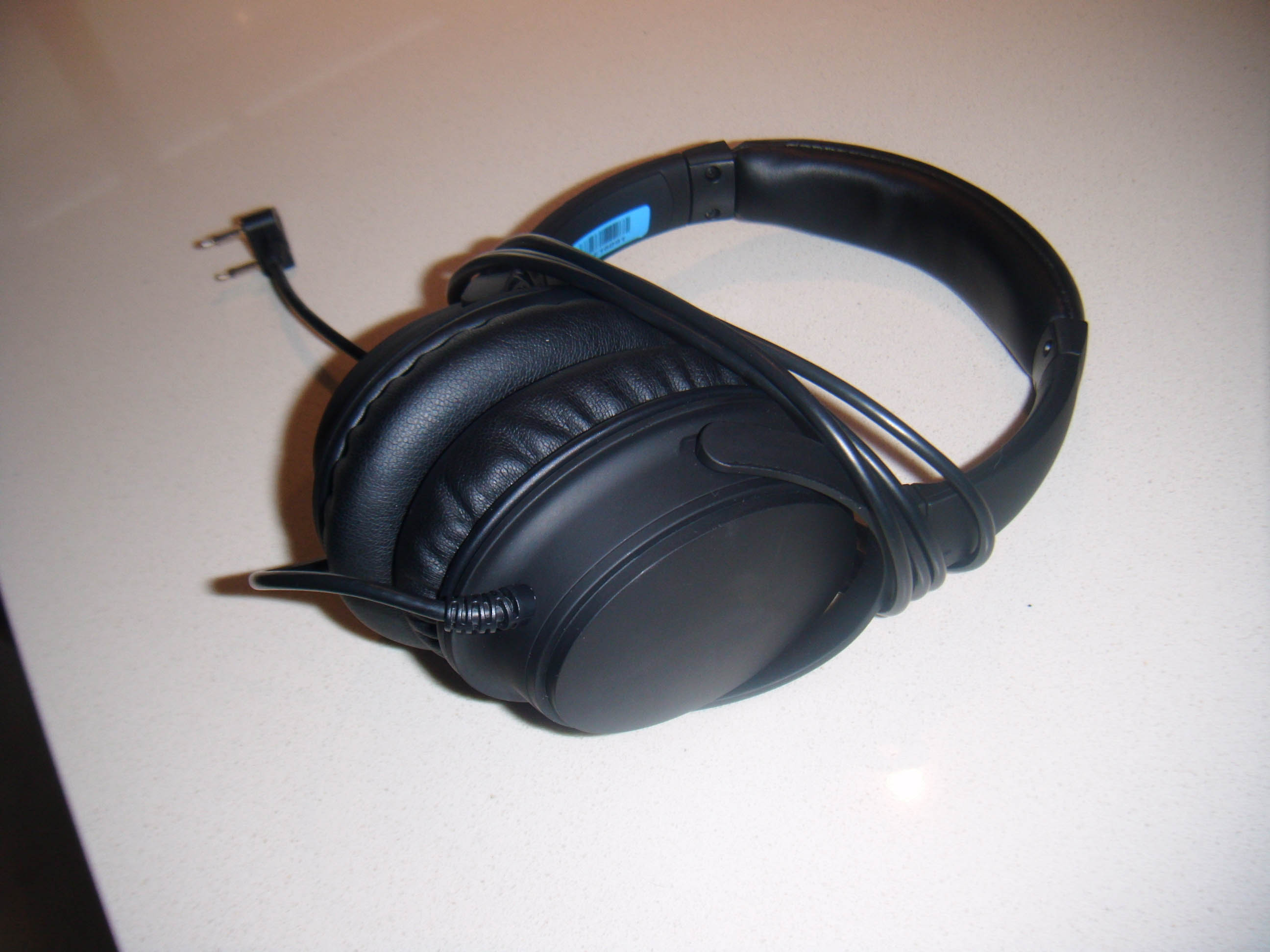

Just curious (and that might at least partially solve the mysterry): where did that headphone come from, or what is its intended use?
You claim no data or labels on it, but I see a barcode sticker, what does it say?
There´s also a red LED visible , and what looks like a volume control under it, this headphone might be active.
Again: where did you get it from?
Was it as is? Inside a blister or sealed bag? A cardboard box? If so, what does it say?
EDIT: you would have saved us all a lot of time if you had been straightforward .
Those are Airplane Headphones, meant to be left on the plane and not carried home.
To ensure that they use a special incompatible plug system, but some do not learn and carry them anyway.
They *are* active and beyond what you can do at home to use them.

Sorry.They are active noise canceling headphones and are a special version of the commercially available LPE-880NC headsets made by Long Prosper Enterprise Company ( LPE ) (LongProsper). They WILL NOT work without power and power is normally supplied from the socket in the seat.

As Mooly suggested, the practical plan, if you dare, is to remove Electronics, identify wires and transducer connections, and wire them straight to a regular stereo plug.
I think you can use the original cables, although connected in a different way.
1) You will need to open the headphones and expose the tiny speakers, we want to see the actual solder terminals or clearly identify the wires connecting them to amp board.
2) also some wires must reach each headphone cavity coming from the plug end, again a picture and just in case name the colours, sometimes they are not easy to identify on a screen.
3) again identify colours at the plug end.
Knowing that, we can suggest a connection "map" .
It should be better to confirm that with some multimeter readings, but if not available, we´ll have to trust colours, so get them right for us 😀
We also want to see the amplifier board(s) so we can suggest what wires to unsolder.
