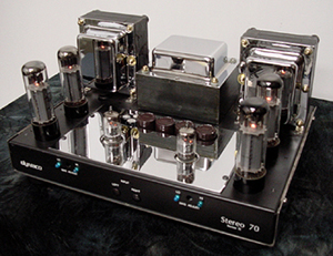

Yesterday, one of my 6CA7 tube in my amplifier started to glow really bright while I was listening to music. It happened after maybe 1 hour of listening, the gray cathode-plate assembly became incandescent with a red-yellow light, as if the heather was too hot. The amplifier was still working OK at that time and music seemed fine. I turned off the amplifier, and waited a bit for tubes too cool down. I swapped tubes, and turned the amplifier On again, and everything was OK. I listened to some music for at least one hour, and everything was normal. The amp is a Dynaco ST-70 serie 2, from 1990.
So right now, I don't know if it is tube related or a problem with the amp.
-Anybody seen something like this?
-I read the archives, and someone mentionned maybe a bad coupling cap problem. Is this possible? And why does it seems intermittent. It is surely related with heat...
Thanks for any input.

It could be an intermittent coupling cap, but with that amp, if you still have the original tube sockets, the problem may well lie there. I'd replace all the output tube sockets (it's a pain in the ***, but Dyna used some really cheap hardware). If the coupling caps are original, you probably want to replace them, too, just to be sure.
SY: How a socket problem could produce excessive heating of the tube and glow?
If it is a socket problem, I can change sockets and caps. I will try to reproduce the problem to be sure

Gary, if the socket pin corresponding to the tube's control grid loosens, corrodes, or otherwise has intermittent contact, the tube will lose bias and run away. That produces a nice light show...
While you're under the hood, check the cathode resistor (the 15.6 ohm) to see if it is cracked or changed value. Tube runaway stresses that part and I've seen more than one go blooey shortly after an over-current incident.

The amp seems fine since yesterday. It may well be a bad contact. I had problems with these sockets. I will check resistance value and caps anyway. If the problem arise again, I will change sockets.

I want to confirm that I seriously think that the problem is the sockets as SY guessed. I swapped tubes, and the problem is not tube related, nor channel related. (i had the problem with both channels at different times, and not the same tubes)
The sockets are corroded a bit, and they hold some tubes loose. Some tube don't fit tightly, but seems to be loose and move a bit, not good.
I will change to gold sockets. They are PCB monted. I guess it's will be hard to unsolder them. I have desoldering braid or something.

In most cases you can usually tighten the contacts with a jewelers screw driver inserted between the socket body and the pin. (There are some pin types where this doesn't work too well, these look sort of like a tuning fork as an analogy..) Make sure of course that the amplifier is disconnected from the mains and the supply capacitors are all completely discharged. - Use a meter to verify.
Replacing the sockets is never a bad idea, but unless you purchase substantially better quality sockets it is not going to make a big difference. The gold plating on current Russian and Chinese made ceramic pcb mount sockets is very thin and the contacts are otherwise no different than what is used in the cheaper socket.
