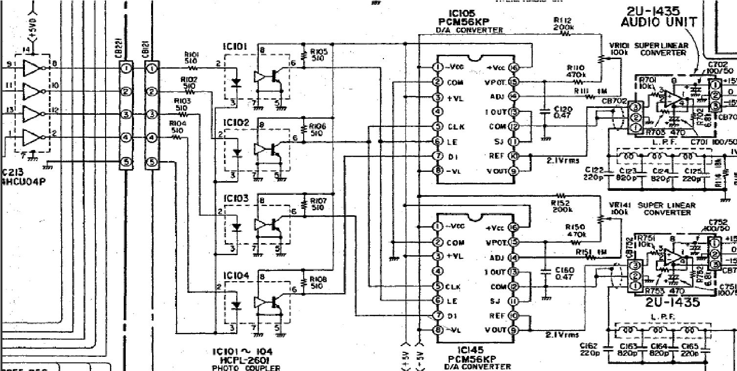

I made the nos DAC with CS 8412.74 F04, PCM 56 and used the entire audio section of the Denon DCD-3300 and first appeared a problem with too much bass.
I heave Kenwood KA-1100d and BOSE 601 Mk III, high and middle are pure, but a lot weaker compared to the bass that are also clean,they killed!
I keep the tone controls flat and do not know what the problem is? Does anyone an idea what could be happening?Use Kairo sheme 😡
