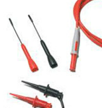

Here's the retractable tip from Pomona that I was talking about with only the tips exposed. This is what I have at work. I use something similar at home which I got from a local ham meet with the straight banana plug and thicker leads made by a different US maker.
Pomona P/N: 5953A
Digikey sells them for $27, not cheap but worth it. Wires are wrapped with high temperature silicone insulation. These probes are perfect for piercing PCB conformal coating as they have sharp tips.

I have been using Probe Master products for almost ten years now and highly recommend them. I first purchased from them when I bought a used HP 3468, which came without probes. I later bought other used units on eBay and purchased the probes from Probe Master again. I encourage you to buy the kit and not the leads only, as the price difference is really small.
8000 Series Multimeter Test Leads mfg. by Probe Master
I even bought a kit to use with my Fluke 187, even though I bought it new and the original probes are still in good condition. The attachments included in the kit are really useful.

The second to last picture on the post linked below shows the probes with the sprung hooks attached and in use. Only a very small portion of the metal hook is exposed. The probes a well guarded and suitable for measurements in crowded spaces.
