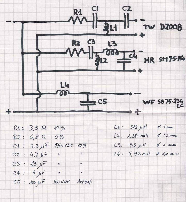

Jgtx: If you have the Proac EBS, they would be the 16 ohm version mids. The back of the speaker rating is for the whole system - with all drivers in the xover.
See the following thread (I added the Studio Tower xover there - which should be the same as you EBS):
http://www.diyaudio.com/forums/showthread.php?s=&threadid=122779

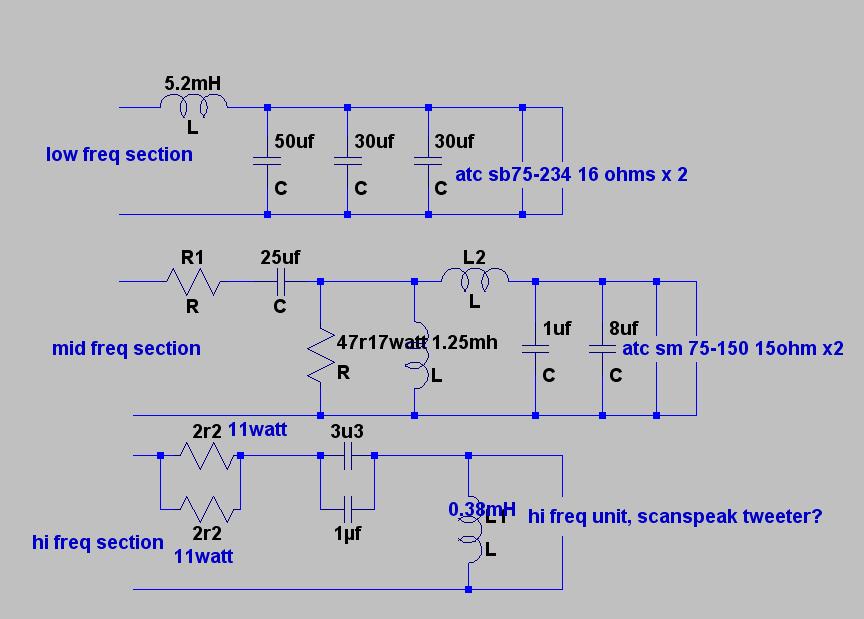

tamariska said:I got the following xo design from proac. No information whether was 16 ohm version of sm75-150 midrange.
Is this proac studio 3 speaker?
This is the x-over of the E.B.S. model (the same speakers I got at home). 16Ohms in this case.
Jgtx.

Some years later I started tinkering, first was the crossover. When I took out the original, and did a careful drawing of it, I was amazed that the + ve run went straight to the woofer, with the tweeter out of phase, - ve run straight to the tweeter. Now when I look at the drawings submitted to you, it shows the same thing, + ve runs straight to the drivers.
Do not discount this fact. When building your speakers, listen with this orientation first, then switch the runs to the opposite side, do not go with what sounds better, go with what sounds natural. Too many people believe the + ve side gets all the crossover stuff, phooey I say, phooey. ProAc (Mr. Tyler) have built, and sold, way too many speakers to way too many happy customers, to be wrong.
The simplicity of his crossovers puts a smile on my face.
