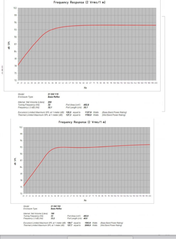

If you are looking for "more compact", the B&C 21SW152 is a better choice due to its smaller VAS and larger excursion and power handling, a bit more output in a 190L than the 21sw115 in a 250L (internal volume) box in these simulations:

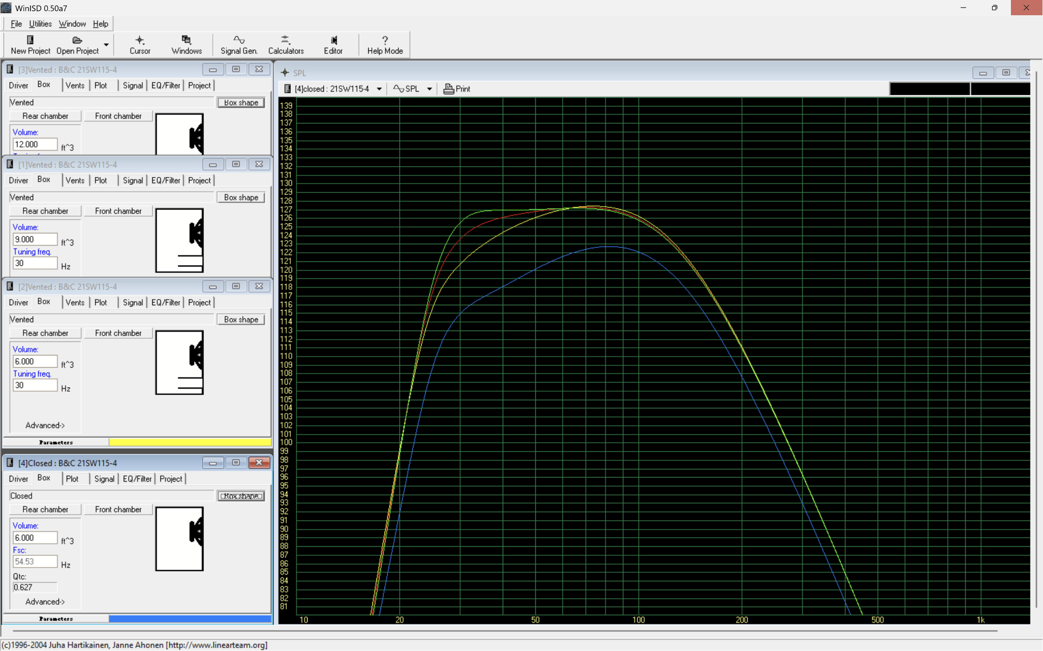

Quick models in WinISD.
Top three, ported, all tuned to 30Hz, 12, 9, and 6 cubic feet. The bottom line in blue, sealed, 6 cubic feet. Xmax is hit at 800 watts with 2db bump@30Hz, Q=2.
All high passed at 24Hz 8th order BW. Low passed at 125Hz 4th order LR.

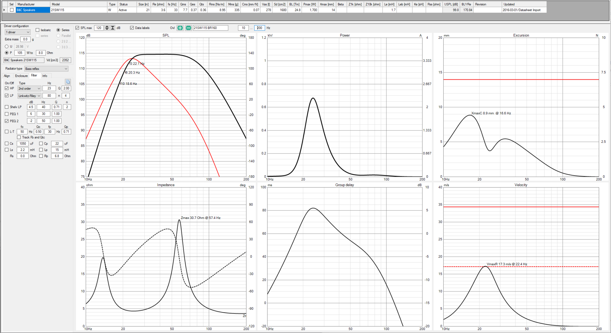

In the process of trying to get the right design for 21SW115. I want the size to be more compact and willing to lose a few dB for the tuning to stay low.
Here is my design for a Vb = 160 litres (5.65 cu.ft.) vented-box enclosure, tuned to Fb = 24Hz. This design has a 2nd-order high-pass peaking filter applied, with a frequency setting of 23Hz and Q=2.0. There is also a modicum of parametric EQ applied, −2.0dB at 50Hz with Q=1.0. A 4th-order Linkwitz–Riley low-pass filter set to 80Hz has also been included.
The above design seems quite promising, with the vent air velocity reaching the warning level at a nominal power input of 105 watts re 8 ohms. The peak power required to achieve 114dB maximum SPL is around 675W. The maximum displacement value falls well below the Xmax of this driver, so it can accept higher short-term power peaks while still working relatively linearly.

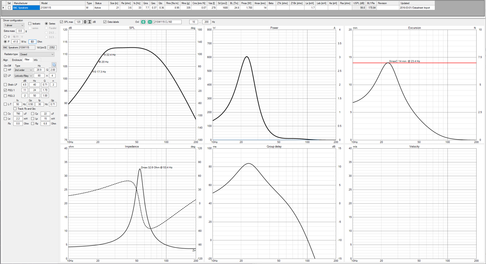

In the process of trying to get the right design for 21sw115. I want the size to be more compact and willing to lose a few db for the tuning to stay low.
Here is a 160-litre closed-box enclosure design for the 21SW115 4-ohm driver. Parametric EQ has been applied, with +11dB applied centred on 24Hz with Q=1.70. A 4th-order Linkwitz–Riley low-pass filter set to 80Hz has also been included. Peak power input of 600W produces a maximum SPL of around 113dB, and the F3 is quite reasonable 22.4Hz. The roll-off is a gradual 2nd-order slope, so it will help with transient response. The closed-box system has considerably more output at 10Hz than the earlier vented-box system, and it will make much better use of room gain as well.
Thank you so much for this detailed response, I will definitely change my driver choice to the sw152. Around 200L is definitely compact enough for my requirements.
