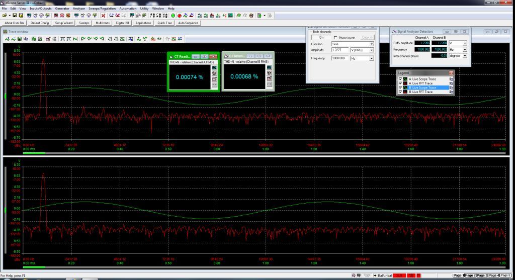

So... DScope arrived. I haven't totally gotten my head around the self test utility yet (have to do some work to pay for said DScope), but from connecting an XLR from I-O it would appear to be in decent condition.
The weird thing is, there is more THD on the left channel when wired OP1-IN1 / OP2-IN2, but if I swap leads into an X, so that the Osc1 feed IP2 and vice versa, I get THD+N <0.0007 for both channels... I can only conclude that THD on one of the channel I/Os is higher than other, so if I swap I-O in an X, the additional THD on oscillator is offset against better THD on analyser channel and vice versa. Will plug into the UPV and this should reveal all.
Thanks again.

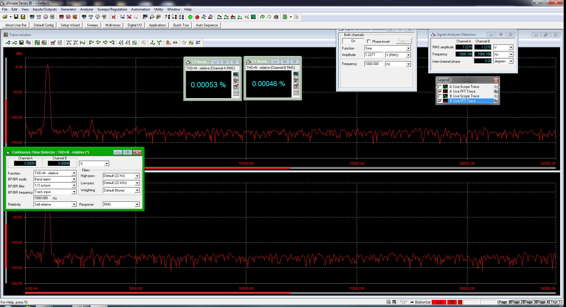

Ok... UPV measurements as follows:
Prism OSC1 into UPV = 0.00055% @ 1KHz @ 0dBu
Prism OSC2 into UPV = 0.00064%
Fed from UPV-B1 (low-THD) Oscillator, into DScope:
Dscope IP1 = 0.00053
Dscope IP2 = 0.00046
Have attached screenshot of Dscope fed from B1 oscillator.
To summarise: it looks like the DScope is pretty decent (as Ruari suggested might be the case). The guy who sold it deserves good feedback 🙂
