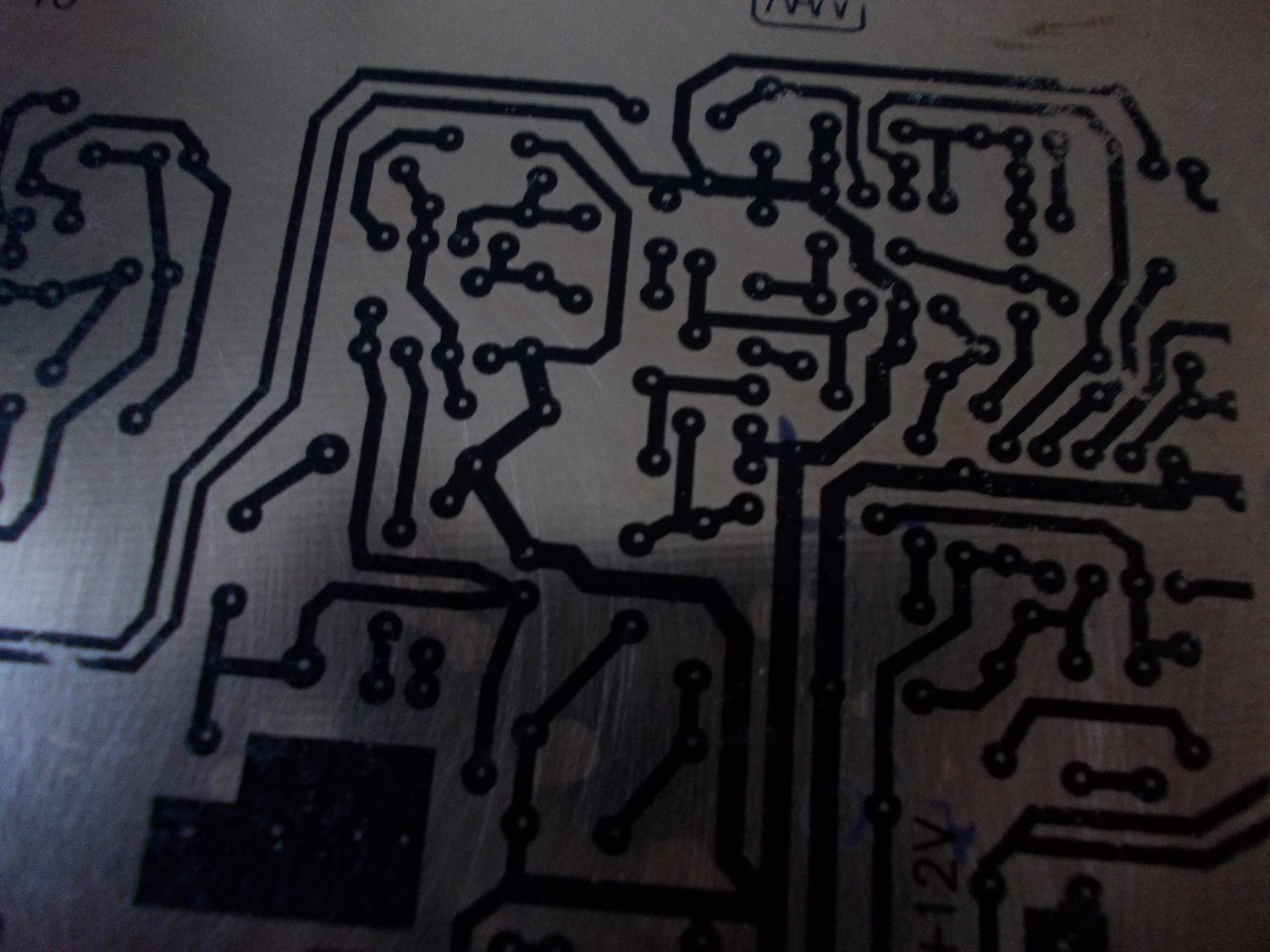

I ahve print a circuit board on a laserprinter for toner transfer, it work but when I do a double sided one i do see the printer is not excact, because of the top pcb is mirorred it do count x 2 when it is not at right 90 degree angles, I hope I say it right.
Have someone do now this? because how bigger the pcb how more problems with pads are out of line.
I have a samsung cheap laser, I think I go find a professional one but it will always be not precise with mirorred angles.
last photo is a transfer test.

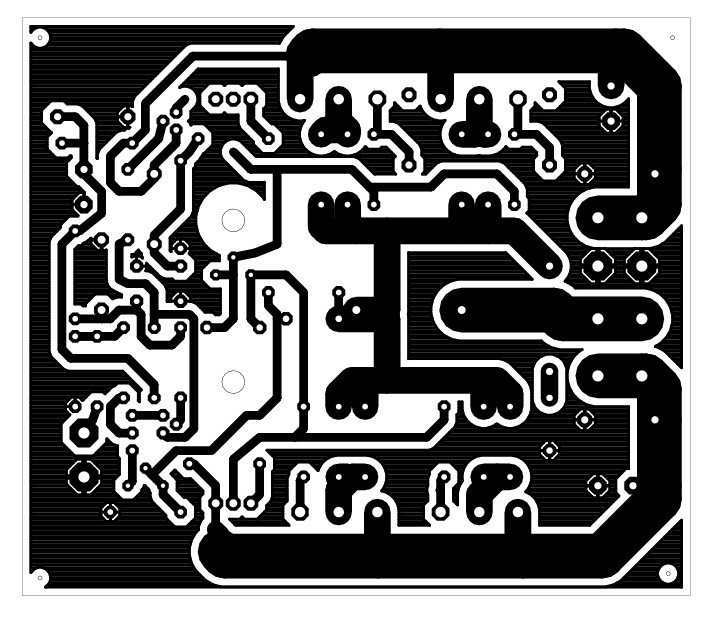

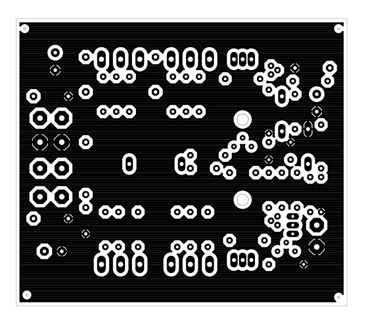

Hi All
I have a samsung laserprinter ML-2165 600 dpi printer./
The lines in the print is not seen in real, I have done a screen capture from the ghostscript I using.
My problem is when print for example a square box and mirror one of them she do not fit anymore but has a mis alignment with this printer, most caused by the printer system who is most plastic. and so I get not the layers aligned, also not when drill smal holes and align it, yes soms pads in wone corner is oke, but on the other side it is not, and how bigger the pcb how more it do mis align.
If I do print both without mirror the top layer everything is fine, so printer mechanics is not exact horizontal of how it needs to be.
When i do single sides pcb then this problem is not a problem.
coming week she bring a HP 4100TN 1200 dpi print I have bought one hour ago, this professional postcript printer do a much better job, I have one but these was defective.
Afcourse a real hp penplotter do the best job, this is real precise when flip one square get lines also then in line.
PS it is a double sided board of a allfet amplifier.

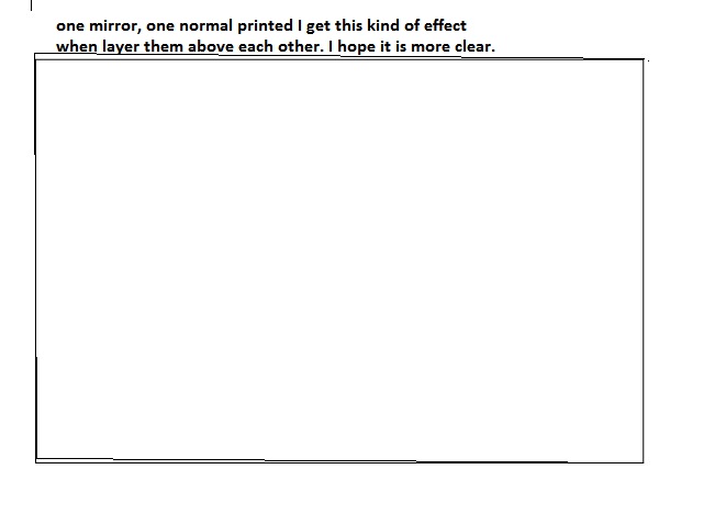

I have here a example what happens in a more extreme way on the photo when mirror one
pcb layer in this case top, what do multiply the printer error twice.

I have now include a picture to clear some out, when mirror one layer the printer error get
multiply by two, giving the error with the lines not cover each other anymore, wich give also
drill/pad errors afcourse. I do not now software who can correct it for me, it excists somewhere
even software to spare film by print all on onesheet when it fits, but maybe then the error
will stay, or the both layers on one sheet do cancel out each other.
A real plotter with a pen, then this do not excists she are very precise.

One thing have to be said, this is a example I made with a screen capture tool and edit to let see what I mean, this is afcourse not printed by the laserprinter.
when one is mirror I get this mis alignment from the printer making pads drills not fit.
My inkjet however fit perfect, also when mirorred, but is not really suitable for artwork making.
regards

picture you refere on is not from printer, it is a example made with windows paint to show what I mean.
in extreme sens, see it like the laserprinter drum is not aligned so it prints the vertical line not excact vertical, (yes in english it is difficult to explane) the print in the length of paper is possible oke.
I have done a long time ago adjust the drum unit clamp in that printer by make the holes of screws bigger and tilting the drum until it did match, but these modern printers has not this possibility and I do not now if software can do this.
so for clearness, the picture is a ordinairy paint from a screen catch and so it has the ragged lines, in real it is oke.
regards
