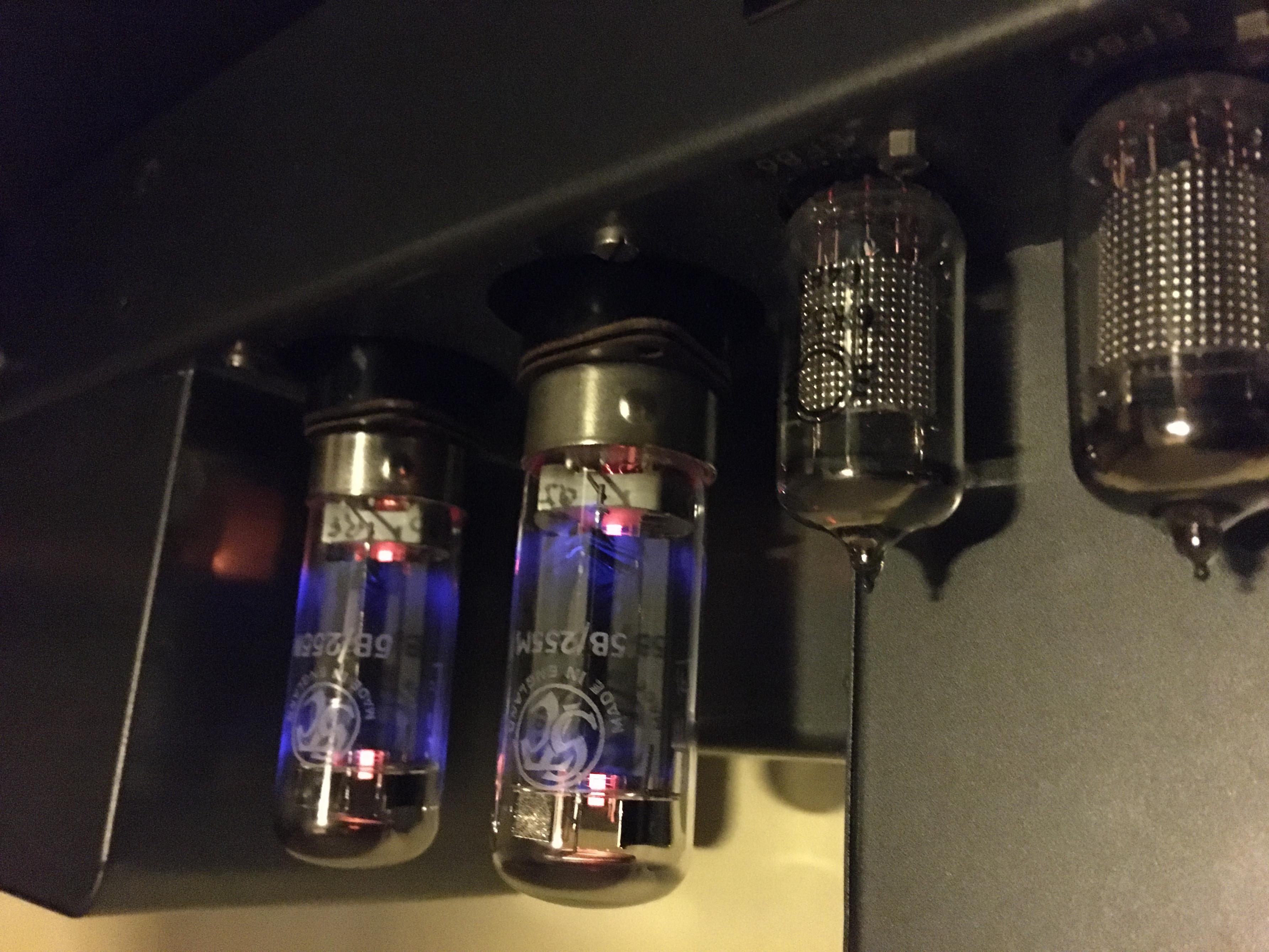

I can't help but look at my poor-man's KT66s!

Which 5781’s? I’ll bet some do and some don’t. I’ve had old 7591’s as a teenager that were pretty spectacular, but the EH quad I’m playing with doesn’t do squat. Nada from either batch of Tungsol 6550’s that are going in the big amp. I have to go back to my old stash to get anything with even a hint of blue glow. I’ve even seem 12AX7’s do it on occasion - and that’s with maybe 200v a-k if you’re lucky so it can happen at lower voltage.
That particular blue is “cobalt blue” and that would be the particular impurity in the glass causing it. EH advertises “leaded glass” for their KT88/6550, and I assume the tungsol is made in the same factory with similar if not the same processes. Lead doesn’t glow like cobalt does. I’m wondering if it sneaks in occasionally, or if some makers intentionally use it.
Well there’s a vote for some New Sensors that are doing it.
Of course it is going to happen around the cutouts in the plate - relativistic electrons have to be hitting the glass and they have to come from somewhere. I’ve seen some with lots of holes in the plate have darn near the whole inside of the glass glowing. Old 7591’s and 7868’s from the old Fishers used to dance like a disco light show when driven hard where the supply sags. Those were GE and Sylvania. I went through several of those units growing up - wish I still had them. The EL34’s I was using were Class A triode strapped and of course stayed rock steady. Best I’ve ever seen was a pair of 6L6’s in a friend’s Peavey, but I can’t recall the brand and it was 20 years ago. First time I ever noticed it was a friend’s Sunn bass rig, probably 6550’s. Then I looked inside our black and white TV set and darned if the horizontal output tube wasn’t glowing just like it. None off the others were. I had lots of small radios and console stereos and nothing ever did that, so I assumed voltage had something to do with it (which it does).
