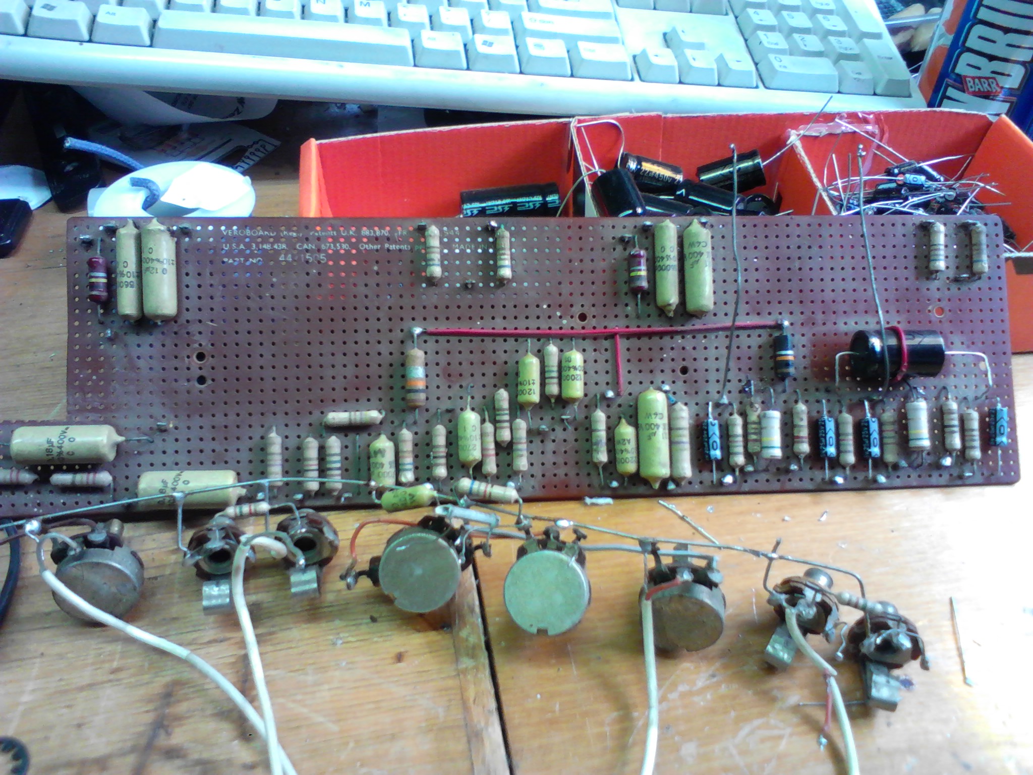

trying to work my way thru the circuit in this amp not sure if Ive got it right Please hav a look an see if it makes sense so far this is the preamp for the bass channel.
contacted the company that made president and jansen but they swear they never made any on veroboard, so they hav no schmatic.
it used to sound great but needs Caps and pots and jacks replaced, as i started to do this it started to fall apart 😱 so i need to do a schematic quickish so i can put it back together afterwards

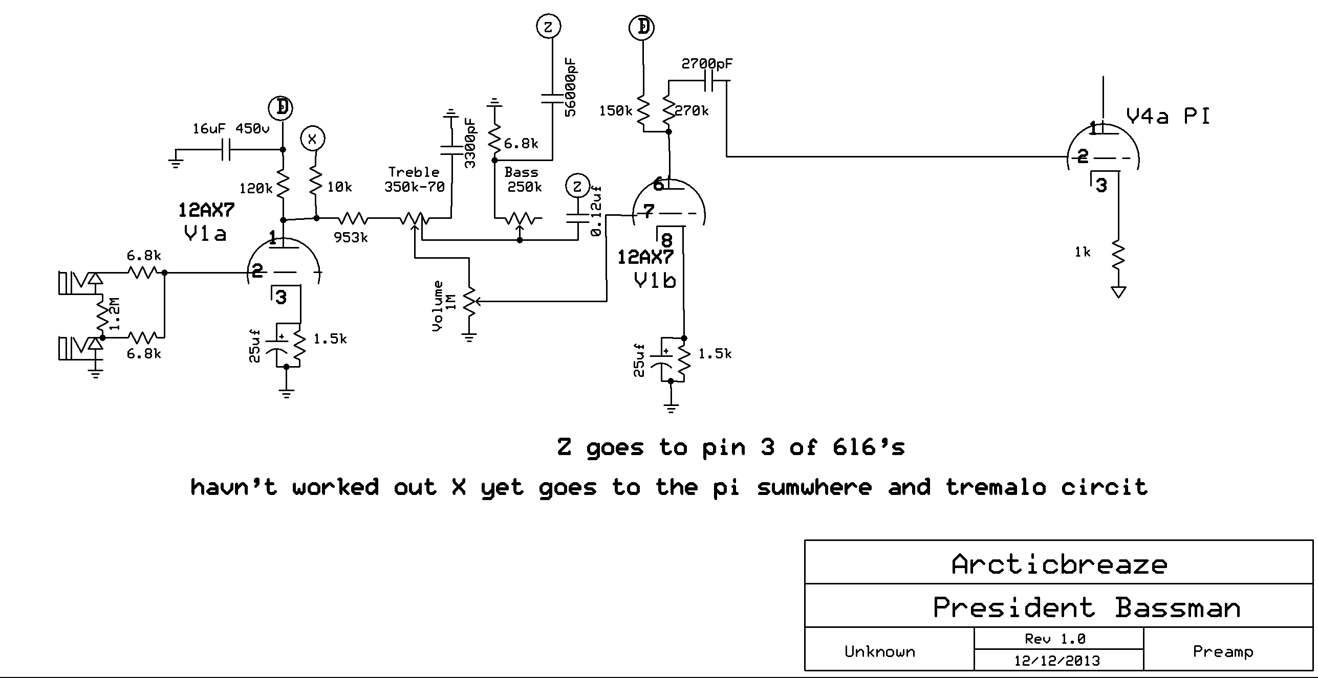

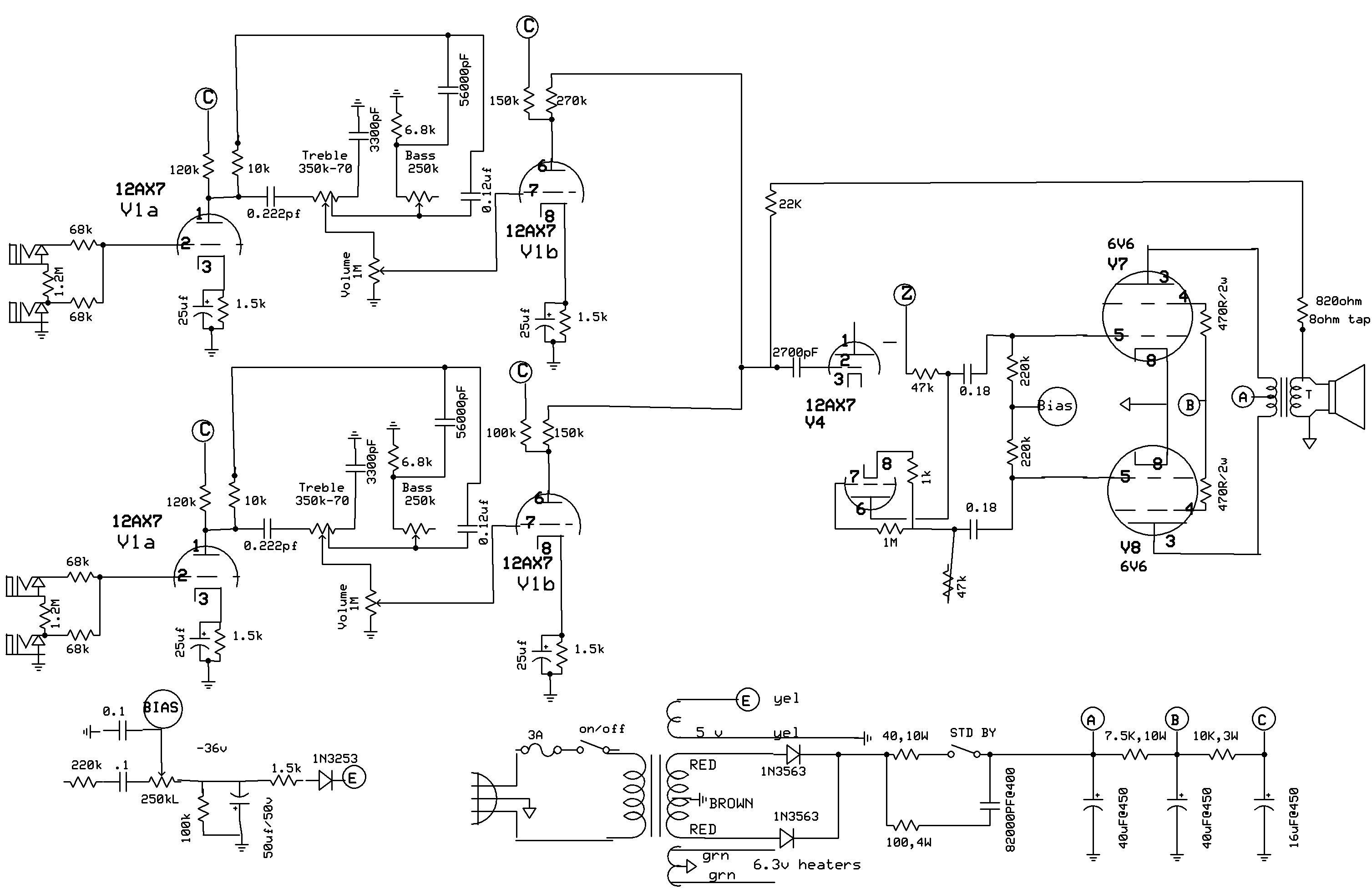

Ok so that first attempt was way off but here's what I've worked thru so far.
Oh and I also hate Mr Phillips for making Caps that look like resistors.🙄
there's more to the PI and bios circuits and i hav'na even looked at the tremolo yet
