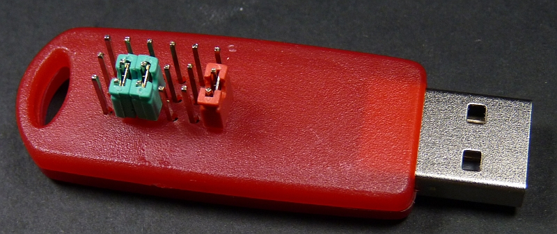

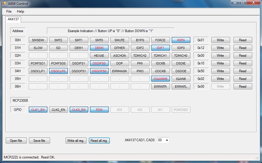

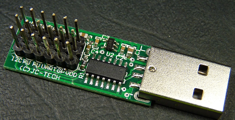

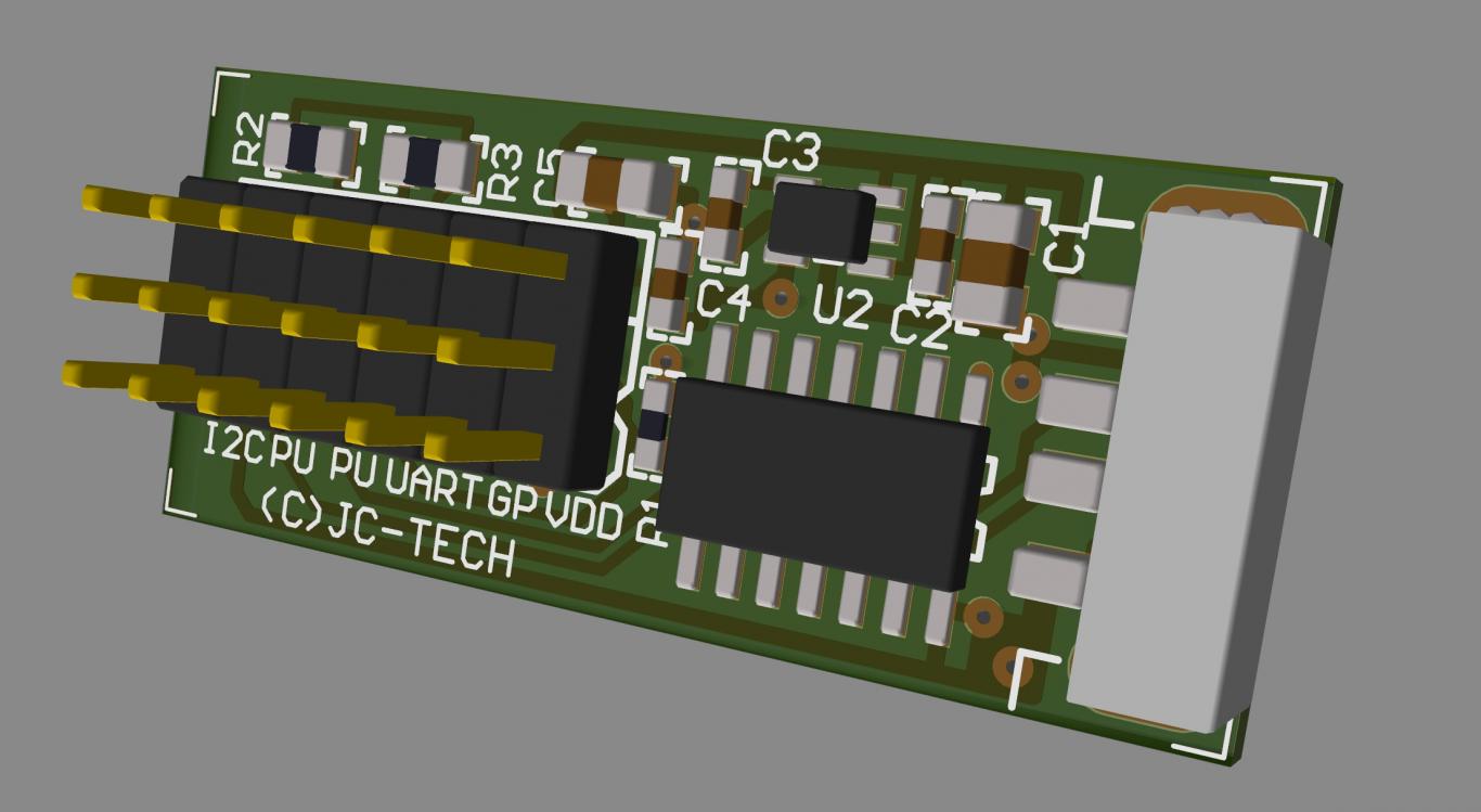

The rest of the project, USB to I2C converter based on Microchip MCP2221 chip.
Another person from Polish Audio Forum wrote a program to support the board.
Best regards
JarekC

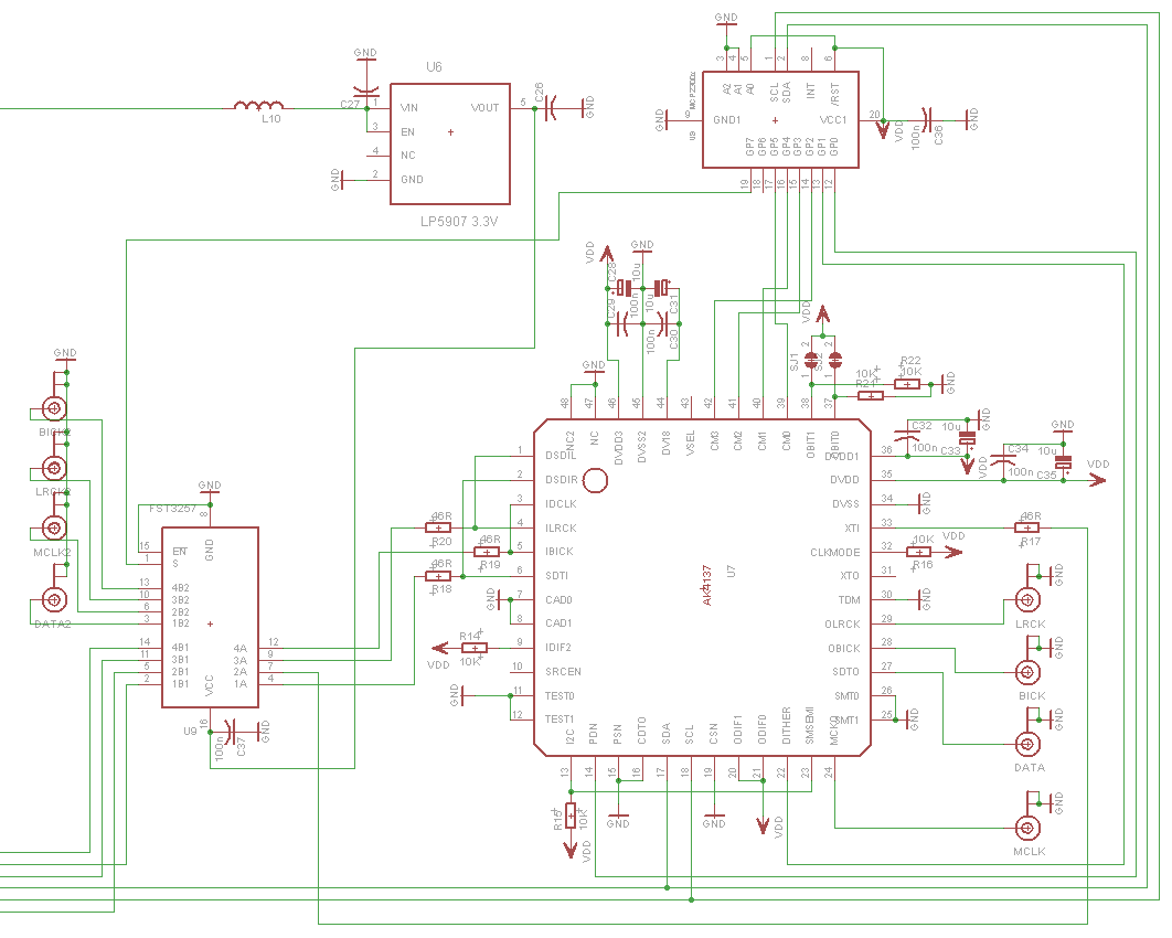

I'm experimenting with an AK4137 in serial mode but I seem to be stuck at something seemingly trivial.
I'm using pins CM3-0 to set the various modes of the SRC but I can't get it to run in Mode 8. Looking at the datasheet, it appears that CM3 must be pulled high and all of the other pins (CM2-0) must be floating(?!). Whenever I try to start the chip while I have CM3 pulled high the chip doesn't start up, no matter what I do to pins CM2-0.
Any ideas?
To run in Mode 8 CM3 must pulled high, CM2-0 pulled low or high (doesn't matter).
Show schematic maybe I will help you.
To run in 768kHz, MCLK must be 49.152MHz (49.152MHz / 64 fs = 768 kHz).
I'm using an MCP23008 to control several of the AK4137's pins, they all behave exactly the way they should (I'm getting either upsampling or downsampling, depending on the MCLK and the CM3-0 settings), but I can't nail Mode 8.
No matter what I do to CM2-0, when I pull CM3 high the chip doesn't start up (no reply to I2C commands). It goes without saying that I'm changing the CM3-0 pins while I'm keeping PDN low.
This is my schematic:
attachment.php
I'm testing with an AK4118 s/pdif receiver which outputs a max ~24MHz MCLK so I've only managed to go up to 192KHz. If I can get to Mode 8 I should be able to go up to 384K.
The idea is to build an s/pdif receiver with built-in upsampling and converting to DSD, including a second I2S input for a USB interface or an RPi.
When I'm done with the design and have verified that it works I'll do a proper presentation (and of course give out the full schematics, code, etc.).
Can you change other modes ex. from Mode 0 to Mode 2 ?
As you know in PDN = "0" it is RESET and Power Down.
When you change in PDN pin from "0" to "1" in:
PSN, CM3-0, OBIT1-0, TDM, ODIF1-0, IDIF2-0 and CAD1-0 pins you must set correct values.
I selected it by "hardware" as in post 1, and its work OK.
Edit:
try to analize by voltometr if you have "1" on CM3 when change PDN from "0" to "1"
Yes, I can change between all of the other modes, except for Mode 8.
I take care to properly set all of the pins before power-up (PDN -> high).
Still, Mode 8 won't get enabled.
It looks like I'm missing something pretty basic.
I'll check CM3 like you said but I've tried hardwiring it to Vcc with no change..
