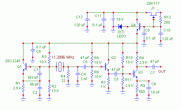

Try this one out.
It also uses a series resonsant crystal, has low distortion, and comes with a low-noise regulator. Puts out 1.6 V p-p.
This is the first version, so more revisions are probably in the works.
It is easy to measure if a crystal is series or parallel resonant. If you need to order one, and the supplier doesn't know which one it is, find a different supplier.

Might it be better to:
a) run the LED string directly from the current source (that's the way it already is - just reviewing)
b) connect a 100 Ohm resistor (or maybe even some higher for a lower -3 dB point) from the top of the string to the base of the emitter follower
c) connect the 120 uF and other filtering capacitor to the base of the emitter follower?
The idea is that the LED string is a more or less low impedance (hence the reason for using it as a voltage reference). Bypassing this low impedance directly isn't really as effective as using an RC lowpass filter to get rid of noise. The voltage regulation under dynamic conditions shouldn't be affected.
Good? Bad?
Gotcha. For a 400 Ohm source, the resistor would be waste.
Have you ever measured the noise voltage density across an LED string? I'm curious how low it is.
Do you find blacking the LEDs out with goop of some kind, or otherwise shielding them from light, lowers the noise? (LEDs - and semiconductor lasers - also exhibit photoelectric effects, although they aren't real efficient.)
I have only measured it on a RTA, not a wide-band spectrum analyzer, but is low. Very low. Also, the 'lytic cap is there to reduce any ripple that might be on the base, as that will modulate the oscillator. Which is why the whole thing is fed from a current source.
Jocko

I was just curious about the LED in specific. Some guys I know have abandoned LEDs in this type of application because they were too noisy.
These same guys also found that you really needed to cascode the current source (hope I didn't just step on sensistive toes) and add a series resistor from the drain of the cascode FET to the rail in order to get the isolation they were looking for.
They were looking mostly in the audio band, and that may not be so important here.
Thanks for the guidance. I've been too lazy to measure these things myself...
FET current sources do not have the high impednce BJT types do. Both work fine, but you have to decide what you are trying to accomplish in order to decide which (if any) you should use.
Used to have a lot of data about current sources using LEDs. Can't find it though. Yes, there is a noise issue there. Wish I could remember what exactly the results were.......Oh well.
Jocko

Jocko, your oscillator is a colpitts (you use the big "L" in crystal = parallel resonance)
What is the advantage to take out the signal via a resistor? You lower the Q-factor by that.
Jocko
Most 99.99% (or even more) are parallel mode crystals. You may have to order a special cut crystal. Not so expensive! Check http://www.kve.se Kvartselektronik in Sweden.
BTW: My oscillator is a "Butler"-type did I read in the document below. Didn't know that.
The advantage of a Butler oscillator is that the crystal is very hard connected between the low input impedance of the CB stage and the output of the emitter follower. When I tested the circuit I noticed that it works better with very low output impedance of the emitter follower.
I must add though I'm not an expert so take my advice "with a pinch of salt" as we say in Sweden. Crystal oscillators is a very wide subject if you want to do it totally right.
