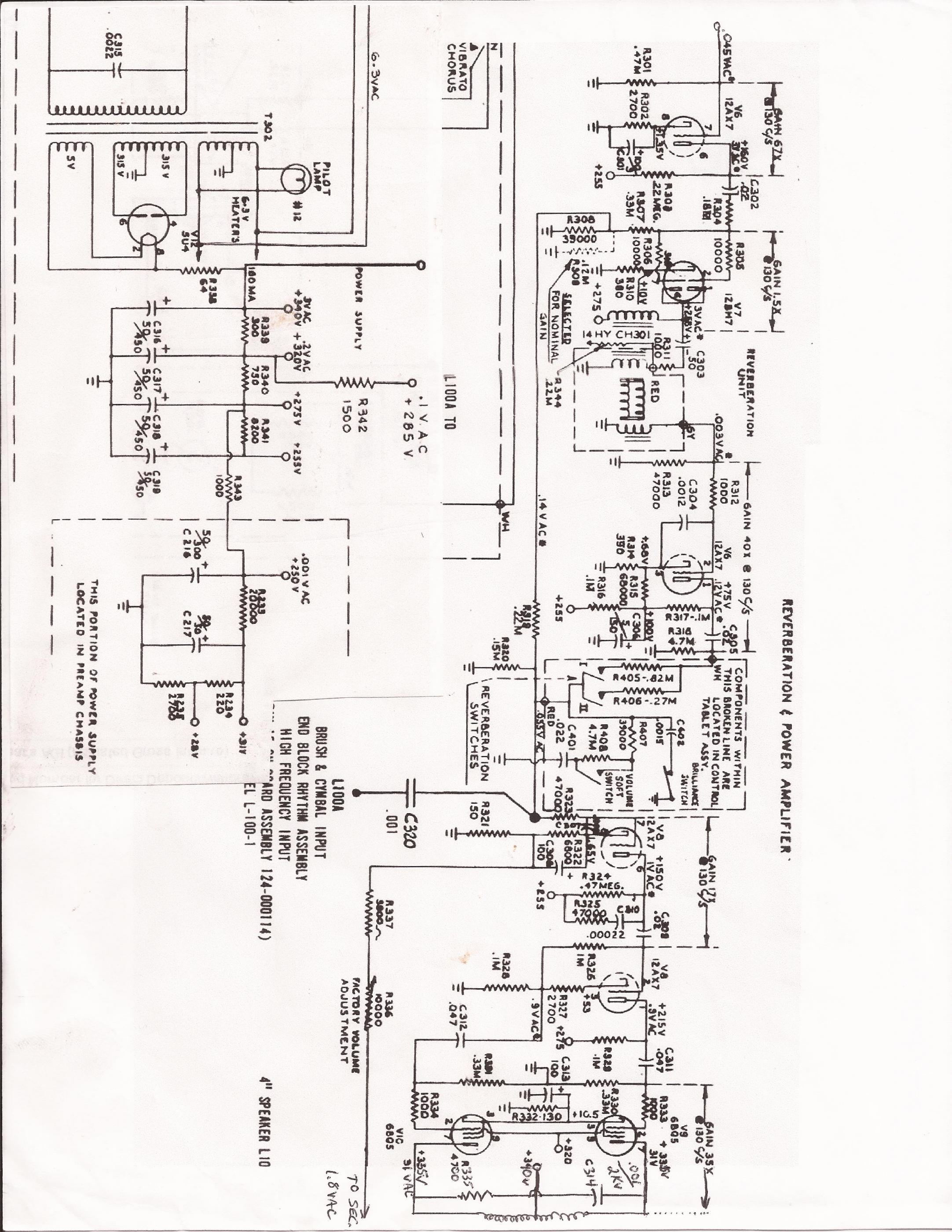

I have a few of thoughts.
1. For the PE amp, if it is cathode bias, sub in 5881 tubes and replace the cathode bias resistor if need be.They have close to the same wattage output. You just need to check about OT pri impedance. At lower B+ voltages, they could be close.
2. For the Bogen, 7591s are the same tube as the 7868, just a different base and pinout. Just replace sockets and rewire. No worries about OT or anything else. They are structurally the same tube. Your trannies might not handle the 6L6s. If you want to try 6L6s, then you have the correct base for them.
3. The reverb is not tied to the output section for the Hammond. Is this the one you said the guy started working on? If he did, it might be best to start over. You don't know what he did with it. I only added volume controls and changed a few resistor and cap values to get the sound I wanted. I also got rid of the places they killed all the preamp signal. It sounds as good as any 18 watt amp I have heard and this includes Marshalls too. This amp sounds so good, I haven't even put in a tone control yet. I just use the controls on my guitar. Less signal loss this way. And it cleans up really nice for those sounds, too. Just use the vol on the guitar.

1: He had mentioned that the PE had a replacement xformer on it (he purchased it that way) and I just read the little label on it. 6600ohm (to 4, 8, 16) but only 35 watts. So that got me curious and I cracked open the bottom to look inside. A couple of wires have been cut (and have the helpful labels, "1", "2", and "3" on them and they're just dangling free with their strands happily waving about). So I'm thinking that maybe the PE wants to be a different amp... A 60 watt replacement OPT won't be cheap (with shipping, probably $90 from Edcor) I'm not sure what the B+ currently is, but I'll have to measure the transformer at some point to see what it's putting out and then I can start thinking about what kinds of power tubes would make a good replacement. I'm in no rush on that. Got plenty of other stuff to do first.
2: I didn't realize the 7591s were going to be so much less expensive (should have checked). That's an excellent solution. I could buy adapters ($20 each), but I'm pretty cheap, so I'll probably rewire the sockets.
3: He didn't want to sell the Hammond he had started working on (though he initially put it on the list of what he was willing to sell, but that's cool. He was a super nice guy and I got an awesome deal, so no complaints). This is a pull from an L101 he had, separately. I haven't cracked it open, but looking at the schematic (Page 32 of 78 in the PDF. The ones on 33, 34, and 35 appear to be more or less the same. Maybe some minor component changes) for the L100, it looks like the input comes from the percussion amp, goes into a 67X 12AX7 gain stage, then into a 12BH7 reverb driver, reverb transformer, reverb tank, then on to a 40X 12AX7 reverb return gain stage, a 17X 12AX7 gain stage, then a 12AX7 PI, and then EL34s.
It looks like there's a bypass for the reverb (to the right of the reverb return gain stage and I believe the bypass signal runs below on the line labeled ".14VAC"). He gave me the percussion and vibrato amps as well. I might turn one of those into a tremolo circuit and hook it into the main amp.

This schemo might serve you better,I put the power supply in the lower left because there was nothing there of concern. The input is the RCA jack marked WH. The reverb send is RED and return is GY. I redid the Red as the input jack and the WH as the reverb send. This way both reverb jacks are next to each other. You can sub a 12AU7 for the 12BH7 if you don't have one. Must be a typo but the output tubes are EL84s.

There's a screwdriver pot on the back of the amp labeled "gain". Is that the "Factory Volume Adjustment" shown on the schematic?
Just to confirm, the OPT is 8 ohm secondary, correct?

Yes, the gain knob is Factory Vol. Adjustment. NFB loop.
Yes, 8 ohm secondary.
You know, I have built two of these and brought them up with a variac and haven't replaced any filter caps, just those cheap disc coupling caps. My amps were in much better shape, were stored better so no corrosion or other things. I have very little 60 cycle hum.
The changes I made are to numerous to get into on the forum. Changed resistor and cap values, added preamp and master vol, boost switches, reverb, etc. I left the tubes biased the same in one and changed one in the other.
One thing for sure is the power to that cap the mice chewed on. If you don't use the reverb, disconnect the power to that circuit. The circuit with the 12BH7 is essentially a Class A single-ended power amp with that small transformer mounted next to the cap as the OT. Or I suppose you could just pull the tube.
