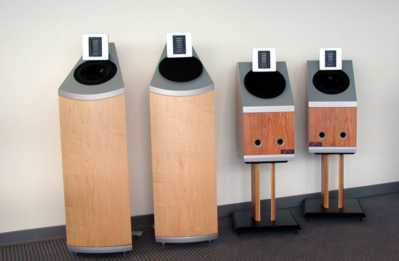

Precide Heil clone with better dynamics and MT blending

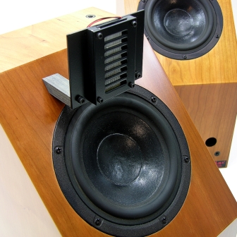

For the last ten years, two Precide models (pictures) have been my main speakers.
I have also used a REL sub for bass extension.
I absolutely love the dipole AMT tweeter: clean and dynamic HF and big soundstage.
However, I don't like the midbass dynamics and mid-tweeter blending.
Drivers are physically very close, and yet I can still hear the two different sources.
Since there aren't many similar commercial speakers, I have been trying to DIY a better design.
First I built fully open baffled prototypes. I could not get enough bass passively, so I bought a miniDSP. With active, I found that most drivers can't handle the EQ needed for full OB. Now I gave up on full OB.
My next project is to revisit Precide design and try to improve the midbass dynamics.
Tweeter will be exactly same configuration: Precide AMT or B&G Neo8s, dipole and naked (no baffle).
MT crossover will also remain around 1000Hz (active).
I will use a bigger, more dynamic and more efficient midbass driver,
preferably in a 30-40L sealed box (Precide cabinets are ported).
I will then highpass the midbass around 80-100Hz and add a large PA style subwoofer in a seperate BR cabinet (single 18" or dual 15").
Midbass driver can be 45 degrees tilted as in Precides, or direct radiating. I am open to suggestions.
I do not know much about boxed speaker design, please help me with this build.

I could be wrong, but I don't think it will work-out for you. 😱
Some people are just more sensitive to low vertical dispersion.
You can however *alter* the dispersion pattern, but it will alter the freq. response and overall efficiency of the Heil-type or Neo 8.
For altering vertical directivity:
Utilize the "foam" method of the larger RAAL's. google "ppi foam" and purchase a range of samples/ppi over 30 ppi that you can cut into those foam wedges. (..the higher the rating the more dense the foam, the greater the attenuation.)
Try the technique not only on the front, but also the front and back.. to see if one method is more preferable. (..I'm assuming you have measurement capability here with the minidsp.)
As to the driver, the more efficient the better. 8 db of sound pressure loss in a radial format is common (depending on baffle diffraction), and much more so if it's in the range (higher freq.) where the driver becomes more directive. (..which is why the Precide designs you've shown aren't full radials, but are rather slanted toward the listener somewhat.)
Low mass is desired, as is a high Qts for efficiency with respect to the lower mid-band and upper bass:

Pictured speakers are intrinsically poor design; At low frequency they are effectively monopole, at crossover frequency they are briefly cardioid, and then continue to become dipole. In short polar pattern is a mess. This is very good reason why few commercial designs exist.
Your own observations of hearing speakers as two different sources with poor blending is exactly what any commercial designer would encounter. Do what they would: abandon it. Whole design is showcase for tweeter. Tweeter appears to have plenty of potential, but not as pictured.
Ten years is much too long.
Consistent feature across all top ranked speaker designs for domestic listening is smooth, wide, and uniform radiation pattern.
