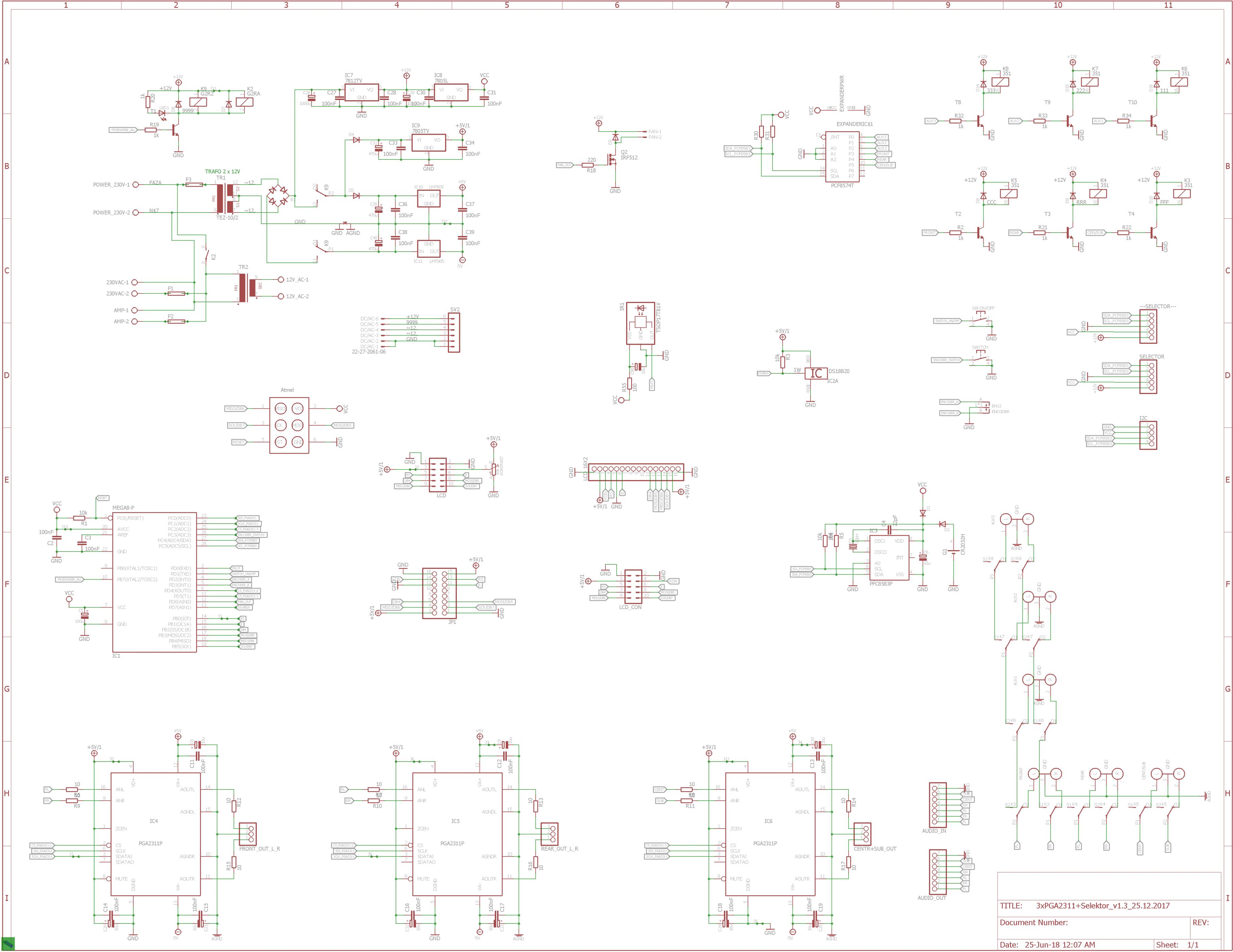

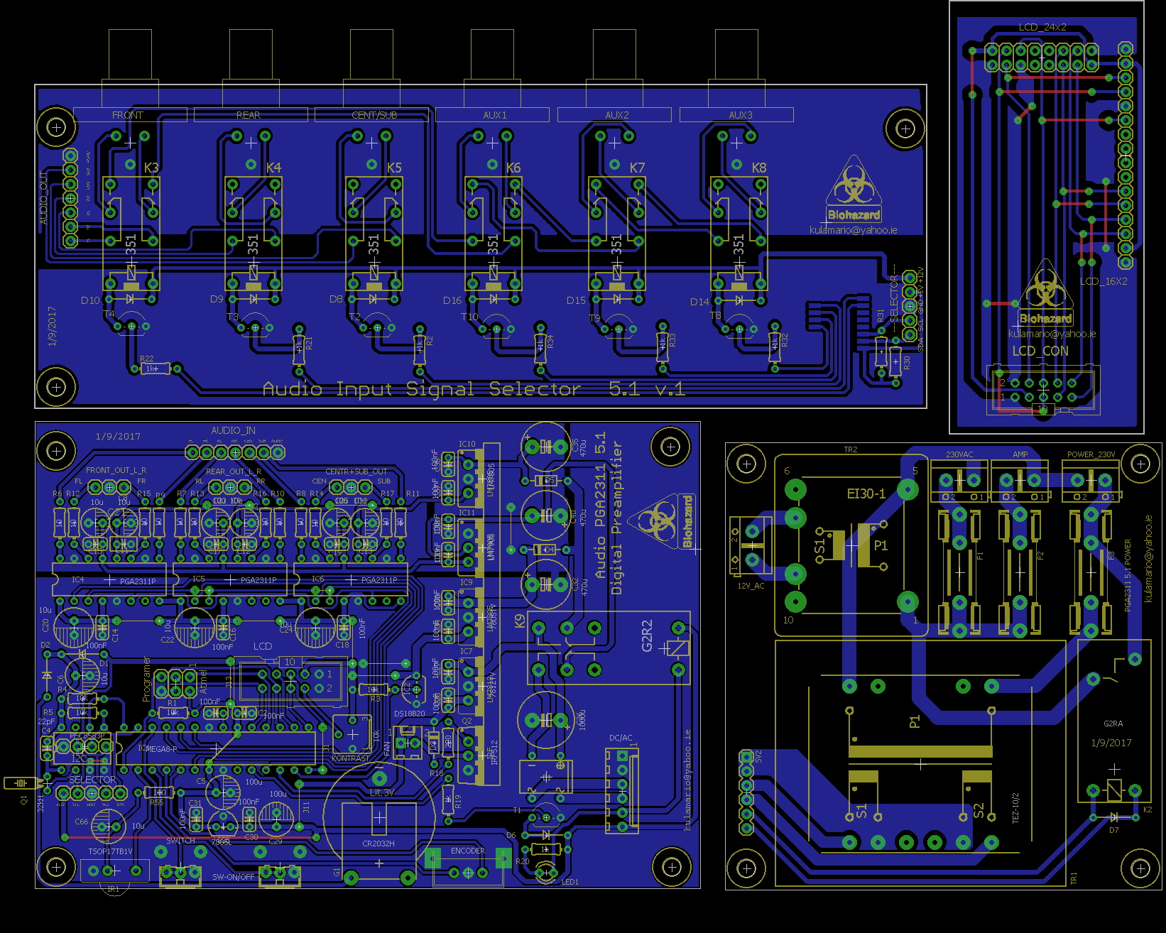

Hello
After a long time I decided to upgrade my project to 3 x PGA2311 5.1
It adds a short description
Description of functionality:
- Volume adjustment -95.5dB to + 31.5dB with a step of 0.5dB
- Volume control with remote control and encoder
- Balance adjustment of all channels independently (remote control and encoder control)
- Mute function (remote control)
-ON / OFF (remote control and switch control)
- Memorizing settings after switching off
- Real time clock + date based on PCF8583
-Temperature thermal protection, eg fans for cooling power amplifiers based on DS18B20
- Compact design, which also allows you to freely apply in an existing amplifier.
- Cooperation with popular 2x16 and 2x24 characters, with a driver compatible with HD44780.
-Two Relay Outputs enabling power transformer transformer power supply and speaker or color protection
- A separate power supply board
- RC5 pilot (each Philips)
-LED signaling ON / OFF
Added features:

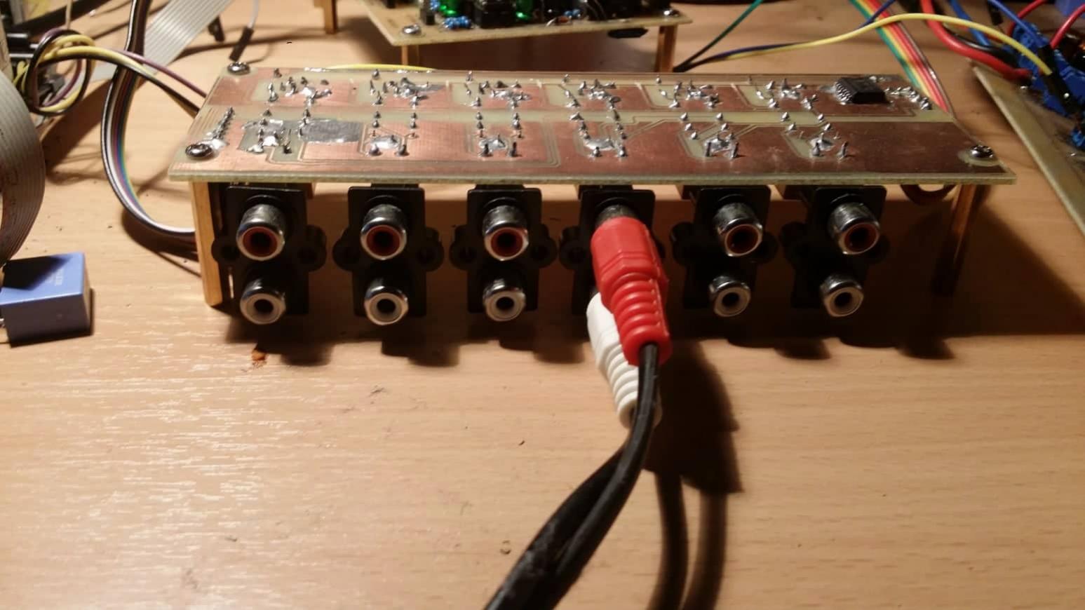

- I2c controlled input audio on PCF8574 (3 stereo + 5.1 inputs)
YouTube
The system is tested and tested, I have one ready without the selector in the amplifier, probably the fifth year and the second with the selector on the table for some 3 - 4 months
I am waiting for your opinions
