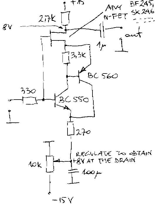

Hej
as I am in love in the triplet of the transistors that peufeu has discovered, please try this single ended design.
To minimise "memory distortion" (or as do we wish to call them?) the transistors work at constant power.
The gain is slightly less than 10 times.
The sound is very smooth and detailed.
Please extremely care to use good quaality capacitors.
You can use positive rail up to 30V and negative only -5V as well.
This is the schematic of working circuit.

Right, I built it. It was a bit of a disappointment. Not as much detail as I had with just the buffer, not as much bass control, although there was an improvement in dynamics. The big problem however is that it starts to clip at about 2/3 volume (not very loud, BTW) and distortion sets in from before that point (probably why the detail is muddied). I tried feeding my buffer from it with sonically pleasing results, but the clipping and the distortion were not in any way improved. I tried bigger values of input resistor, but of course all that meant was that I had to open my attenuator up more to get back to the same output volume and clipping set in at about the same loudness as before.
I suspect that the input impedance of this stage is not high enough for my DAC to drive comfortably. I don't know how to alter this, apart from building a completely different design (possibly something with a J-fet input instead of a BJT.)
In the meantime, I have built an opamp input/gain stage (OPA637BP) and it is feeding my buffer. After some tweaking, it is sounding pretty good, but I would still like to build a solid state input/gain stage. Any suggestions anyone?
I would like to be sure that the input of this preamp was connected to the middle of the input potentiometer?
The input impedance is high, it is lowered by a potentiometer connected at the input (not shown on the schematic). The potentiometer should be > or = 47 kOhm.
in such a configuration you should get at the output at about +-10V~pp before clipping what may kill your amplifier!
the output impedance is not so low but I connected AKG55 (30 Ohm) and listened the music without clipping!
please send your exact configuration that you used during listening, maybe is there any mistake in the configuration?

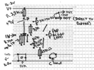

Hi padamiecki,
I am feeding from a stepped attenuator (50k I think - can't remember - so long since I built it. I don't think there is any problem there, since the volume is correct and also I have tried a number of pre-amps in exactly the same way. From the pre, the output goes to my active crossover.
I don't think the output impedence is a factor, since I am connecting it to a buffer (with output cap to block DC). I can't see any mistakes in my build, but then perhaps there is something I didn't pick up in the (rather poor quality) picture. I would be very happy if it is something like that. I will draw it for you exactly as I built it, but a bit later. (Right now I got to go do some work.)
thanx for the support.
William.
hihopes said:
Hey padamiecki, are you still there? I posted my design as you reaqested, but now I am not hearing from you any more.
William!
It is hard to me estimate if this circuit is well built? Looks that it is OK built.
The schematic is so neat that it is hard to build it wrong...
could you measure at which output voltage clipping occurs?
anyway, for most of the amplifiers 0,775V~ at the input is enough to get max power at the output.
using any preamp you should turn volume pot in the amplifier at max and regulate volume with a pot at the input of the preamp.
this guaranties minimal distortion.
