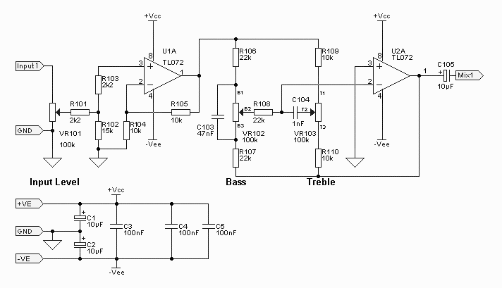

Hello there,
Here's the schematic for my new preamp. It will feed an LM3876 amp. According to TI, I can substitute an OPA2132 for the TL072 if I choose to. I'll be breadboarding it an then we'll see what it sound like. All comments, constructive criticisms, etc. are gratefully appreciated, as I'm an amateur at this. Everything on here has bee copied off several sites, so I don't think there will be problems. You can see the power supply on the LM3876 PowerSupply thread I posted in the appropriate sub-forum.

The gain pot looks a little odd, too.
Speaking of which, consider moving that behind the tone control, which will no doubt be relatively noisy. (No need to spoil the LM's good noise performance.) A 10k type will do fine then, it should be low enough to be usable in the amp input and not too low for the modest load driving capabilities of a 072.

You haven't seen the amp schematic yet, 'cause I don't have it up on this thread yet. But there is a 10k pot between the preamp and the amp. It may look odd, but then, so do I😉 All the downloads I did of similar units had both, so that's the way I drew it. Being a novice, I don't really know why both of these are there. So if you can enlighten me it will be appreciated.

Yuor gain pot doesn't do anything than short the input at its top setting.
your input impedance is far too low for a passive bass guitar and you
will lose all the top end etc .....
Its very wrong and very uninspiring. You'd be far better off finding a
decent bass pre-amp schematic or copying the pre-amp section
from the service manual of a good bass amplifier.
The fact you asking Why ? is why you need to do a lot more learning.

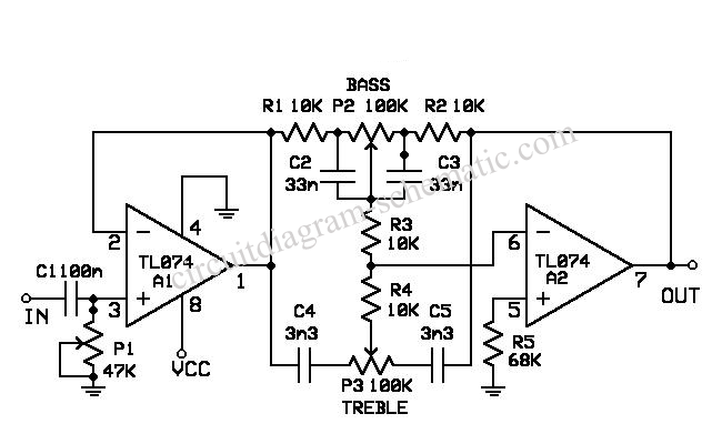

Why don't you google for schematics of commercial bass guitar amps to get a feeling for the gains and input impedances that are typical? It is also recommendable to determine a frequency for the treble control, where your electric bass guitar still produces sound.
Hi the pre-http://sound.westhost.com/project27.htmamplifier stages you have found are not really suitable for guitars. This site has a solid state preamp and power amplifier for a guitar and a good description of the reasons for the design choices.
You could use a chip amp to replace the amplifier design although my experience of chip amplifiers is they have poor saturation characteristics so if you are expecting to use overdrive in the power amplifier for a rock effect it is likely to sound nasty. By looking at it it appears that the pre-amplifier has an overdrive type circuit in it (the diodes in the second stage) but I haven't read it in full or evaluated the circuit.
