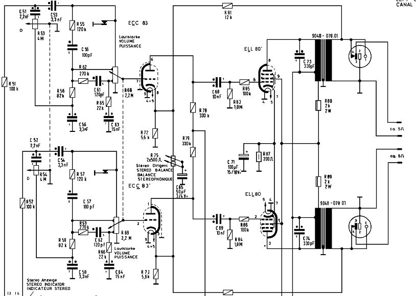

I have a few single 12AX7/ECC83 tubes from various manufacturers, so I was wondering if there are any good designs than use only one single tube for a stereo preamp. I don't need a lot of gain, if any, just a simple circuit with one triode system per channel.
A search didn't bring up much, and the only circuit I know of that does use a single 12AX7/ECC83 for stereo is the Grundig CS200 tuner's output stage. There must be more. I attached a pic of said output stage and the pdf with the full circuit.
Can anyone point me to other schematics using a single 12AX7/ECC83 for a stereo preamp?

Low gain and single ECC83 do not go together too well, as it is a high gain valve. There are basically two ways to get low gain from this valve:
1. use a low anode load, and accept the distortion you get - maybe OK for a guitar effects box.
2. use lots of negative feedback, so you will get low distortion until you get near the clipping threshold - a carefully designed anode follower might work quite well.

It also depends of your amplifier.. If it have low input impedance, you may need buffer, so it means one double-triode per channel.
I don't think that the amp's input impedance will be a problem, my mini Aleph has around 220k I'd guess.
Distortion I can live with, since I'm simply looking for a fun project for these unpaired 12AX7 tubes.
I'll dig out some tube literature, maybe I can cook up something...

With high output impedance this is a good example of how not to design a line stage. Simply changing the cathode resistor to change gain is rather crude, as it will also significantly change the bias point - with a range from 100 to 8.2k they can't all be near optimum. Omitting C5 gives a little cross-talk between channels.
I don't quite get the logic of single tube. Is it because you don't have pairs of tubes from the same manufacturer? You can do multiple tubes with each tube doing left and right rather than separate tubes for each channel.

You need to use two triode halves. With only one, your specification can not fulfilled.
First triode could be normal voltage amplifying stage and the other cathode follower.
The gain and low output impedance can be achieved with negative feedback from the cathode follower to the grid of first triode.
