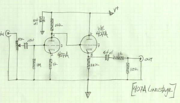

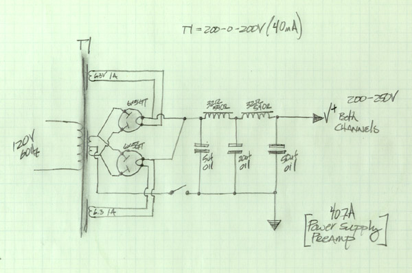

What do you guyz think? I nice little preamp using the WE407A. The schematic came from Gark K. Anyway the power supply is mine. I had the power transformer with double 6.3V 1A rectifier filaments. So why not double rectifier for a little gain in power.

Circuit looks fine to me, I guess the 407 works a bit like a 12AU7 eh? (Darnit why am I always comparing tubes to the AU. LOL)
I don't get the 1k on the output though.
PS schem?

Ah, there it is 😛 What diodes are those? 6X5?? Can't read the chokes well either.
PS schem?

6X5's arent directly heated. you can use the same filament supply for them as for everything else
...You have what looks like a 10uf cap at the top of the first triode's anode 22k resistor connecting to HT+, and this looks like it connects across the last 50uf cap in the power supply.
Is this because the pre-amp is remote from the power supply and you need the 10uf cap to prevent instability, or is there a decoupling resistor missing for the circuit diagram?

Just two suggestions: remove the .47uF cap from the input - it's unnecessary. Also, two 6X5's for a preamp circuit is overkill. Why waste electricity?
I can't read the choke values, but I assume they are at least 10-15 henries? Then the cap values are good.

Hi, the tube for rectifier if use 80, EZ80 or we417a will better than 6X5.

Actually, no. And I'll tell you why - different rectifiers will each behave differently in the same circuit. They have different internal resistances, capacitances, and different choke/cap input-to-filter requirements. Doing a direct swap would produce a noticable difference because of all these factors - but that's not due to any "sound" of the rectifier itself.
A true test would be to build a complete PSU for each rect type. Adjust all circuit values so each PSU has the same level of ripple, output voltage, and regulation. Listen.

Basically I am using the 6x5 because I have a few just sitting around. And they should make a good preamp rectifier The choke are 32H 40ma, I also have these. Basically I have all the components sitting around.

Why must the output cap be oil? Is everyone really in love with the oil sound or is it just used as digital antidote?

Hmmm, I can't seem to find anyone mentioning PIO caps as a coupling device here...must have missed it.
