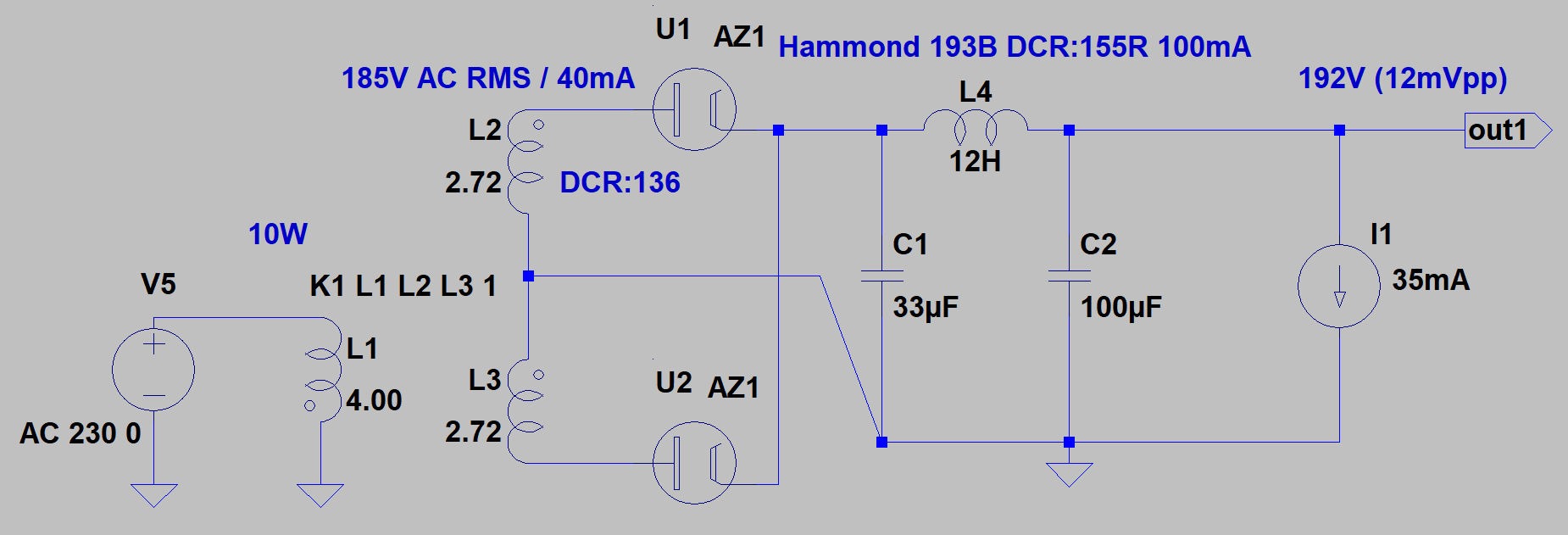

Dear All.
I'm working around the power supply of a tube preamp i build.
I started using one transformer i had un my hands,with a 0-125 secondary...so everything was calculated considering it.
The PSU had a CLCLC filter.
So far i realized that the transformer was undersized...after some hours became very hot.
So i'm using now a 185 0 185 transformer.
To avoid to change the working point of the tubes i was obliged to add an RC cell.
What's the best configuration in your opinion?
CRC L C L C..
Or..
CLC RC LC
Many thanks in advance.
Maurizio

I guess the answer depends on what raw B+ voltage you're starting with.
370VCT ? (That's 185V-0-185V).
The raw DC voltage will probably be something like 185(1.3) = 240V DC.
To get down to 165V DC you'll need to drop 75V.
75V voltage drop with 0.035A current draw would require a series resistance of 2,143 ohms.
What is the DC resistance of your power supply choke?
Will you be using a tube rectifier? If so, a which one? 5Y3GT? 6X4/EZ90? Each different type will have a different voltage drop.
A 5Y3GT will probably drop about 30V, so you'd need to drop another 45V across the LC and RC sections.
Remember, you can't put too large a value of reservoir capacitor after a tube rectifier without the rectifier burning out prematurely from large current spikes at power-on. Typically, only a 22uF cap is used after a 5Y3GT. Going with a higher value capacitor will overstress the rectifier tube.
Silicon rectifiers can withstand much larger current surges, so you can use larger value capacitors with silicon.
My first instinct would be to use the CLC first (right after the rectifier), then add RC sections to drop the voltage and filter out ripple.
Multiple RC sections will be more effective at reducing ripple than one big resistor and capacitor (RC, so CLCRC).
So perhaps CLCRCRC, or something like that.
The smaller the values of resistance and the larger the values of capacitance, the better (for lower PSU output impedance).
Of course the best solution would be a regulated B+ supply.

Ciao.
I've two 5H inductances with a dc resistace of 70 ohm..and one 6H with a resistance of 220 ohm.
I will not use tube rectifiers but two silion dioded.
First idea i tested on PSUD is based on 47Uf..2.4k resistor..220Uf...6H..220Uf..plus 10uf and 1F pp caps .
I could try a CLCL at the beginning and several RC to reduce voltage and ripple...what do you think?

Good Morning .
I made some test by my own.
I tested one PSU with a CLCLC stage followed by two RC stages to reduce the voltage. I realized that one small hum issue i'd already on the right channer became worst..not that bad..but just increased..
Because the Main transformer doesn't have any electrostatic shield..i assumed that on of inductance was influenced by some magnetic fied.
As second step..i used a CRCLCRC filter...and the hum on the right channel decreased...
The inductance i used is different as well..is a new one with a 6H value.
The others have 5H...and some years...i do not know if they have some problems caused by the storage.
