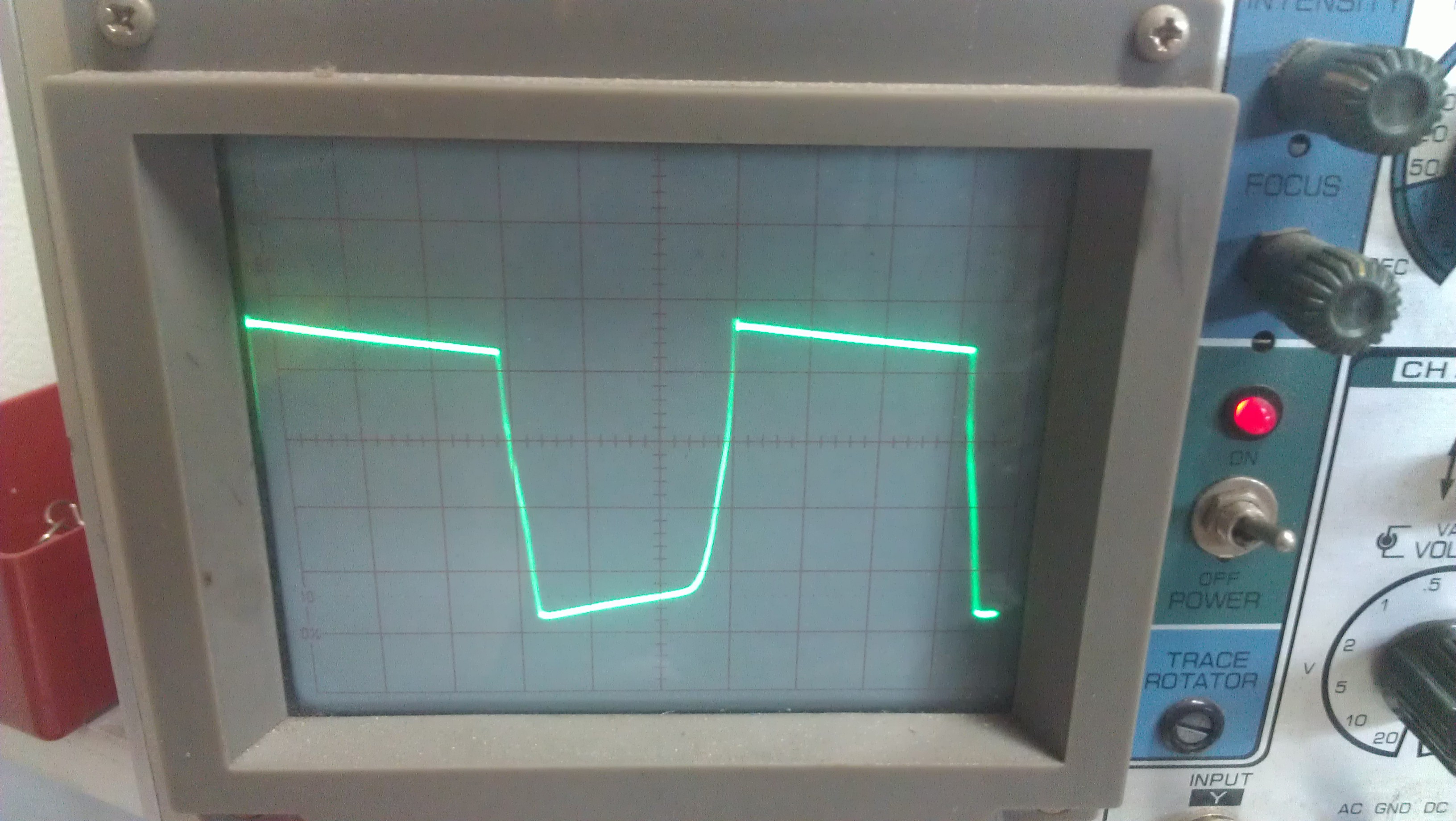

Does the B+ to the plate of a 12AX7 affect it's "headroom", voltage swing, ability to amplify without clipping? Tube data sheet allow up to 250 VDC. I currently only have about 100 volts, going then thru the standard 100K load resistor. Am getting more clipping than I'd like. Don't want to change the 100K, but can lower the power supply dropping resistor to raise it. Should I increase it, then look at the cathode biasing? Thanks!

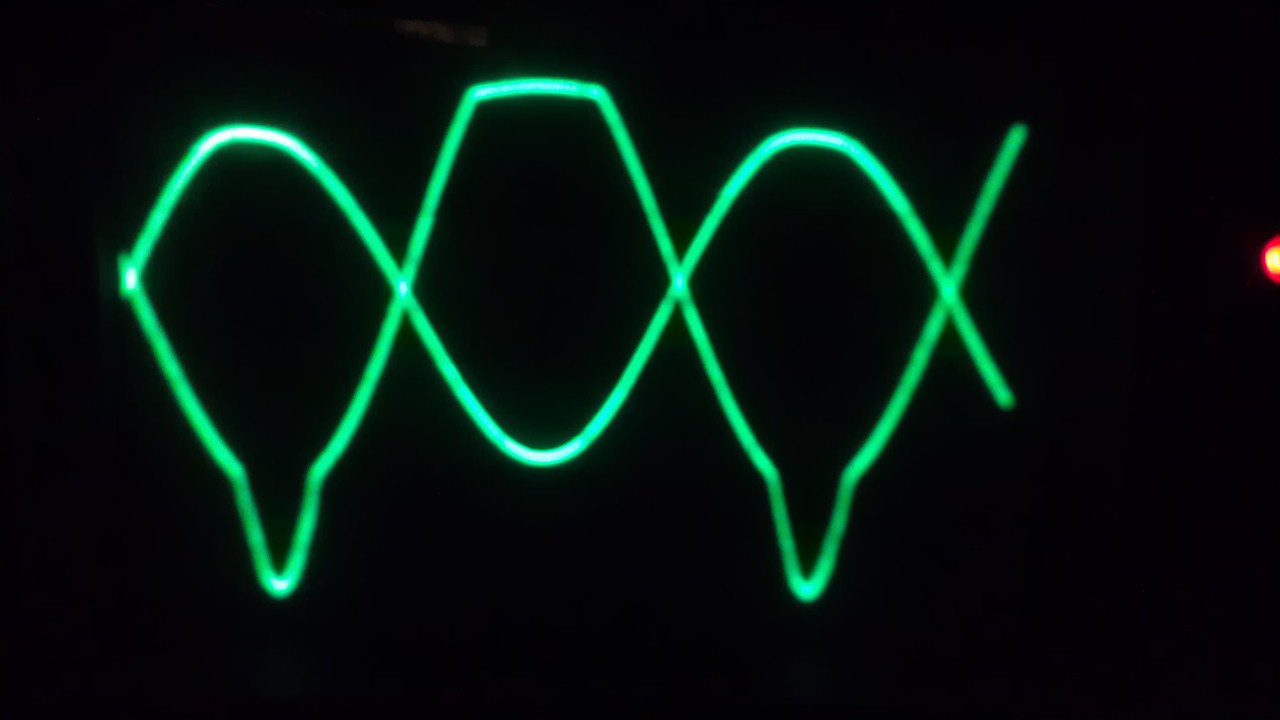

Great comments and questions! Firstly, I make sure my SigGen is putting out at guitar level. Secondly, yes I am getting very mild clipping from the second gain stage (after the first gain pot). Have a 5E3 on a breadboard (and a couple related posts on this forum describing my exploits), so have added gain pots before the PI gain stage (pin2) and (most recently) another gain pot before the PI itself (pin7). Added a PI grid stopper pot, some help. But I DID boost the preamp tube (first 2 stages of gain) from 96-140 VDC, and it helped. This is all with a pair of 6Y6s (very different than the JJ 6V6s I started with), and have rewired and added components to accomodate it's requirements. Got it to work reasonably well (sounded better on guitar than it looked on the scope!). My goal was to gather data on these tubes for the future (can get 12W diss per tube with only 240 plate volts!). Then I will concentrate on getting the PI working correctly. Too many variables and I can't tell what's doing what. Thanks again.

100V B+ is way too low for 12AX7.
Yes it will clip early but you will run into problems with grid current before that (It will be noisy with an unpleasant tone)
Ideal anode voltage is in the range of 1/2 to 2/3 of B+ and in any case not less than say 140V for a low current stage (Less than 0.5mA) and not less than 180V for a higher current (approx 1mA) stage.
As a really rough rule of thumb that first "less than 0.5mA" will have a cathode resistor of 2K7 or higher, the 1mA would have a cathode resistor of around 1K5 or lower.
Lower the B+ dropping resistor to the stage to restore B+. With a typical 10uF power supply decoupling/bypass capacitor, you only need a couple volts drop across a B+ dropping resistor for it to do its job of decoupling the supply.

Thank you Arctic Breeze (and FMB and Jazbo). Pointing me in the right direction. My breadboard now stays clean up to about 75% overall gain. Found my 5K B+ dropping resistor (to screen) was 7.0K.... but dropped it to 3.47K, screen went from 300 to 330V (screen current 11 mA), dropped "22K" (I was using a 16K) to 10.9K, raised the 3 gain stg plates from 103 to 132V (current to the 4 triodes 5.4 mA). the 3 B+s are now 369/330/270, my 6V6s are 362/330/20.6 (Vp,Vs,Vk). I know the dropping resistor are way below 5E3 values, but needed to get the voltages up, and the currents seem fine (no shorting going on anywhere). My PI is 202/70 (plate/cathode) - right where Mockingbird calc'd it at. Why do you say I have 6 triodes? I have 3 gain stages, 1 PI stage, and two 6V6s....(4 tubes ttl). Oh, and a 1M pot in front of PI pin7 (replacing the 5E3 1M resistor) is set at 750K (big stopper). I'm liking where it's at now... maybe can now start tweaking the bias (scope shows assymetric clipping - want to play with that). Thanks again!
