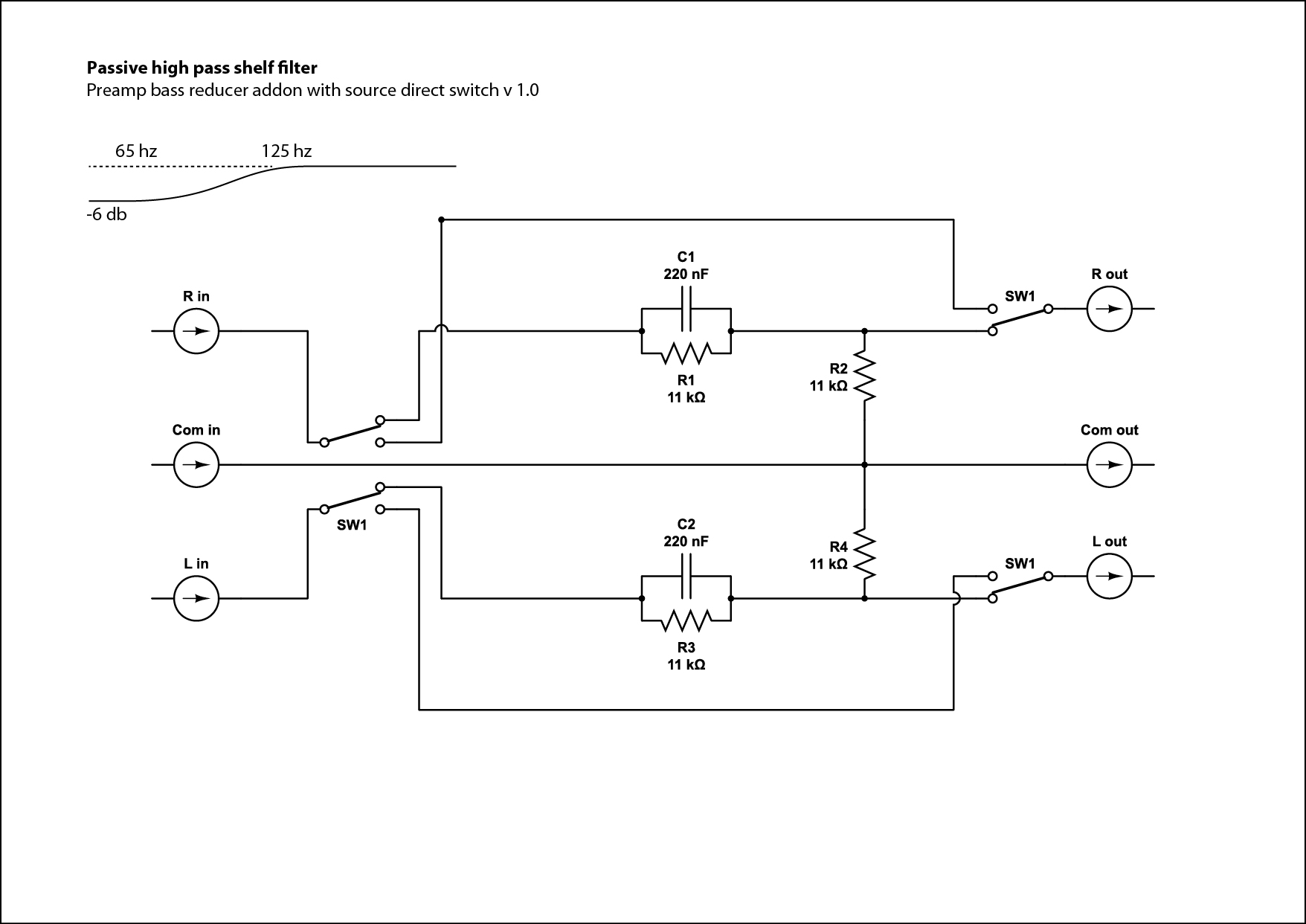

I've been looking for an easy, quick way of reducing bass amount when watching/listening late at night. I don't need an eq or full tone controls, just a switch that activates a fixed high pass filter. Problem is I want the signal completely untouched when the filter is bypassed (aka source direct on some systems).
I came up with this schematic for a simple circuit to build into my preamp. I'm worried that even when the filter is bypassed the R and L channels will still be connected to common ground through R2 and R4, thus "touched". Even if I cut the ground as well with a 3-pole switch, R and L are still connected to ground via the connectors in the output end. See red markings. Do I need to find a 4-pole switch to cut R and L in both the input and output ends? Or would you consider the bypassed signal "untouched" in this scematic?
I'm planning to put the filter after the amp section, directly before the output to powered speakers.

I don't have any way to measure output / input impedance at this moment, but let's assume they are fairly matched. How can I design the filter to not increase the pre's input impedance when bypassed? (When activated it will of course, since it's passive.)
would a 4-pole switch do it? Like this (all SW1 switches are assumed the same physical panel mount switch)
Either use a 4-pole switch, or just switch the output side - assuming the source is happy to drive the load presented by the circuit.

You're over-thinking this too much.
You really should measure (or find out) the input resistance of your power amp and output resistance of your preamp. Once you know the power amp input resistance you can get rid of R2(R4) and scale the values of C1/R1(C2/R3) to provide the shelf you're looking for. Then just put a switch across the combination to disable/enable the filter.

Unless your power amp has quite a low input impedance then omitting R2 etc. may increase noise. Whether this would be noticeable depends on many factors.
Well, yeah. If the input resistance is 470k then probably not a good approach.
But what if the input resistance of the amp is 10k?
My point echoes Andrew's....you really need to know the amp/preamp parameters. Not being able to measure or find out just doesn't cut it.

Hmm. This may be a little off topic, but, how do I know that my source, pre, and power (active speakers) aren't already completely unmatched for each other. I never measured them, didn't look at the specs, didn't knew about input/output impedance when I bought them (except at speaker level). They sound good though. The preamp is a diy project from China wich currently is disconnected. Argon DAC1 to active Audioengine 5. I just found out that the A5 has an input impedance spec of 10k. The DAC's specs doesn't say - isn't that strange, since it lists dac-chip, OP-amp, and even comes with a small torx driver in case you are curious to see how it looks inside...

A 10k input resistance fits nicely with your proposed circuit above. Just get rid of R2 and R4 in your circuit since the 10k input resistance of your A5 becomes R2/R4.
You can enable/disable the filter by attaching a switch across the RC combination.

10k input impedance is low, but ideal for this purpose.
