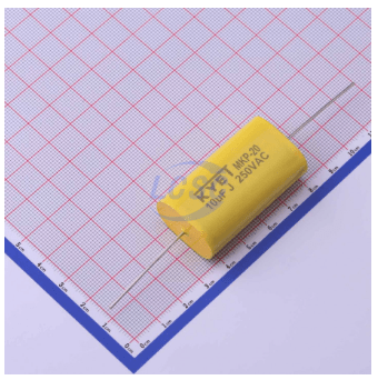

Non-polarized electrolytic , 10uf maybe ? I am not sure about this .
Start with whatever small film cap you have as proof of concept. 10µF is a good guess. Go film if you can. All electros leak to some degree.
I use these in my tube amps and they haven't disappointed. Or you can get something from Cornell for 10x the money.
https://lcsc.com/product-detail/Pol...ors-CBB_KYET-MKP20106J2EAC461625_C521055.html
