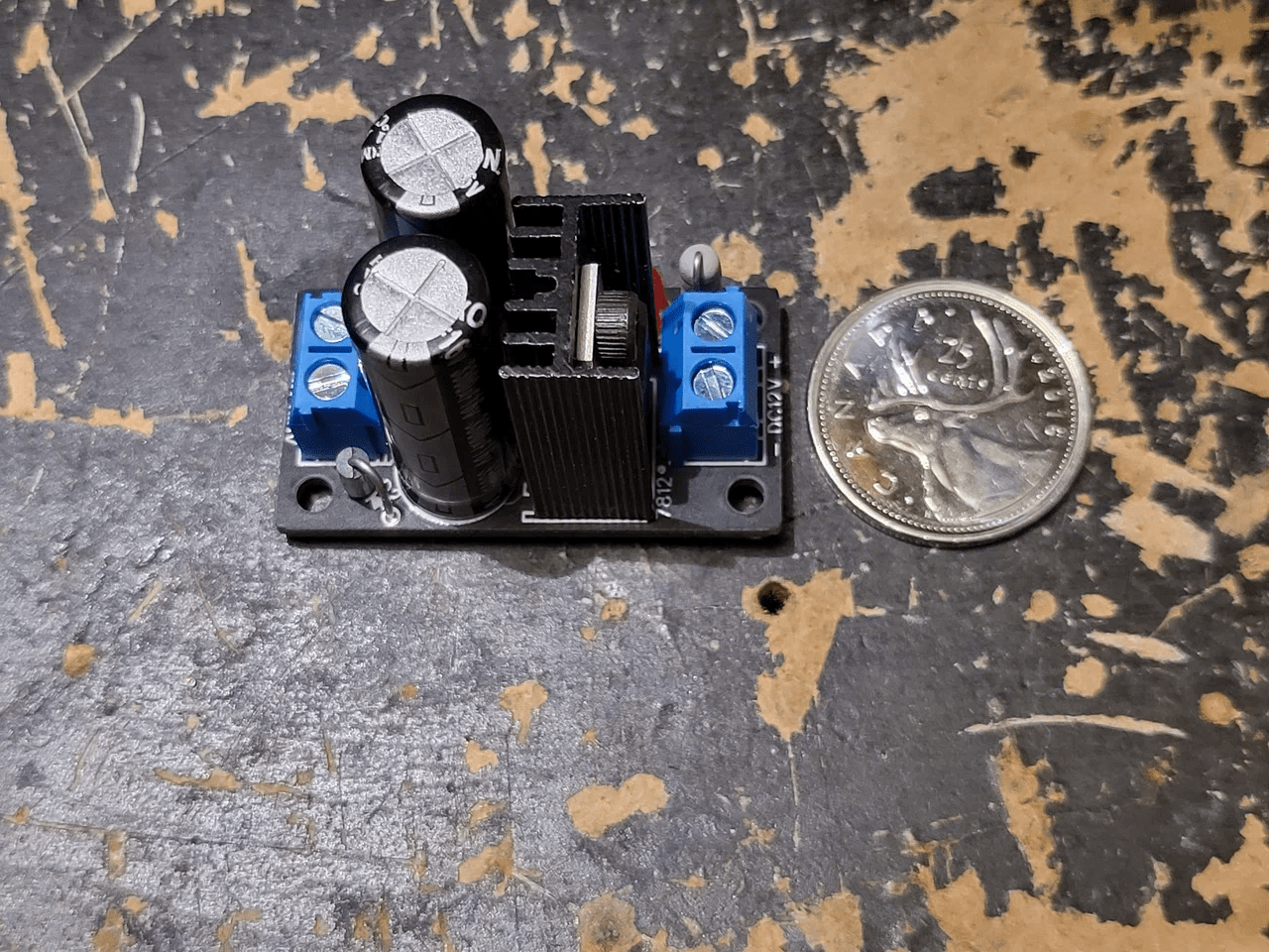

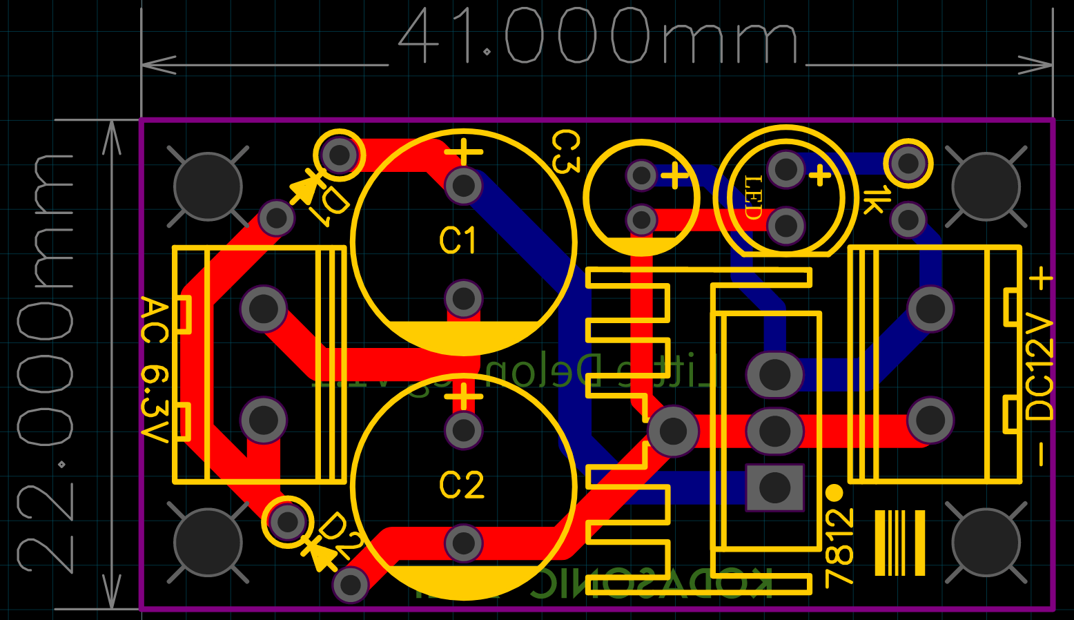

If you have 6.3V AC somewhere, I have a little board that will turn it into 12VDC for you.
Lemme know if you're interested... 5$ for a complete plus post.
I always have 6.3VAC somewhere... I could use a couple of these little boards. Looks nice.
$5 + post for... complete? Not sure what that means. Would that be for the bare PCB?
