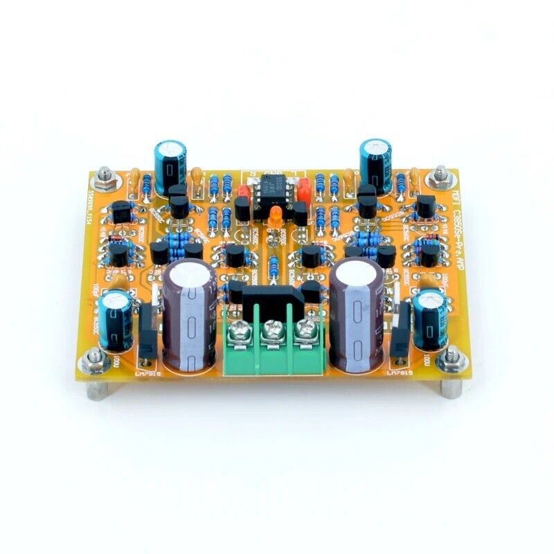

Hey guys sorry if this is the wrong forum but I have a simple pre amp using 2 ne5532s hooked up to a tda7498e 2 channel BTL board. The preamp works without the power ground connected I'm assuming because the audio signal ground and power ground are tied together on the preamp. I have run into this problem before but don't know what I can do about it? I actually blew up one of my tda7498e boards hooking up an accuphase 3850 clone preamp last week.

The preamp has a bridge rectifier and lm7815 and lm7915 on it. Also the preamps power and signal grounds are connected together. The diodes in the diagram were just being used to split the single power supply to make a virtual ground.
I have since ordered a SMPS that provides 12 0 12 dc that's isolated. I will have to modify it's feedback network to boost it's voltage to around 18 0 18 for it to work with the preamp since it has 15v linear regulators on it. I'm just concerned about frying another amp since it doesn't make sense to me how the first one fried. I figured it has something to do with the preamp sharing power and audio grounds and maybe the preamp somehow sent power into the amp via the audio input but it has DC blocking caps. I guess I must have hooked something up wrong in which case I'll never know what happened.
I have one of those accuphase clone kits. The power is supposed to be supplied with a 30VCT transformer (15V - 0 - 15V) with center tap tied to preamp ground. The pre-amp has a bridge rectifier already. The two diodes are not splitting the supply- as drawn, they are forming a half-wave rectifier. Assuming the 16V is an RMS reading, the result is 22V from the positive output to the negative output, and the two 10K resistors are forming a virtual ground putting +11V above and -11V below. You could eliminate all of that and just put the two resistors on the pre-amp board and run the two secondary wires to the + and - power inputs. This is not a really good solution though, as any imbalance in load between the two supplies will cause the virtual ground to not be centered. A much better solution is to use a center tapped transformer.

No idea. That sucks. Given the amp's input coupling caps, and the transformer isolating the pre-amp and power-amp supplies, you should have been able to connect signal ground to power ground and connect the grounds between the pre-amp and power amp and had no problems. Since your new switching supply for the pre-amp is already putting out regulated DC (I assume it's +12V - 0 - -12V) it just needs filtering. The pre-amp will run just fine on that, no need to hack the SMPS, just remove each linear regulator, connect it's input to the output and put a 0.1uF ceramic from that to ground for good measure. Hacking the sense network in the SMPS should be easy too, and the extra regulation would be good since they do tend to put out a lot of ripple.
