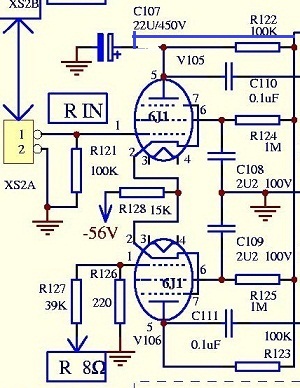

Due to a poor quality of the preamp in my Chinese integrated PP amplifier I would like to modify this stage. I have to admit I'm not a valve expert, just starting with this and I have some issues regarding the circuit I "designed”. The original input stage with inverter is based on a differential amplifier (attached pre_old.jpg) and it’s using two EF95 pentodes tubes. AFAIK this scheme is burdened with some drawbacks and it’s far from a perfect one. Main assumption of my modification leaves the existing B7G heptal base, there are two sockets per channel available.

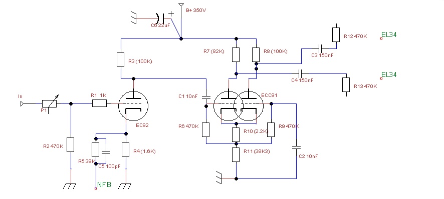

My new preamp stage is described in two section:
1 –as an input was chosen a EC92 triode (exactly half of a ECC81) in a circuit of an anode load without a cathode bypass cap
2 –the Long-Tailed Pair phase splitter, this cathode coupled inverter is based on a ECC91 - twin triode with common cathode

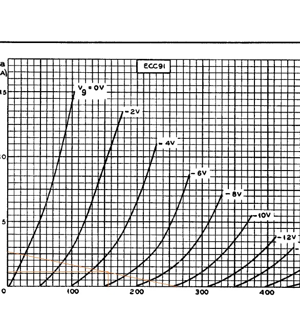

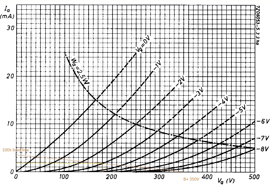

This following stage has a quite high gain, if I’m not mistaken 41 and 13, but I am not sure if it have enough gain to swing a EL34 pentode in the PP output stage, regarding that, I don’t know how deep a negative feedback is, I only know NFB resistor value (39k). So what do you think my circuit? Can it improve an overall sound quality of this amp? Maybe some other circuit, other tubes (B7G)? Please let me know your opinion,the original preamp and my circuit schemes attached, my load lines of two triodes also – resistors and caps values verification would be greatly appreciated.

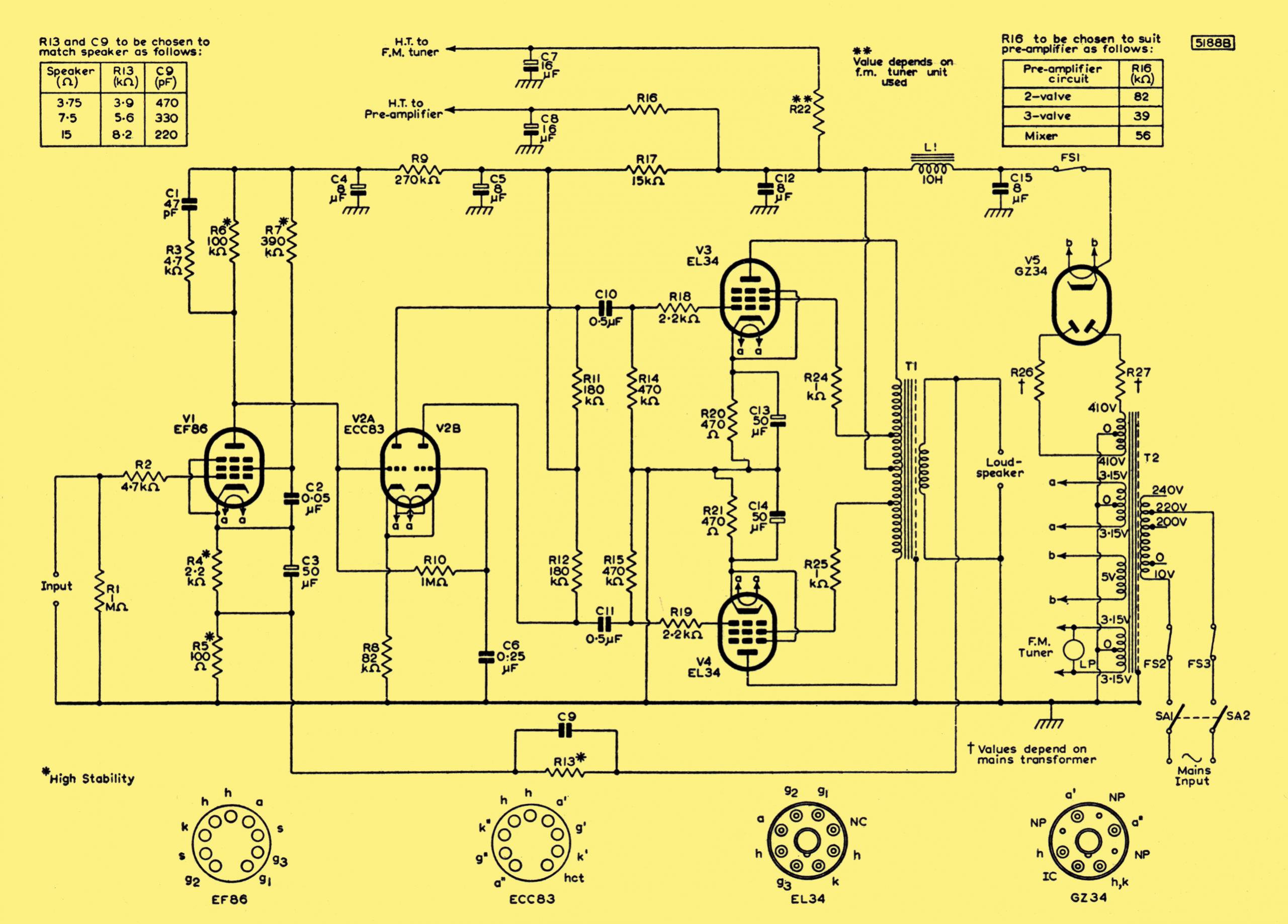

Why not use "classic" Mullard style circuitry, which DC couples the voltage gain tube to the LTP. Put a 10M45S constant current sink in the tail of the LTP and force symmetry between the 2 sides. The 6GK5, an outstanding combination of high μ, high gm, and low RP gets my nod for the voltage amplifier job. The 6J6/ECC91 was "born" to be used in a LTP. 😀
