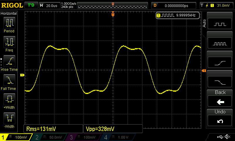

Impulse and steps are directed at digital circuits to elucidate some information about them. They are useful as a test only. No music signal is remotely like an impulse. Ergo pre-ringing is a theoretical concept and is not heard.
And no - a cymbol crash, drum hit, rifle shot are not impulse signals either.
If you FFT a square wave signal you get harmonics 1,3,5,7,9 etc to how however many you want to analyse too. So a 10Khz square wave is unreproducable as even the 3rd harmonic exceeds the bandwidth of a listenable signal

I think the point you're making is these test signals don't really describe the audio music we hear. If that's your point, I really agree, and I'm heavily into testing !
That's the whole reason I'm asking 'who has heard pre-ringing'...for themselves and under what conditions.
For grins to support what you said, I've attached your 10kHz square wave example,... an o'scope grab i just made, sig generator though a good RME soundcard
