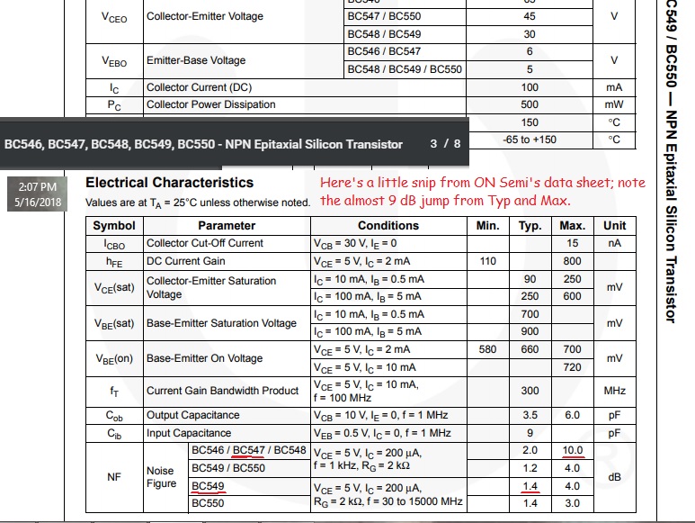

Also not all BC549 are created equal. Some (like the siemens datasheet I downloaded from datasheetcatalog) have no noise spec. Fairchild is showing 1.2 db noise on datasheet I downloaded last week from farnell.

A) a couple of BC549C's for the 2nd stages would probably have the best potential; note the almost 9 dB difference between the Typ value of the 549, and the Max value of the 547; BC550C slightly better still, and with a much better Vce safety margin for use in a circuit with 24V supply
