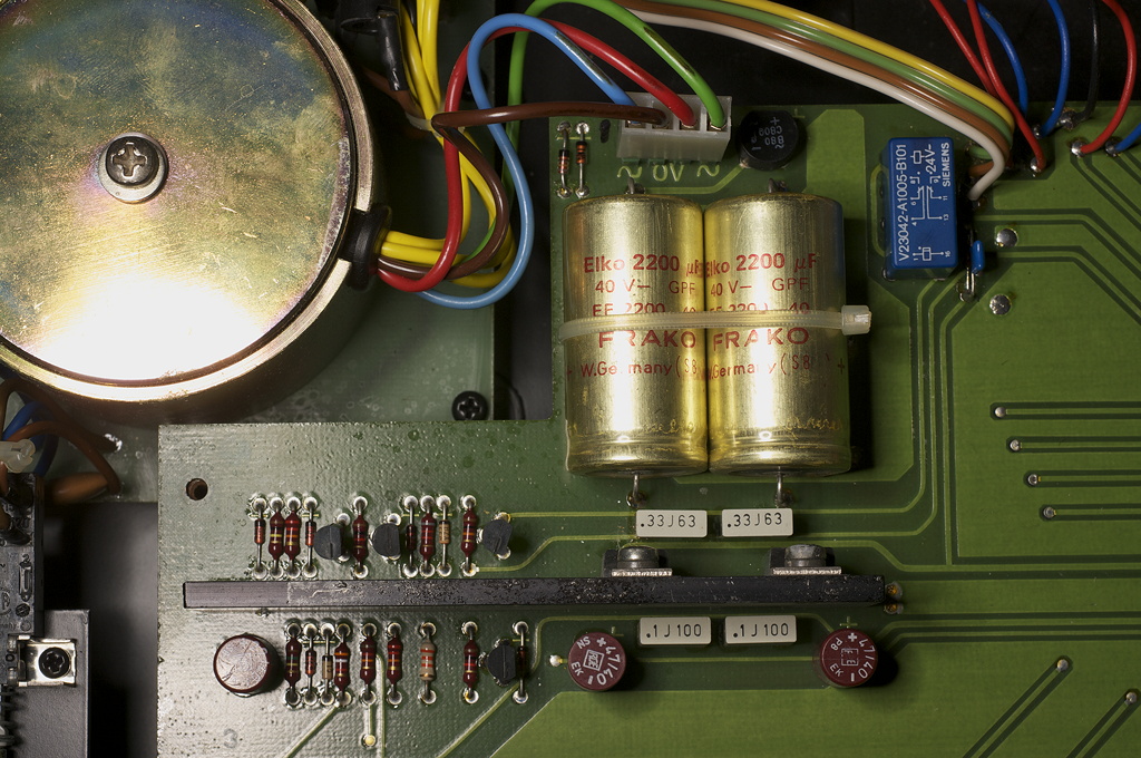

My trusted Canton EC-P1 preamp seemingly dies a week ago. It started with the intermittend loss of the right channel. When I put some pressure on the rca connector borad from the outside, the channel came back to life. After a couple more days, the Canton went dead fully, no signal, neither on the rca-outputs nor through the headphone jack.

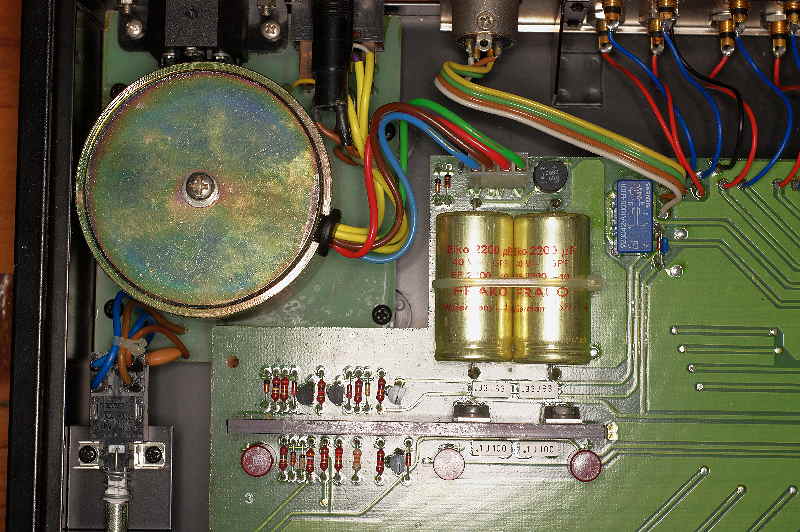

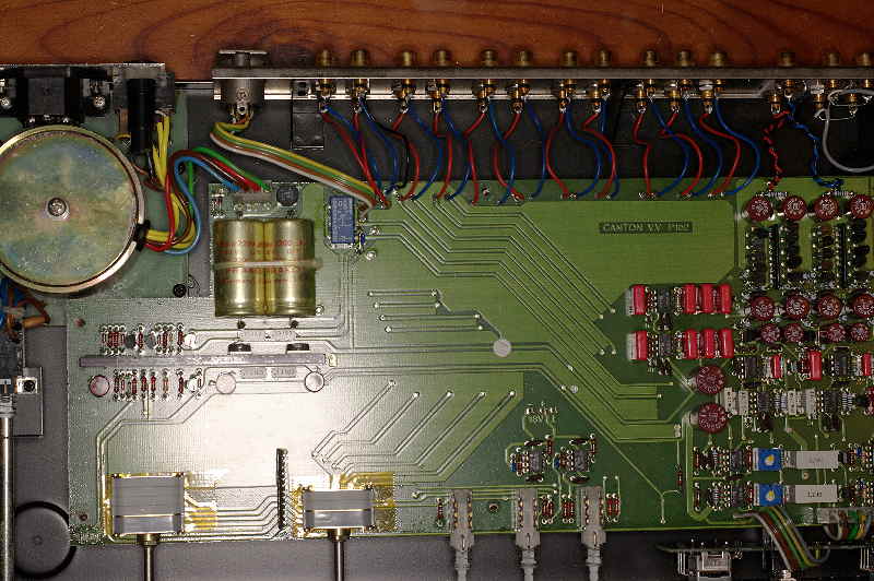

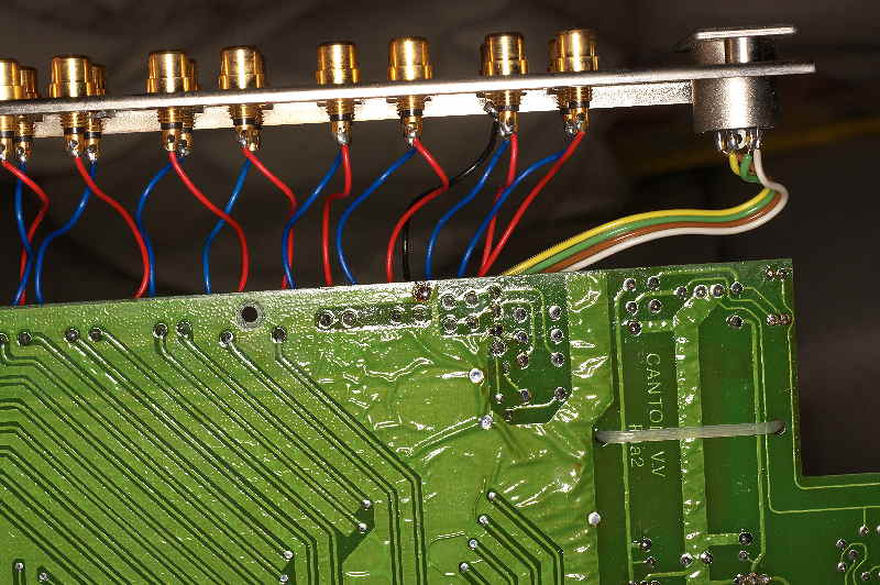

After I opend up the preamp I found two things: firstly, the rca connectors are mounted on their own massive metal board and connected via wires to the main pcb. That rules out a broken solder joint, which was my first assumption. The second dicovery was, that somebody had already exchanged the voltage regulators (7818 and 7918) in the past, applying only limited soldering skills.
Unfortunately I cannot find and service manual or pcb layout anywhere for this preamp, not for the identical MBL 4005 and my own electronic skills are limited.
I did some preliminary measurements and found the following results:
- the DC +18V and -18V seem okay (actually I get around +/-17.5V on my multimeter)
- the hot center pins of the preamp outputs have no resistance, measured against ground. With other words, both connectors, the shield and the center pin are connected to ground.
I don't think that is the way it should be or am I mistaken?
Assuming, that the center pin of the output sockets should not be connected to ground, where should I go on with my search for faults?
I would be very thankful for any help, as this is a very good preamp and buying something in the same league is out of my reach currently.

You say the centre pins measure zero resistance to ground , does this alter when the volume control is moved . Have you checked the board fully for poorly soldered joints . Does giving the preamp a sharp knock bring it back to life.
can you take a foto of the inside.......to have an overview?
foto vom innenleben,mit den ausgangsbuchsen,um eine übersicht zu bekommen.

Thank you so much for your responses! I try to answer the questions first:

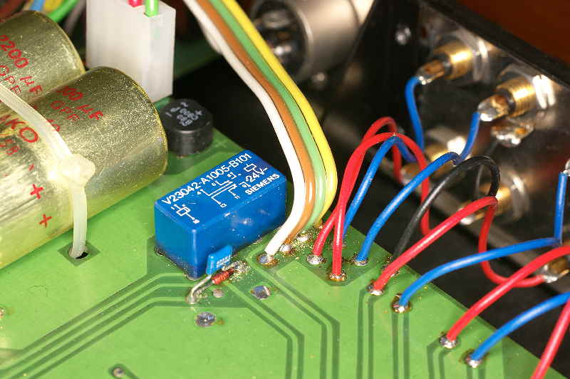

Jürgen: yes, there is an old Siemens mute relay (Siemens V23042-A1005-B101 - 24V) in the output signal path, right in front of the output connectors. I already thought that relay to be suspicious (or perhaps a zener diode adjacent to the relay?)
This relais type seems to be out of production and I only found a Siemens V23042-A2305-B101 so far, but am unsure, whether this could be a replacement or not, the small diagram printed on top certainly looks very much alike.
mjf: I will take images today evening and try to upload them here. I have to read up, how I can do that.
epicyclic: I try the volume control thing and the knocking. Maybe, I should try knocking on the mute relay Jürgen suggested?
The pcb looks good from the top, but the backside looks as whether the layers start to fall apart. It is a fiberglass board, by the way and may be the wrinkles are normal for that kind of pcb?
For measurements I have a multimeter which can also measure diodes and transistors and caps. I also have a nice oscilloscope, but am only starting to learn how to use it. I feel red in my face, when I have to admit, that I only start to understand electronics and the lack of a circuit diagram makes things even worse for me...

If the canton has ouput muting then you could easily see zero resistance to earth on the hots when the power is off . If you still see it with the power on this could point to the muting not coming off , maybe the relay or the driving circuitry at fault .

Hi epicyclic
You are seemingly pointing into the right direction. I switched on the preamp and heared a loud click from the relay. Then the measurements showed, that the center connectors of the output were lifted from ground - no short anymore.
That happened only once. I switched off the amp, connected a source and a headphone, switched on again, but the relay did not do anything. Accordingly the outputs were grounded and I got no signal. Several repetitive on/off cycles did not move the relay anymore to come back to work.
So, yes it is either the relay itself (which is bad, as I found only one source for that old model and they command a premium of more than 70 Euros for the relay) or it is the driving circuit - whatever this is.
I also made some images of the pcb, which I will try to upload now.

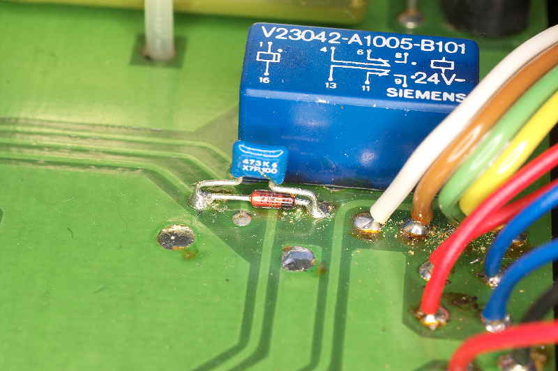

The diode and capacitor combo , just to the right of the relay , are directly across the relay coil . With the power on CAREFULLY measure for a voltage across this combo . If you see a good voltage turn the power off ,let the power drain away , then see if you can measure the resistance of the relay coil across the combo ...red lead to black band of diode .......... otherwise you could just see the diode junction .

To be clear........so we both understand .
Measure the voltage across the diode capacitor combo...Red lead of your meter to black band of diode Black lead of meter to the other end of the diode . If you see a good voltage some where near 24V turn the power off ,as before , then measure the resistance across the diode combo RED lead of your meter to black band of diode BLACK lead of your meter to the other end of the diode . You should be able to see the resistance of the relay coil .

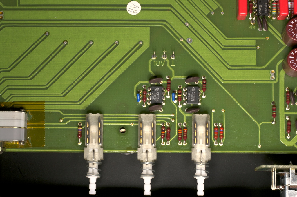

I cant be sure where you mean about the 18V point as the photo hasnt enough definition and the flash is being reflected .

Would you take photo 2 again ( close up of power supply area ) but with the camera slightly angled to avoid flash reflection, also an underside view of the same and one of the 18V binding post area you mention . Apologies for 2 posts , i came up against the 10 oclock diyaudio maintenance shut down .

Good evening epicyclic
Here are my results:
1. voltage across diode 21.75V. Measured as prescribed.
2. Resistance across the diode with pre switched off is 2.3 kOhms
And I also attach better pics. As you can see, those 18V marked binding posts are positioned on the front side of the mainboard, just in front of the selector switches. I also hope the area around the power supply and the relay assembly is now clearer to see. I processed the images better this time, which should yield sharper results, also.
Ben
Hi
You measured 21.75V and the relay wasnt operating ( clicking ) ?
Tried to confirm if 2.3K ohms is the specified resistance of this relay but couldnt find any information ,this seems a little high to me.
With the power on try tapping the relay with a plastic toothbrush handle to see if you can make it operate ( click ).
It does look like the relay is the problem provided it wasnt operating when you measured 21.75V .
Believe the 18V pillars should be measured individually with respect to the pillar on the right ( _L ) , closest i could type it .

Yes, the reading of 21.75V was taken with the dead relay. I also couldn't find any info on the relay and am looking to find an alternative part. I simply do not want to pay more than 70 Euros for a NOS part (V23042A1005B - V23042-A1005-B101... von Dönberg). I found a "Takamisawa RY24W-K", which I think, should be fine. (I have attached a short data sheet here).
I tapped the relay as hard as I could without doing damage to the pcb, but it wouldn't do anything.

Hi Mind
Whilst looking closer at the relay i find i cant trace the contacts to the output circuitry . Can you confirm that the RCAs right next to the relay are the output RCAs because they only appear to link to the XLR . What does the XLR connect ?

Without hands on i cant fully commit to it being a faulty relay . If it is not the relay then its the driving transistor only partially switching on . You are certainly getting a voltage across the relay , provided it is the full voltage without any resistive element .
Should you choose to change the relay the Siemens V23042 A2305 B101 might be a suitable replacement ( as you previously posted ). It also is 24V......but the voltage is the only data i could find ...i could not find the resistance . www.m-ware.de stock .
Without a schematic it gets very difficult to decipher the circuitry.

The two sets of RCAs are indeed the output connectors. The XLR is also a preamp out, symmetrical I would think. I never used it, as I use my old Onkyo M505 with the pre and the Onkyo offers only RCA inputs.
