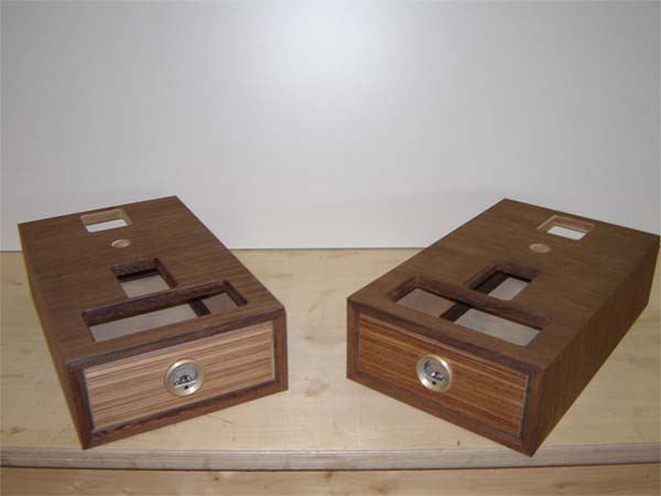

progress photo
Because i ask a lot of questions i want ot show you all what i'm building. It has taken over a year to build the housing of my 300B power amp ans now it is in the final stage. Next stop is finish and solder the parts in.
After that I will start building the pre-amp. I'm still putting ideas together. It must be a mix of the looks of the power-amp, the sicties ( thinking of some plexiglass top ) and aluminium. Butt i like it to hear from other people as well what there ideas are. I'm thinking of volume knobs, feet, chassis looks anythink is welkom.
the photo of the power amp is shown below the holes on top will filled with a RVS plate. That's where the tubes will be mounted. the smaller round holes on the back are for mounting the transformers.
Comment is welkom!
