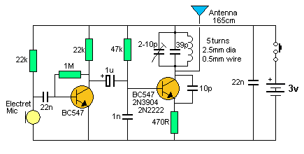

Use a voltage source of between 3Volts and 12Volts. Feed the Mic with it through a 22K resistor. Feed that to the base of a small signal transistor, (BC109 etc) with a 10K Collector load. AC couple the collector with say 10uF and that is all you need.
Thanks. Is it really that simple and will it boost it by at least 30db? I just wonder why anyone would use a far more complicated op-amp circuit, like the one shown on the e-bay page, if that's all that's needed.
What output level would I have with that, something suitable for my PC's line input or only for the mic input? If the latter, I can always give it a try and do something else if I still find it too noisy I guess.
The electret mic needs to be capacitively coupled, and the transistor to use a self biased stage which is a 1meg resistor between base and collector.
Shown here on the left of the image, clarifies how it is connected using a 3 v supply.

Yes that is all that is needed as the PC/laptop has a gain control. Just ignore the second transistor and use the USB supply for your power.
