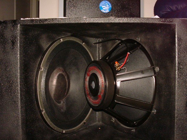

Hello, my 1st post here! I have a few Q's about DJK's PPSL design for the Kappa Pro 15LF, hoping that he or someone who built it can chime in. I'm having 4 of them built for live sound, trying to make them as compact as possible.
1.) Based upon DJK's cut sheet, I calculated the NET volume to be 6.172 ft^3. Is that about right, or am I missing something?
2.) Assuming that the Sv is 54.375 in^2 with a brace down the center, a Keele equation gives an Lv of less than 13.5" for a 35Hz tuning (the driver's published Fs). Is there a particular reason why the Lv is 16.75"? Does splitting the vent with a brace make so much difference? Or, perhaps is the measured Fs of this driver lower than the published result?
3.) Is there any harm in building a smaller plenum? I'm thinking 16" square by 7.5" wide, internal. I can barely get my stubby digits around the back of the frame. Will that put too much pressure on the driver cone?
The concept of this design is appealing, like semi-horn loading with the LF extension of a vent. Thanks for any input!

In response to #2 - is there any particular reason that the cabinet should be tuned to the driver's Fs?
I guess I think of the design for this driver as a PA subsystem. I suppose it should be reposted. One of DJK's guidelines in his old Speakerplans postings for a PPSL is tuning to the driver's Fs. I'm just curious about why his design for the 15LF seems to be tuned below the Fs. For any pro audio subwoofer, isn't that just added excursion?
The published plan for the dual 15 PPSL is based on the Kappa Pro 15LF-2.
http://www.eminence.com/pdf/Kappa_Pro_15LF2.pdf
"is there any particular reason that the cabinet should be tuned to the driver's Fs?"
As we see, the Fs=35hz. It is a perfect candidate for a B6 design. If the Qts were higher or lower the design would become a C6 with some ripple in the response.
A Qts=0.312 gives the perfect balance between efficiency, box size, and LF response. The PPSL is an SBB4 design (best transient response of all the vented alignments) with a high-pass filter with a Q=2 applied to make it a classic B6. Drivers with higher or lower Qts will work (with some re-design), and it will become a C6 with some ripple in the response.
A 2 cu ft 2nd order sealed box with an F3 of 30hz can only be 0.18% efficient (84.55dB).
A 2 cu ft 4th order vented box with an F3 of 30hz can only be 0.36% efficient (87.56dB).
A 2 cu ft 6th order vented box with an F3 of 30hz can only be 0.90% efficient (91.54dB).
(after Keele)
" Does splitting the vent with a brace make so much difference? "
The dimensions were generated by BassBox Pro v6.0 based on the actual size used in the box. Changing the aspect ratio, or going round, gives different dimensions.
"Is there any harm in building a smaller plenum?"
My original prototype boxes had the plenum 16.5" by only 5" wide, this required a removeable panel for access to mount the drivers. The outside dimensions were 36W x18H x 30D, and tuned to 34hz. In a good sized room in a home they measured flat to 31hz without the EQ of the filter they were designed for (room gain). For PA in a large room you will need to use the proper filter (most crossovers or equalizers have filters that can be modified with just two resistors).

Thanks for jumping in, DJK!
Right, I own 8 of the Kappa Pro 15LF-2 drivers. We use a DriveRack PA (I know, not the best) for processing; the subs are high-passed at 35Hz, tho' we're not doing the B6 alignment. (Is B6 a subwoofer vitamin? Sorry, couldn't resist.)
I rearranged the layout so that the vent is under the plenum with the same internal width of 7.5", so the vent is a single rectangular aperture of 7.5" x 7.25" without any divisor. This gives a taller box & fewer panel cuts. Both Keele & a very old LEAP program give an Lv of about 13.3" for a 35Hz tuning, unless I miscalculated the net volume. Internal dimensions are 24"H x 28"W x 21"D. As we're using 5' square 13-ply Baltic Birch panels, I wanted to limit the width to 29.5" exterior.
I'm surprised that there aren't more live sound DIY'ers building PPSL's for their systems. The benefits easily outweigh the added size & effort to build. Plus, they look cool!

In my active vented designs in BB6 Pro, I was aiming for an f3 of 28-29Hz (f3 of my TH18s is 36-37Hz, I believe). 22.5 x 40-45 x 28-30" external were dimension ranges.
A Qts of 0.312 might be optimal, but it isn't critical to get good bass from a PPSL. A slightly higher or lower Q just means a larger or smaller box. Perhaps you could establish an acceptable deviance from the ideal Q in order to allow yourself more driver options? For instance, I was also considering the Kappalite 3012LF, instead of using a 15" driver.
Right, I was still including drivers within a few qts points (.26-ish - .36-ish). I was mainly looking at 18" drivers, but I might want to look at 15" drivers due to the large port size increasing box volume quite a bit.
