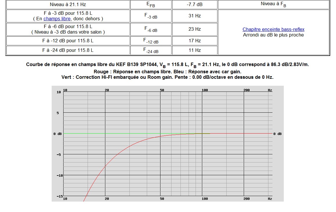

KEF B139 SP1044, VB = 115.8 L, FB = 21.1 Hz with F3=31Hz/23Hz in room.
Max. SPL Distance from speakers/1.00 m
1 speaker 2 speakers 3 speakers 4 speakers 5 speakers
107.0 dB 110.0 dB 111.7 dB 113.0 dB 114.0 dB
